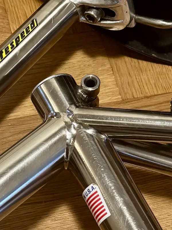

So, the plan changed: I decided to sell the frame and reuse all the components, wheels, and fork on another smaller ’92 Litespeed I had sitting around. The large frame went off to Italy, and through a trade with a fellow collector in Austria I swapped my fork with the long steerer for his with a shorter one. We then went a step further and exchanged my matte-blasted frame for his polished frame of the right size. Phew!
In the end, I’ve basically ended up with a similar frameset as I started with—but this time in a size that fits me better. I actually prefer the neon decals on this one too, so that’s a bonus. The fork decals are a bit faded, so I might turn to SSSINK for fresh ones later on.

  • It’s from an earlier production run 4130 vs 5xxx, with downtube routing for the rear derailleur cable.
  • It has no separate seatpost collar but instead an integrated seatpost binder bolt.
  • Earlier generation stem with the smaller diameter stem

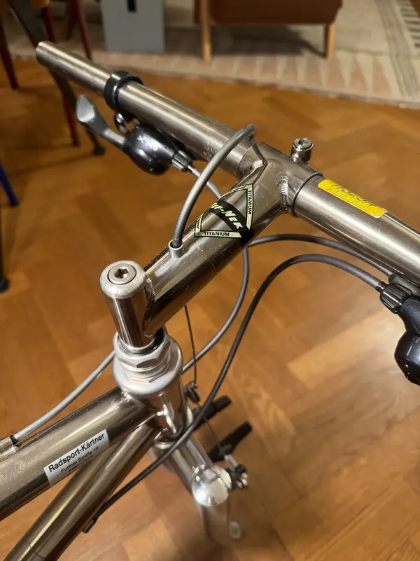

Continued with mounting the XTR M900 headset . I hadn’t noticed before that the crown race actually has a retaining ring in a groove, nice detail!
Unior tools really are great for this kind of work.
Pressed in the headset races and the crown race. The steerer is slightly too long, but I don’t want to cut it, so I’m using a few spacers for now.
To get a bit more room for the handlebar to slide in, I sometimes put a coin in the split and tighten the bolt slightly to open it up a bit more.

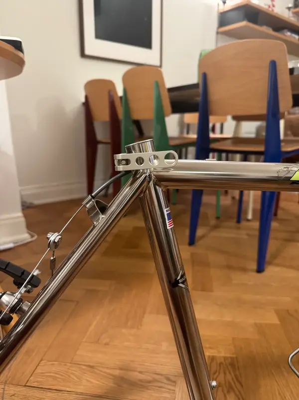

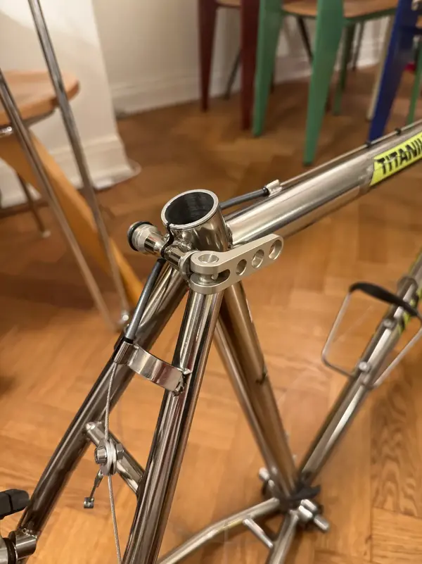

New frame has an integrated seatpost binder, and I’m not sure what a period-correct binder bolt would look like...
I did find a silver QR in my parts box that fits quite nicely though.

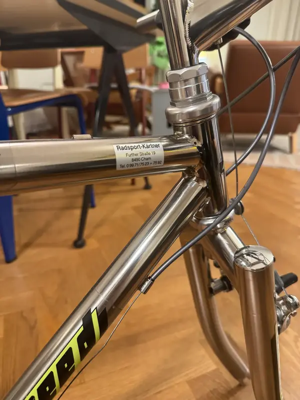

And yes — I’m keeping the dealer sticker!

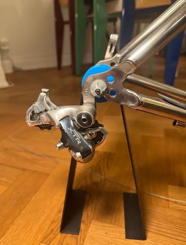

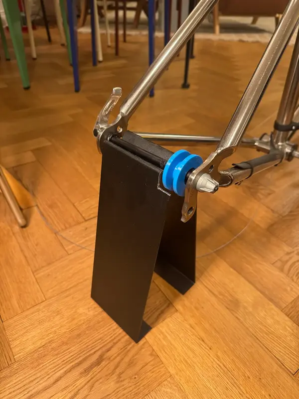

I’m really tight on space, so I made these stands to store the frames without wheels — they lift them up just enough to clear the chainrings and rear derailleur. Works quite well actually.

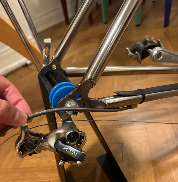

The rear derailleur outer gear cable from the last build is unfortunately a bit too short...
So now I’m on the hunt for some XTR M900 gear cable outers.
Let me know if you have any spares!
