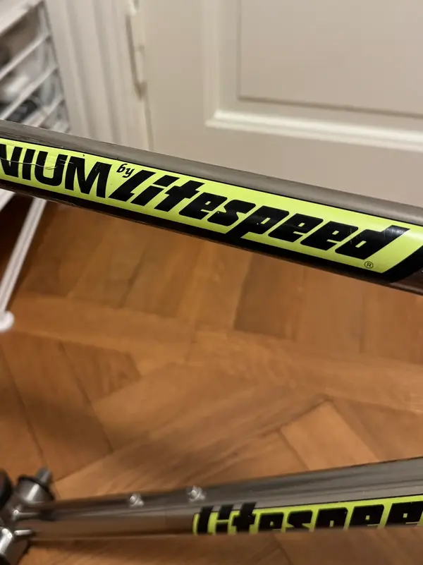

So, the plan changed: I decided to sell the frame and reuse all the components, wheels, and fork on another smaller ’92 Litespeed I had sitting around. The large frame went off to Italy, and through a trade with a fellow collector in Austria I swapped my fork with the long steerer for his with a shorter one. We then went a step further and exchanged my matte-blasted frame for his polished frame of the right size. Phew!
In the end, I’ve basically ended up with a similar frameset as I started with—but this time in a size that fits me better. I actually prefer the neon decals on this one too, so that’s a bonus. The fork decals are a bit faded, so I might turn to SSSINK for fresh ones later on.
The trade also brought in a stem with the diamond logo decal, which I like more than the previous Litespeed one.

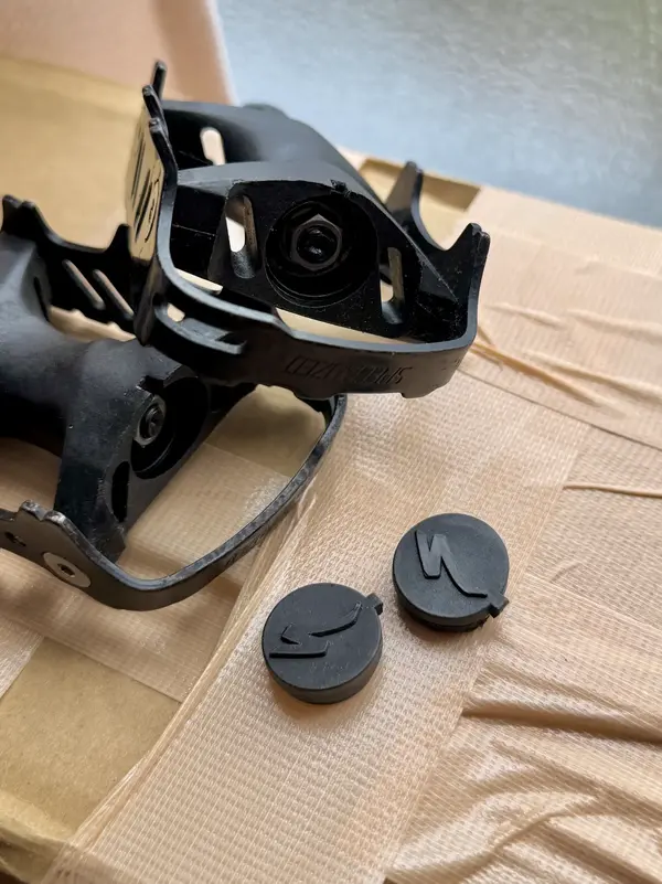

One of the pedals was missing a dust cap, but luckily a lower-spec version uses the same type. I found a used pair with decent caps — so the pedals are now complete again.

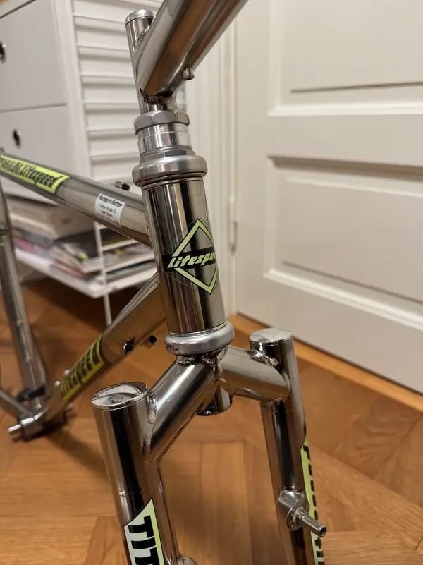

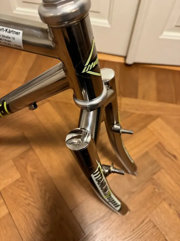

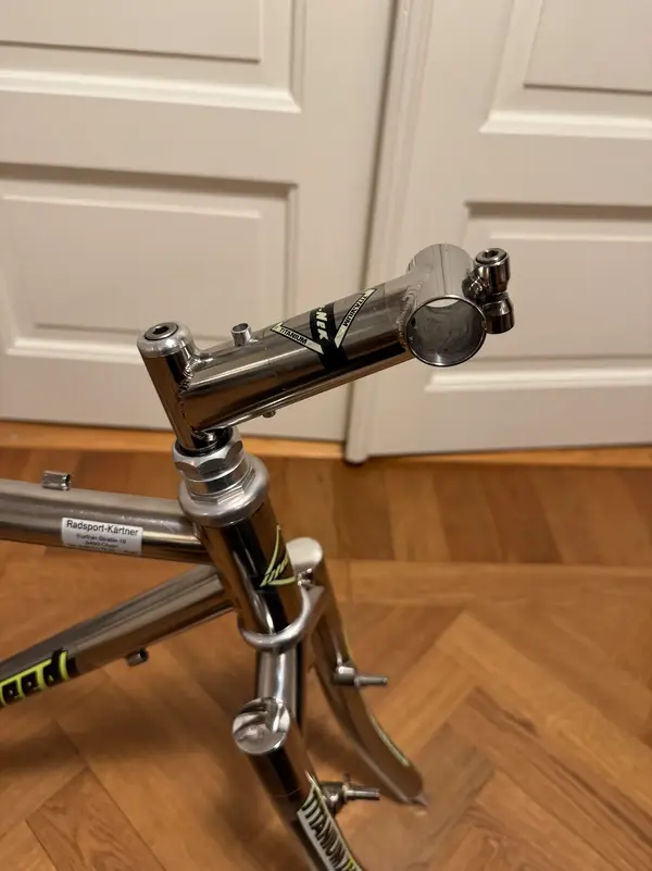

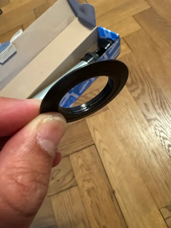

Continued with mounting the XTR M900 headset . I hadn’t noticed before that the crown race actually has a retaining ring in a groove, nice detail!
Unior tools really are great for this kind of work.

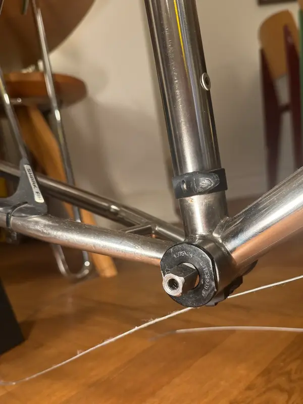

Pressed in the headset races and the crown race. The steerer is slightly too long, but I don’t want to cut it, so I’m using a few spacers for now.

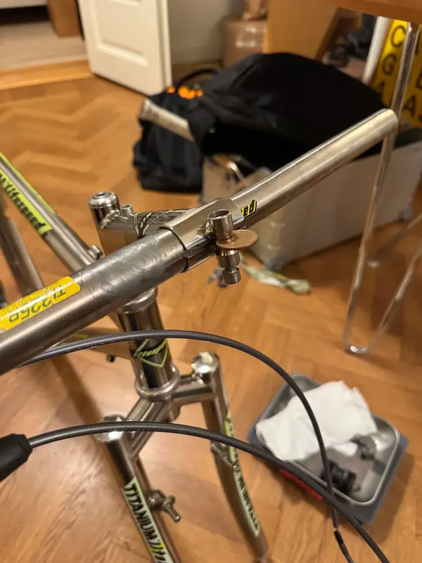

To get a bit more room for the handlebar to slide in, I sometimes put a coin in the split and tighten the bolt slightly to open it up a bit more.

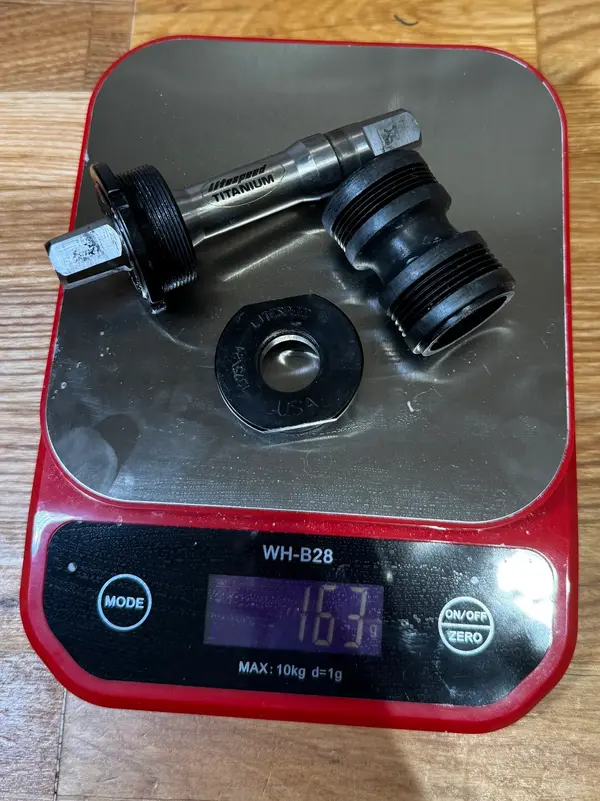

Also mounted the bottom bracket, which weighs in at 163g.
