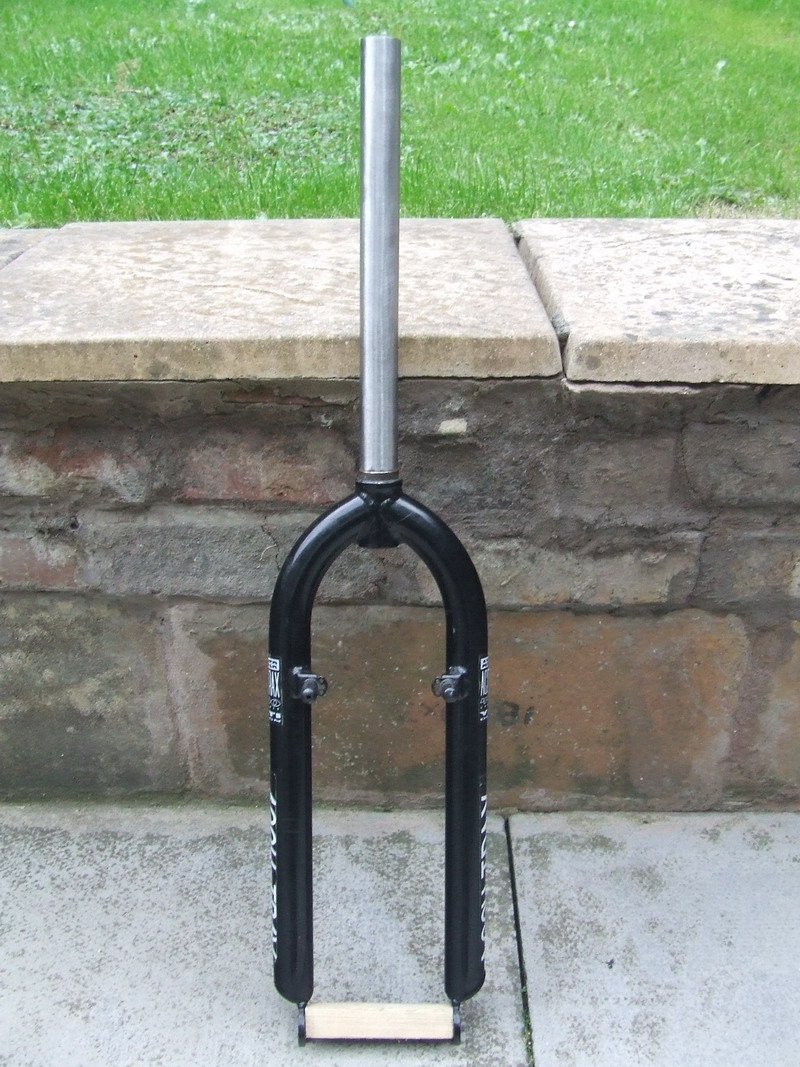

it's getting hold of a set with super-long steerer! :?
Where there's a will there's a way....:wink:
This long? (not for sale btw..)

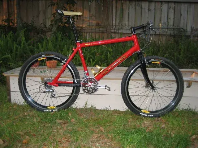

I had a 410mm Kona P2 on my Beast to start, and it looked funny and felt awful. In my opinion, the Pepperoni is the way to go.
I like the white. 8)

They look at home don't they? 8)
