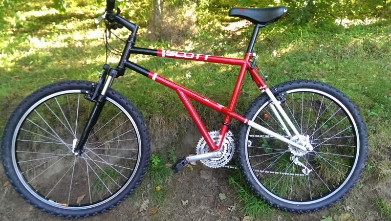

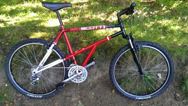

Anyway, pics...
I'd resprayed the bars, stem,seatpost & forks myself with a rattlcan of black paint and some clear laquer, seems to have come up a treat :)

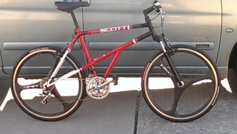

And what it looks like with Spin wheels & slicks.... 8)

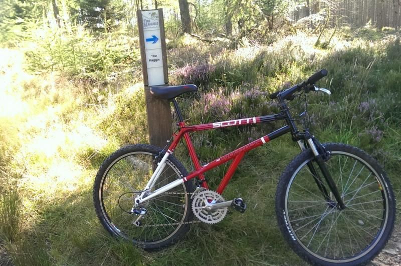

Tried some 1.8 Charge Splashbacks on for size today, look good (more in keeping with the venerable age of the bike), and ride pretty well too as they grip well in the corners.
I did more or less the same route as my last ride on this bike, and can you believe it... out of 15 Strava segments I set 7 PR's today :shock: beating previous PR's set aboard my modern bike (and I'm guessing that most of the others on the Strava segment leaderboards were riding more modern bikes too?).
I doesn't seem to make sense :? , but I think I put more effort in when riding the Scott, it's quite rewarding to ride it on the ragged edge, and is easily doable even for me, whereas on my modern full-sus bike I'd have to be going a LOT faster to truly be on the edge with it, and I'd run out of talent before the bike did :lol:
The Scott is getting some Schwalbe Marathon tyres for the short commute to work, and for some road miles since I've recently sold my road bike. But I'll definately be getting out on it off-road a few times a month at least :D

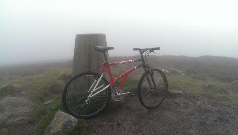

Definitely a bit ghostly out on the hills today.... :shock:

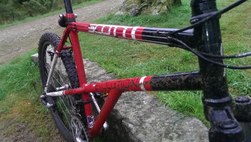

And muddy...
Another good ride, this time on much rougher terrain, and this is where the shortfalls of 40mm travel up front and zero travel at the rear become apparent.
Still, had a good ride, comedy moment was when I cycled past two bikers stoodby the side of the trail, both looked, then did a double take like "WTF is he riding?!". :lol:
