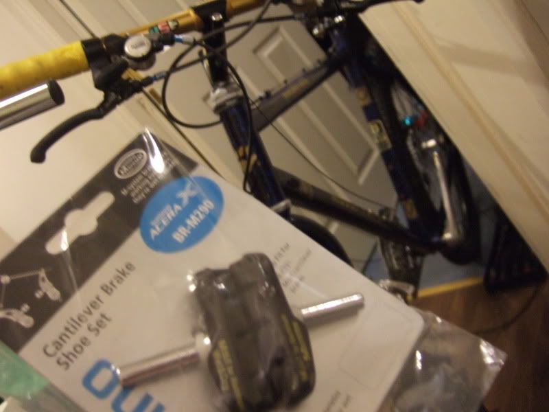

1. Cantis with old pads are poop and not confidence inspiring :shock: - solution coming :wink:

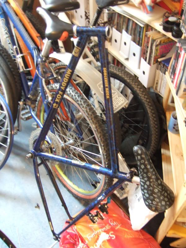

Part 4: FINISHED 8) 8) 8)
Well since my last update and taking the Raleigh to the peaks, I've been spending monies and collecting. Seems its never over. I'm now waiting for a choice of two front mechs, so were (97%) FINISHED
With two sets of wheels now on standby I still ended up the Donor raleighs retro wheels
I tried these Onza Half fats, but dubious colour and mammoth weight. not right for this bike...
Of course I was well prepared, still cleaning and stuff to do but here's how it was this aft
I'd pulled out the Avenger headset and put in a Ritchey logic NOS from a RB member. :) it wasn't going in whith teh tools i had to hand so new hammer about 3.30 this arvo from Hellfrauds! :wink: got it in and destroyed a wire brush handle!

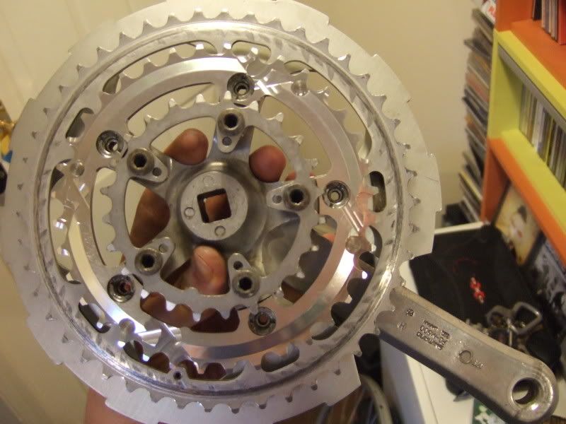

I had bought a small middle ring from jez off here but decided to go new, 36 and silver in the end.
isn't it awsome! race face 36T
Only later I realised i mounted the rings in the wrong place, job for another day

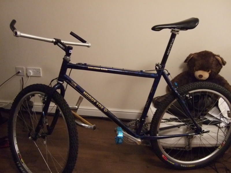

after a late tea i as making good progress, on with the brakes
and finished!! wowsers, lovin' it
7 speed cogs in teh end. :)
ouch!

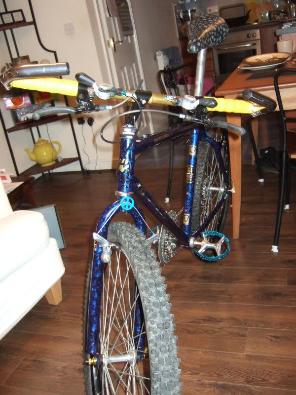

and there ya go, i went for a ride well stoked to know that it was a bare frame this afternoon. i think i need a longer lower stem so the zoom will go on for a while and see how that works... oh and teh seats not comfay but looks retro as! :D

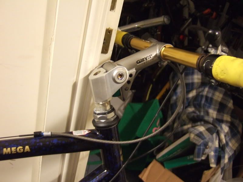

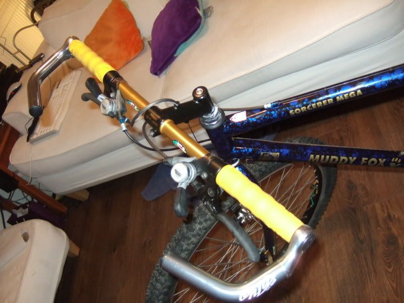

The stem is a bit short so it was either the Zoom stem or the flex stem,

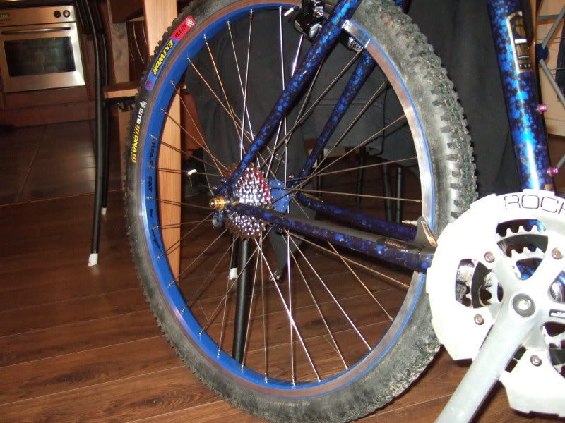

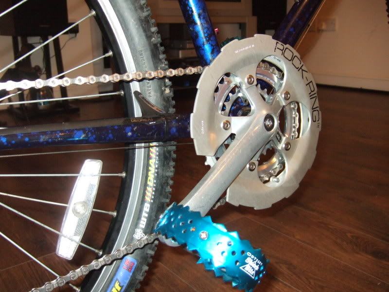

the rock ring came off as I got a new front mech, and it didnt seem to work with it. :( so took it off.

New modern/midskool? Deore LX front mech on. fits in nicely if a bit new. :)
No bash ring I'd like to see it return but need some new chainring bolts, longer ones... any ideas?
The bolts were giving me trouble tightening up, i got a special spanner for reverse side and chap in shop said grease and tool would do it, it didn't still too tight, to tighten.
this project is turning into a 'for old times sakes' memory lane bike, so as i always wanted one BITD, trying out the flex stem, or 'flexistem' as i used to call em!!

Right finding a stem is getting on me tits! :lol:
I got a Control Tech at about 120mm (125?) with some rise, decided that can go on me Raleigh, and this Syncros item turned up today, its 130 and no rise at all.
going for polished to match my new spangly black Syncros seat post wasn't the best move and defo prefer the feel of the Control Tech, bit shorter and higher.
what say you? any ideas of where i'd get a black Syncros shorter than 125mm and some ride?
EDIT: I'm starting to like the look of the polished stem now, maybe i'll get used to the reach/stance, I might even get good at climbing hills :D
Also I need a front cable holder as my forks steer is too short for the 1.5mm one to fit.
