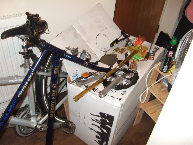

New Spec - Period make over, only a couple hidden shhh modern components now!
Frame: 1991 Muddy Fox Sorcerer Mega Hand built MEGA Cro-mo. Internally and externally butted, ovalised and cuboid tubing sections.
Fork: Muddy fox matching Cro-mo
Headset: Ritchey logic NOS
Stem: Tioga T bone Avenger 130mm with rise
Handlebar: Muddy Fox standard alloy logo bars
Grips: Onza Ules in black
Barends: Nope!
Brakes: Shimano Deore LX M454 in lovely matt black NOS
Brake Pads: Shimano NOS
Brake Cables: Shimano Braided 2mm with matching 6mm outer, ferrules and end caps!
Cantilever cable hangers: Shimano
Brake Levers: Shimano Deore chunky 2 finger polished
Shifters: Deore thumbies
Front Derailleur: Deore LX M550
Rear Derailleur: Deore LX M550 pimped with SRP gold
Derailleur Cables: Shimano
Cassette: Deore LX 7 Speed
Chain: SRAM 870
Cranks: Shimano 500LX M500
Crank Bolts: SRP Alloy (for now)
Chainrings: Shimano originals 500lx on 24, and 46, race face machined 36er
Chainring bolts: SRP Gold alloy
Bottom Bracket: Shimano Deore XT? UN73?
Pedals: Wellgo M20/Gusset Inca/other
Hub Skewers: Halo Porkes in gold
Rims: Mavic 221 Goldy bronzy
Hubs: Shimano LX Paralex
Nipples:
Spokes:
Tyres: Ritchey Megabite or Ritchey Z-Max
Tubes: mixture
Saddle: Ritchey Logic Comp NOS
Seatpost: Syncros Hardcore
Seatpost Binder: original Muddy Fox
Weight: was about 28.5lbs about 29 now I think.
The Boy sold me this T bone, despite starting with a short one I wasn't sure what to do with it, despite being a 130 stretch, the standard back sweep MF bars should give a nice comfy controllable ride...
No bar ends this time, ultimate control on the knarly downhill stuff on this trail bike. Is this better than the
Gold USE bars? I never trusted em 100% and reckon this bike needs the back sweep?
Polished Shimano levers and I had some nicer thumbies in stock so those replaced old set up. All new bars set up
These got the nostalgia going, NOS black Deore LX brakes, these came with silver uns as standard, so a nice feature I thought and nice contrast. 2mm PHAT cables bought off fredgassit? on here, and matched up with 6mm outers ferrules also from RB and caps from my LBS. Nice loving this set up.
NOS Ritchey perch, probably more fitting on this bike than the Flite, fits in with other Ritchey components, looks right, plus I found the new spec Flite very boney on my boney butt! no idea what era it is, guessing correct era...
I thought I had winning pedal ideas for this, both modern but retroesque platforms, it was either Bronze Gusset Slim Jims, or DMR V12s in Chrome and gold pins. Slim Jims were less bling choice. However colour was all wrong!
More Browny Reddy metallic bronze like The Fall Guy truck than yellowy goldy bronze, never mind those can go on my Orange BMX...
Chrome and silver would have been too much so these Wellgos went on that I bought last week for the Orange build. Super svelte at half the weight
They look great with scheme but I am worried about shoe slippage...
Also Note new period correct front mech, the first upgrade I got!
So there ya go. I get to test it and make it mucky as hell tomorrow!!
