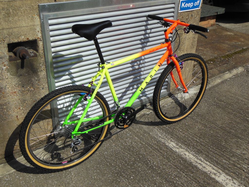

I picked up this bike a few weeks ago from Craig aka chiswickcollectables. I'm sure you're all familiar with it as it also once belonged to Stumpjumper1990.
Pics from sale thread:
I discussed shortly my plans for the bike with Craig and he was excited to hear it, in fact sent me a PM the other day asking when I was going to start work on it. So I figured what the hell since I got some goodies in the mail this week.

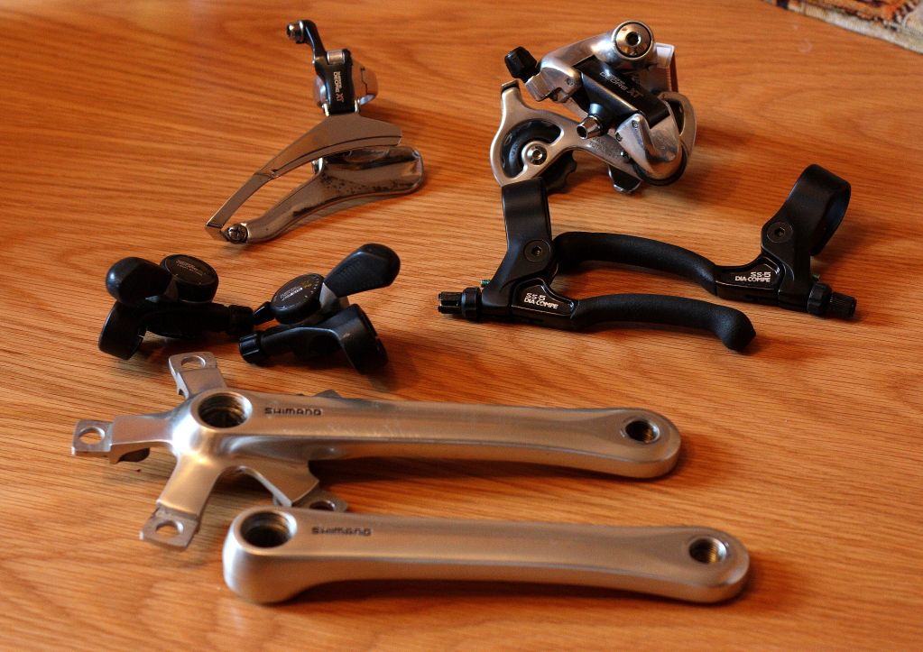

Originally spec'd with Exgae400 components, these are a welcomed site:
XT m735 front mech
XT m735 rear mech, short cage(more on that later...)
XT m730 Crankset
XT m735 Thumbies, excellent shape too
XT m735 flat pedals(love these things)
I plan to use the SS-5 levers I had on the Klein. The Marin came with NOS 987's so I thought these would be a nice compliment.

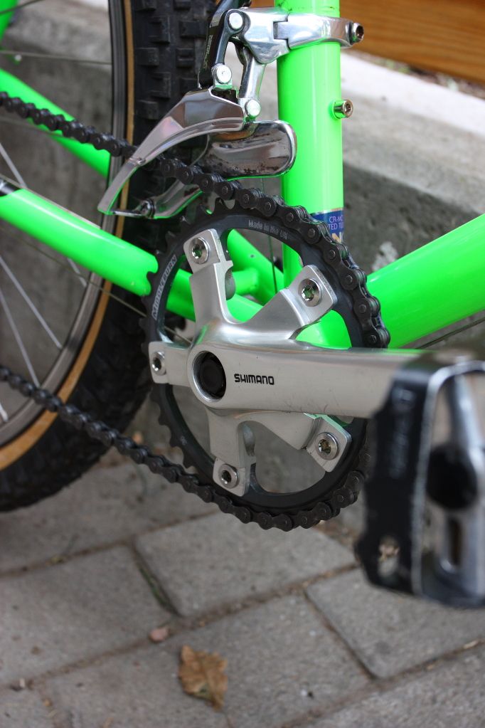

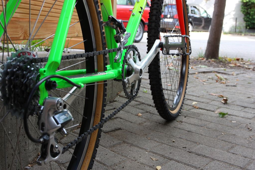

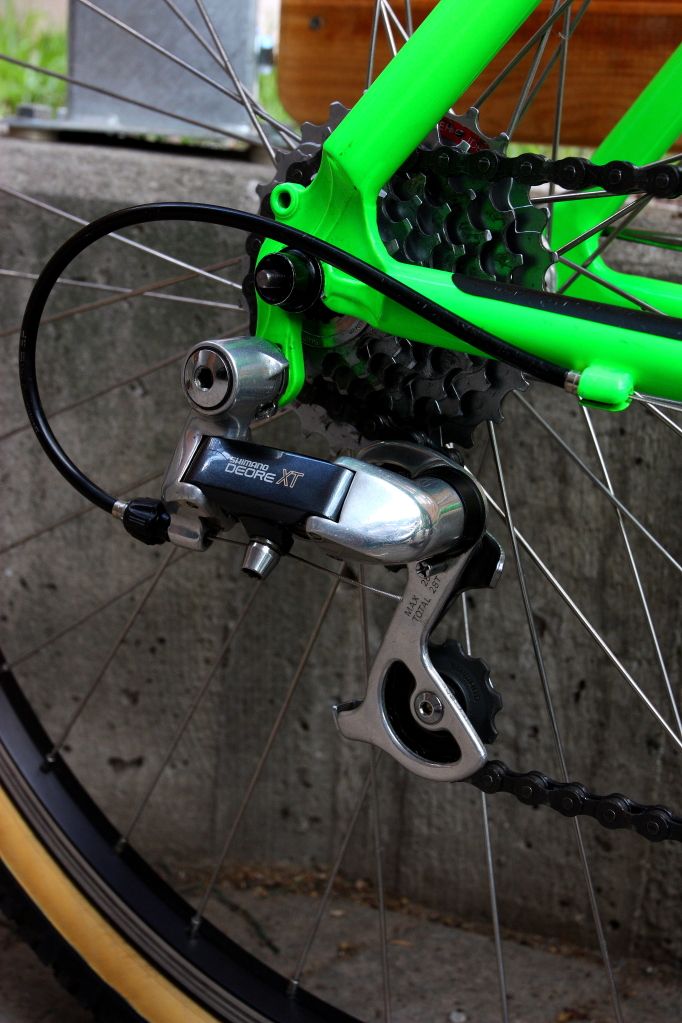

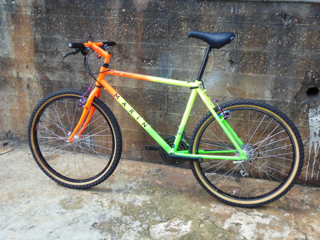

Well, I unexpectedly had some time today to do some work, and managed to get quite a bit done.

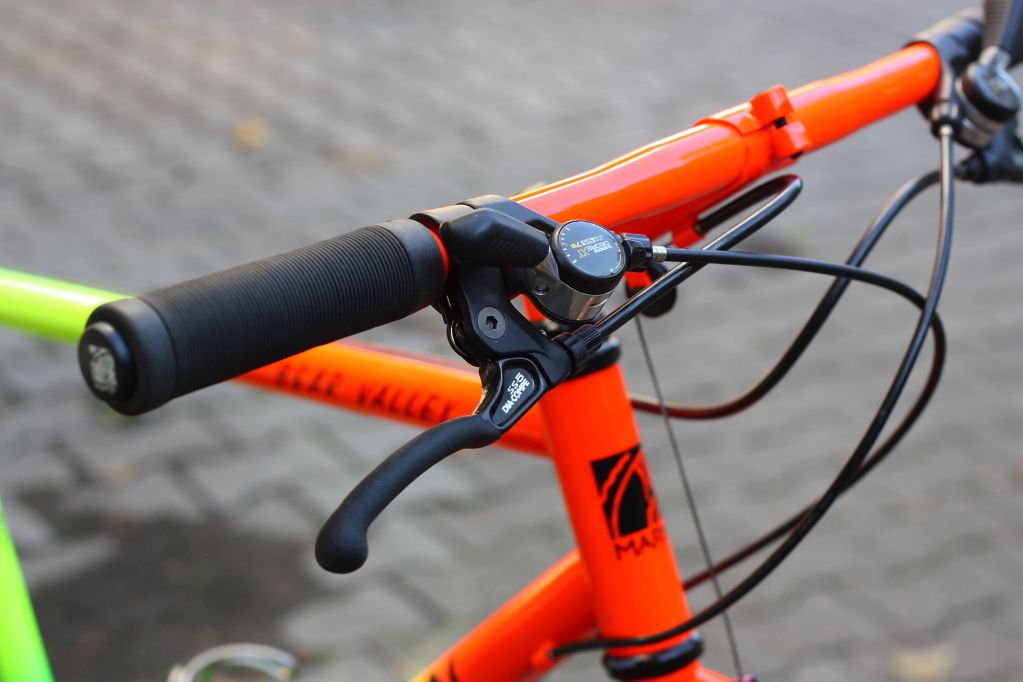

I installed the Thumbies & brake levers, Mechanism's & cranks. Also shortened the chain, installed new shift cables as they were afterwards a hair short for the thumbies. The grips are temporary, expecting a set of Ritchey's in the mail anyday now.
In the process I saved quite a bit of weight....onto the pics first:
And onto the surprising weight savings from today's activities:
EX400 Shifters/brake levers - 290g & 294g= 584g
XT m735 Thumbies 189g(set) + SS5 levers 177g(set)= 366g
Savings of 218g!!!
EX400 rear mech - 320g
XT m735 Short cage - 254g
Savings of 65g

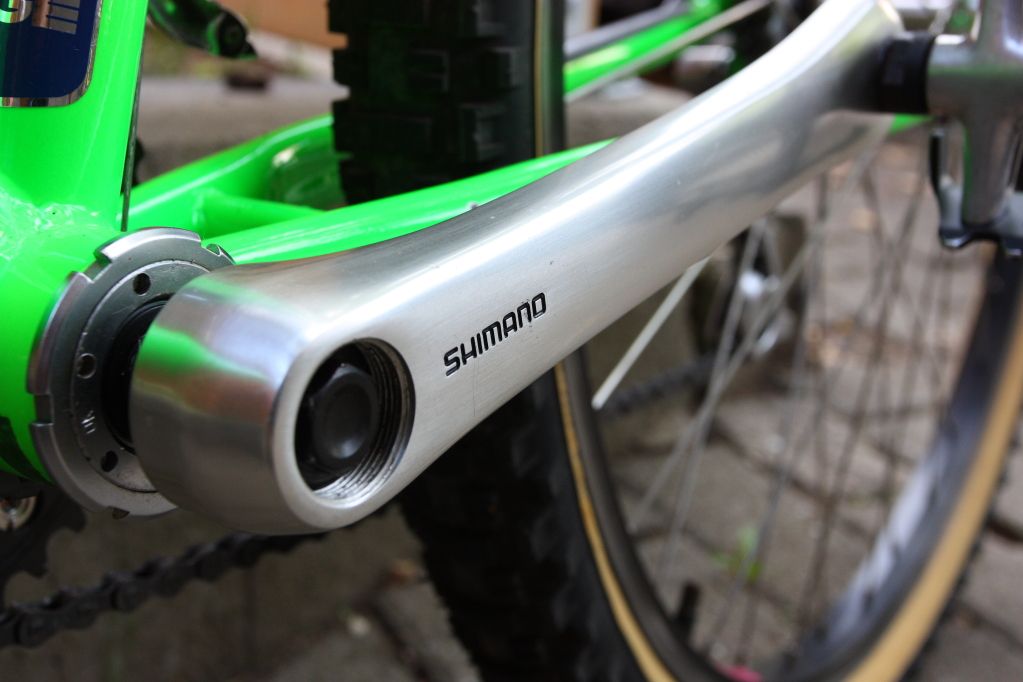

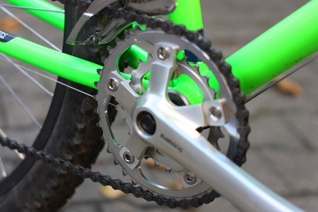

EX400 crankset w/ rings, 28/38/48 BioPace-1003g
Driveside-756g
Non-drive-247g
XT m730 w/o rings-526g PLUS the Middleburn 56g= 582g
Savings of 421g!!!
That 421g plus the other 21g of chain I removed makes for exactly 1lb lost just in the driveline.
(The 5g difference between the front XT & EX400 mech's is negligible.)
So today, it was a total of 730g or 1.607lbs!!! And to date, 1058g or 2.33lbs...Not bad for an afternoon's work And I still have the tires to swap out, which are the last of the easy and cheap weight mods.
While I had the factory Marin bar naked, I threw it on the scale to see that it weighs 300g, rather hefty. My '170g' Ritchey Forcelite weighs 180g, saving an additional 120g, or over 1/4 pound. BUT I love the colored bar & stem so until I find a paintmatch for the orange, and a light quill stem(as the original is probably similarly heavy), I will be leaving the factory parts on.
I am turly impressed with the positive shifting and feel from the thumbshifters, as well the SS5 levers seem to have brought the brakes to life.
The XT m735 short cage rear mech is silent and provides/adds to the solid and smooth shifting feel. A little more tweaking and it'll be perfect.
Til next time.....

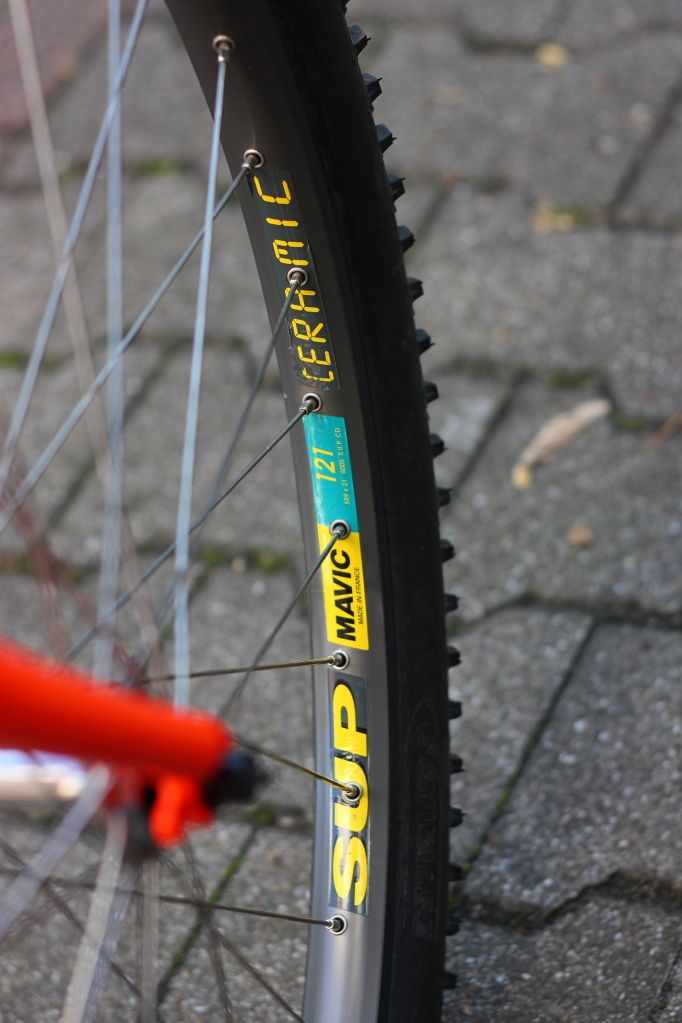

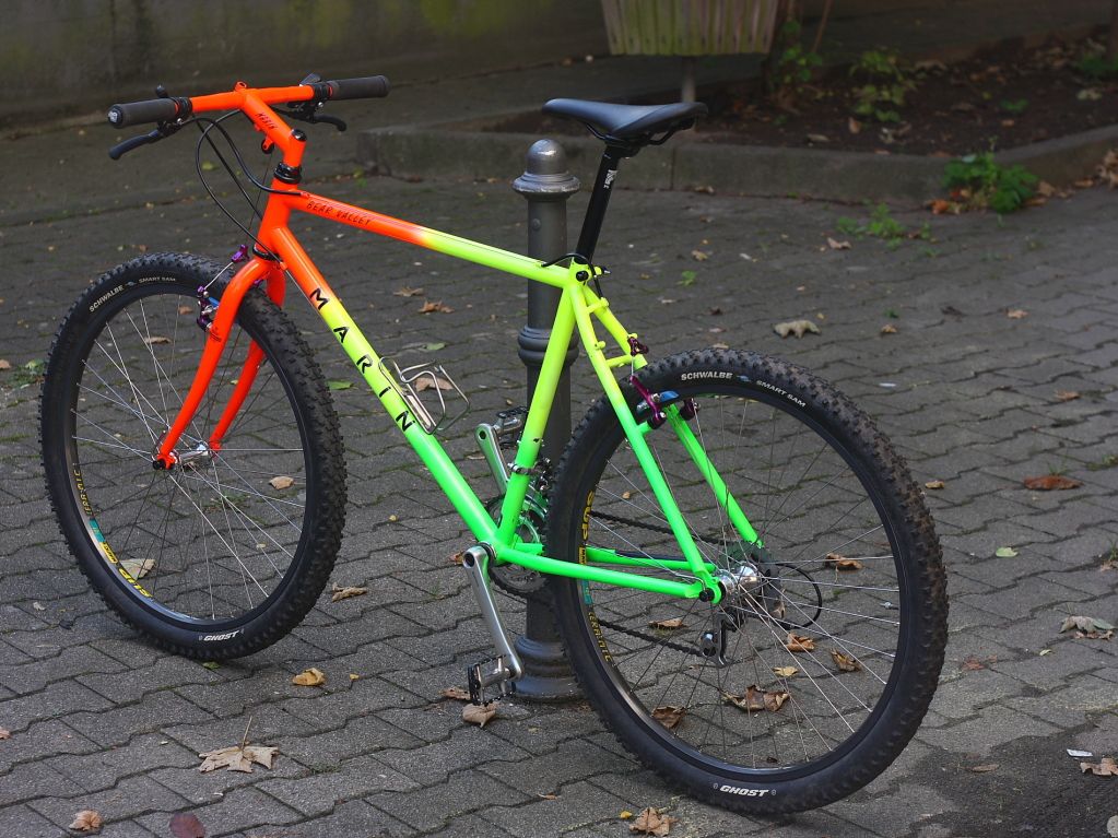

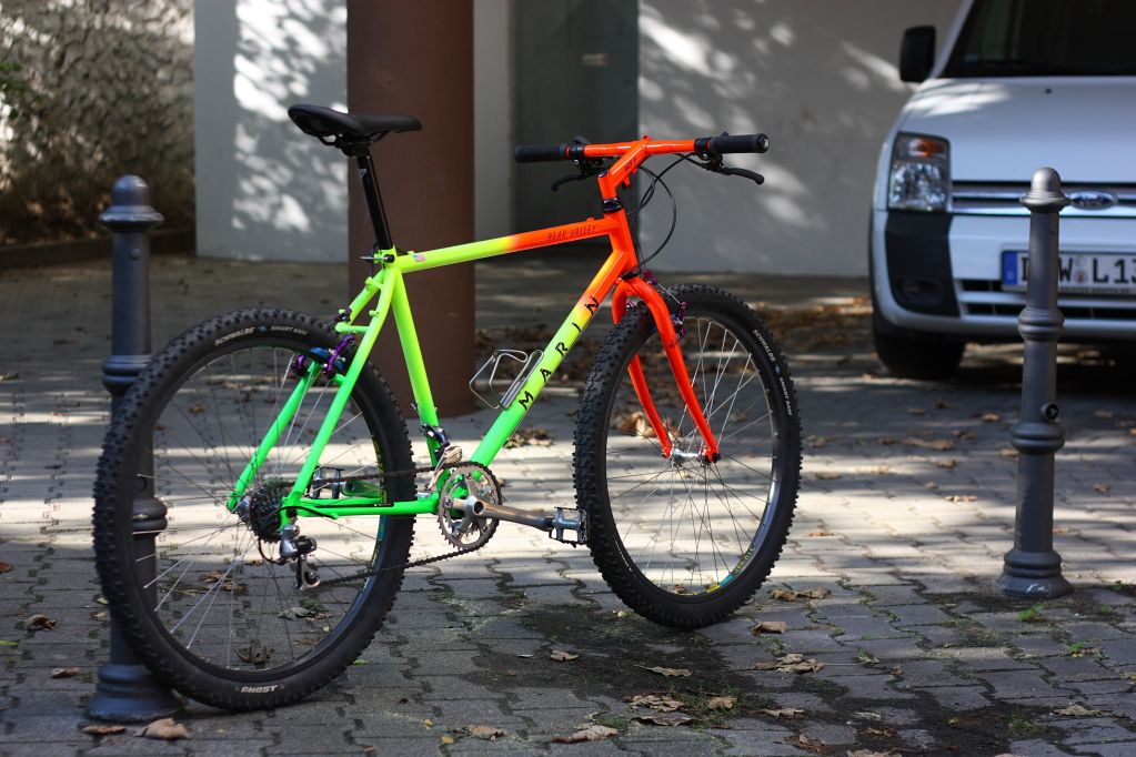

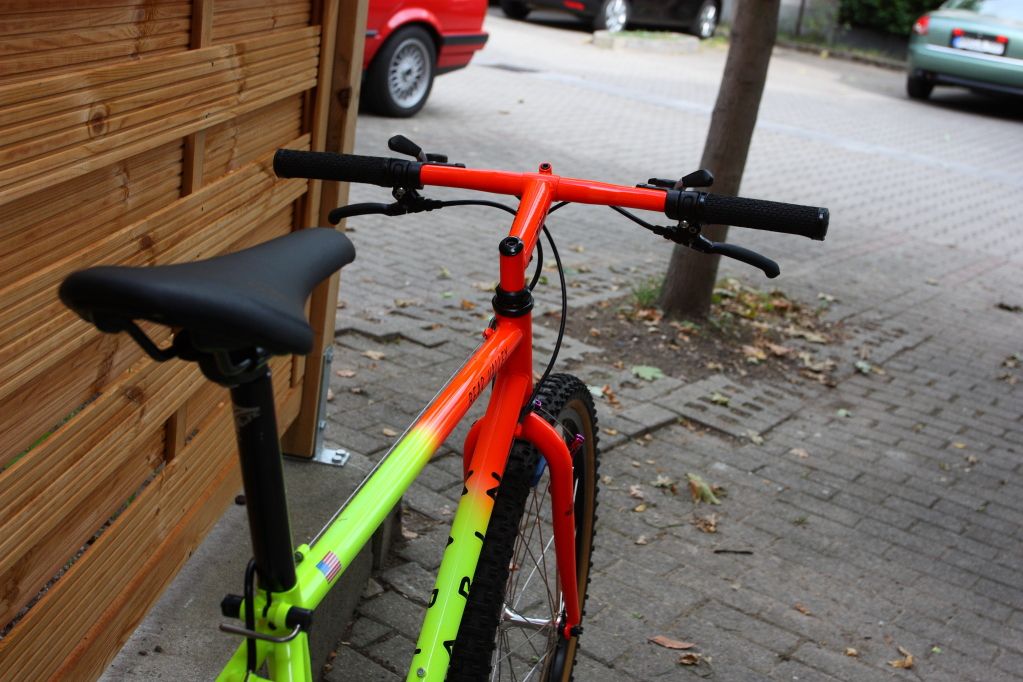

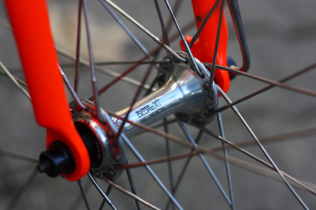

Just a quick update as yesterday I received my Mavic 121 Cermaic/XT 730-732 wheelset. The are almost NOS, hahahaa, in excellent condition. I have already had the old Smart Sam's on there a few weeks as I am tapped out and have no loot for proper rubber.

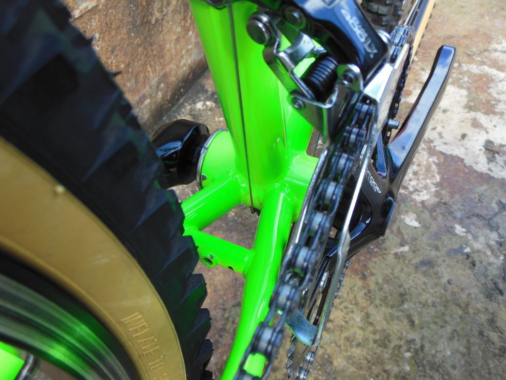

I have also added a Middleburn 26t granny ring with self-made 5mm spacers, and swapped out the 36T Middleburn for a 38t Pace. I was running out of gear too quickly with the last setup.

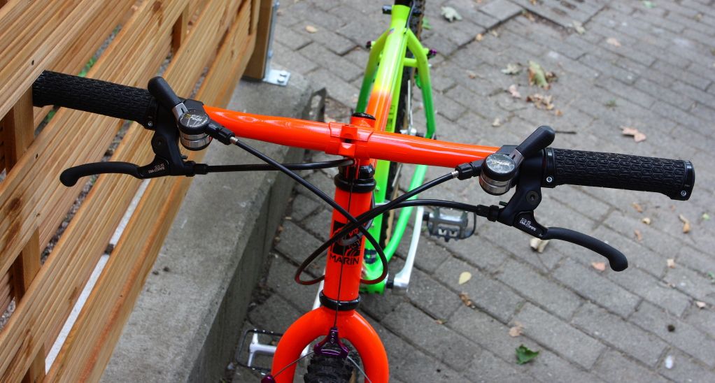

Oh yeah, and ODI grips...
Pics:
Thanks...I got it dirty yesterday but immediately cleaned it :LOL:
I plan to get it even dirtier in the coming week or two, i'll take some pics then.
