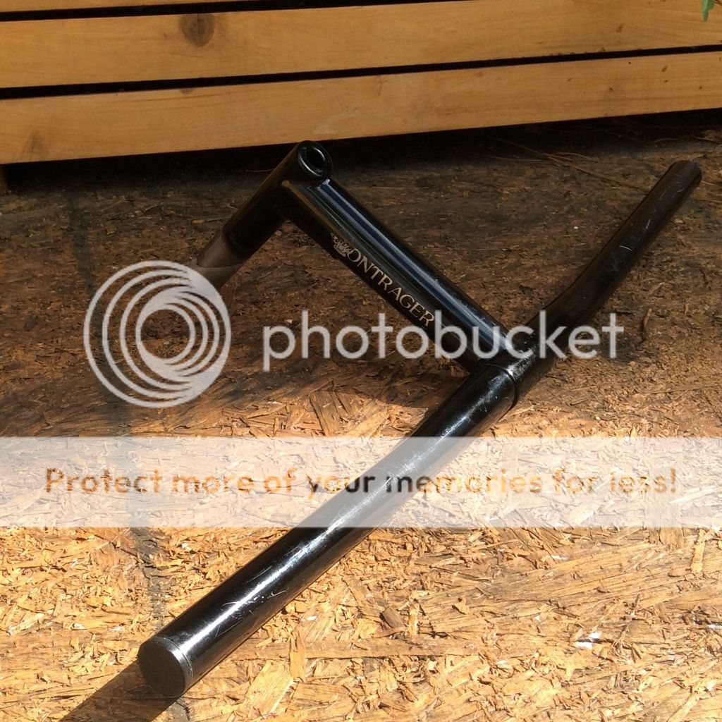

Bontrager Racelite Bar/Stem combo - 380g!
