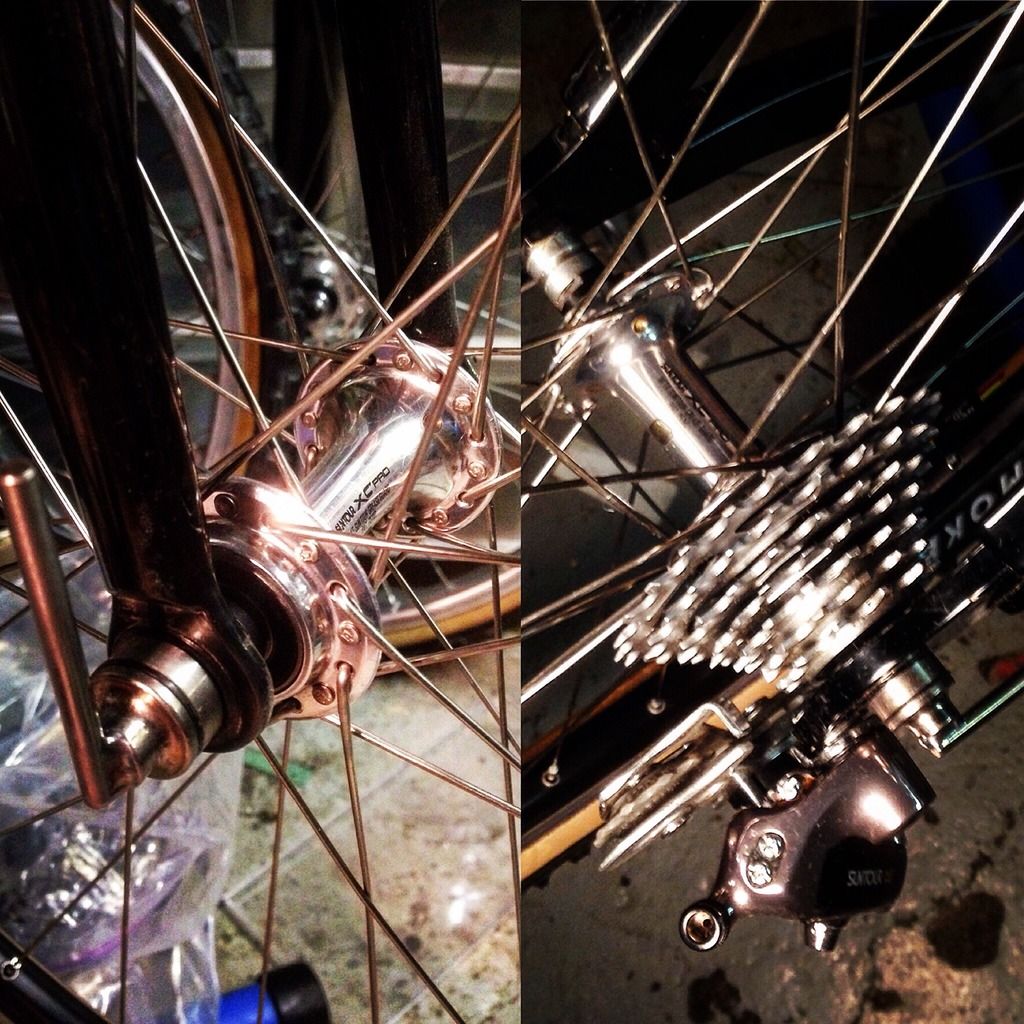

Long wait for these but they are great and light!

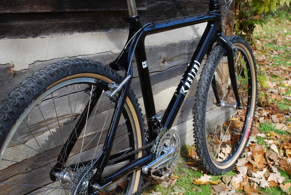

NOS Suntour XC Pro hubs on NOS mavics with DT butted spokes and new NukeProof Skewers. They come in 244g lighter than my already light ringle/mavic wheelset. The bike is flirting with sub 20lbs now. Time to finish it off :D

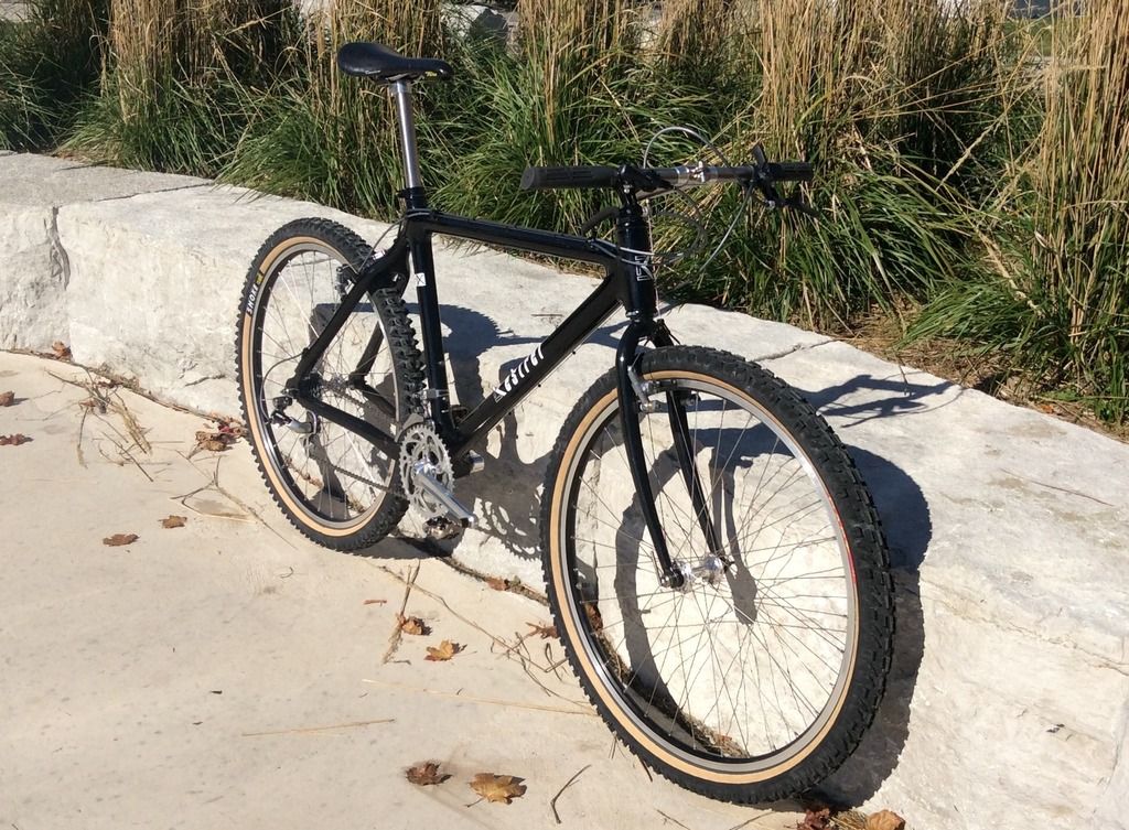

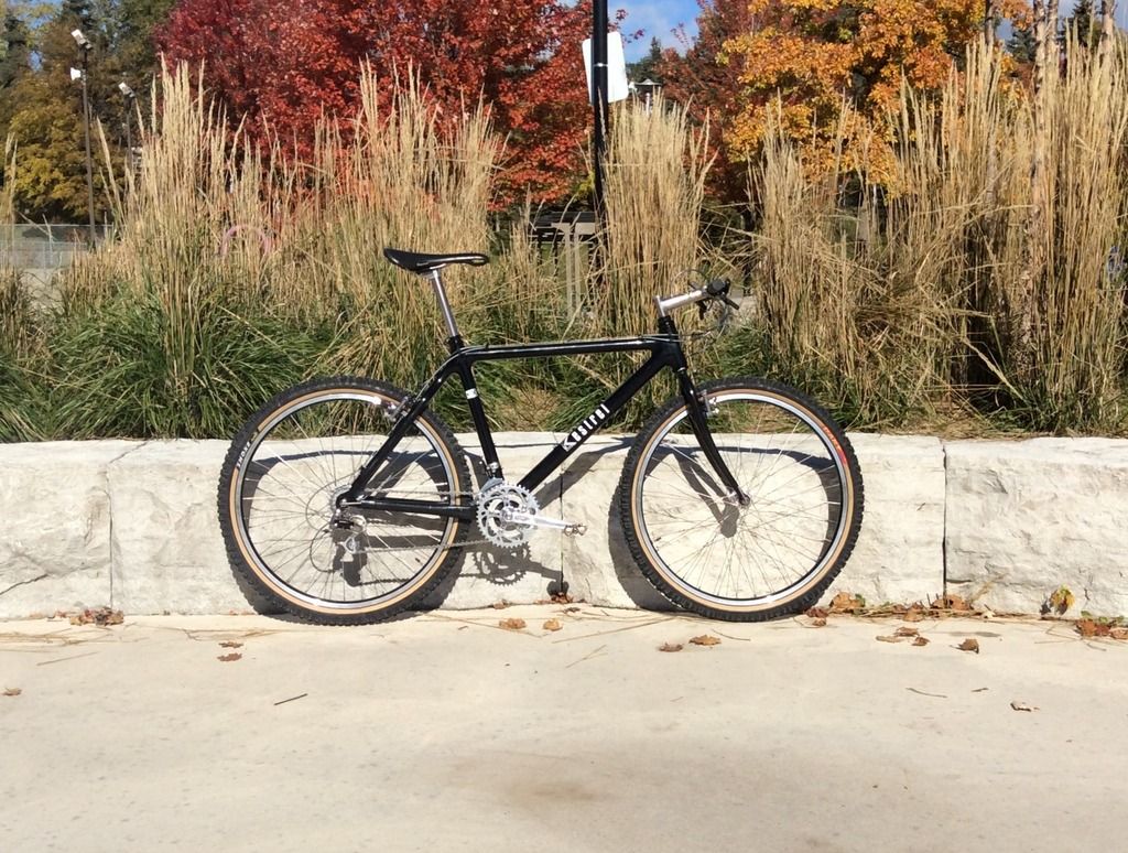

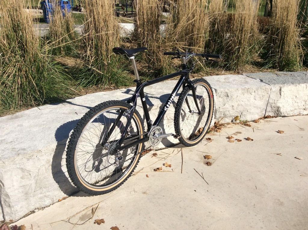

Essentially done. Gil is making me some Kestrel decalsl to go on the fork.
Turned out pretty well I think. Looks mean, has a ton of Ti and high end bits, and it's light. I was hoping for 21-22 lbs and got 20.4 :) I had sub 20 for the taking but it would have compromised the ride and look.
I'll get it out to a ride this week and do a better photo shoot later on.

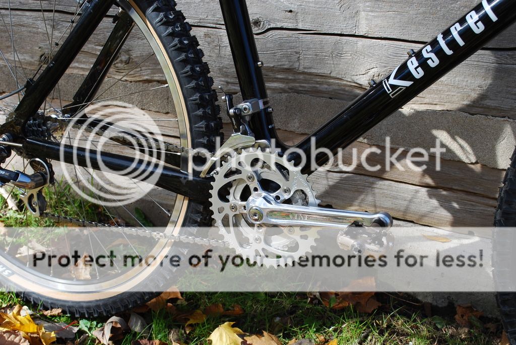

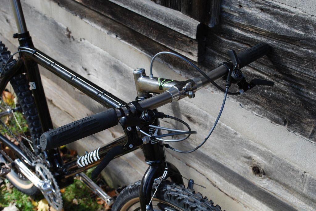

Frame: Kestrel CSX
Fork: Ritchey Logic
Headset: NOS Tioga Avenger
Stem: Litespeed Tuf Nek Ti
Handlebar: Titec Ti
Grips: NOS Tioga Bio
Brakes: Avid Tri Align
Brake Pads: KoolStop
Brake Cables: Shimano XTR
Cantilever cable hangers: Avid
Brake Levers: NOS Kooka Racha
Shifters: NOS Suntour XC Pro
Front Derailleur: Shimano XT732
Rear Derailleur: NOS Suntour XC Pro MD
Derailleur Cables: Shimano
Cassette: NOS Suntour XC Pro MD
Chain: Sedis
Cranks: TNT Gen 1
Crank Bolts: Titanium
Chainrings: NOS QBP
Chainring bolts: Titianium
Bottom Bracket: McMahan Ti
Pedals: Ritchey
Hub Skewers: NOS Nuke Proof Ti
Rims: Mavic
Hubs: NOS Suntour XC Pro
Nipples: DT
Spokes: DT Revolution
Tyres: Panaracer Smoke and Dart Classic
Tubes: MEC
Saddle: Selle Flite Perforated
Seatpost: American Classic Ti
Seatpost Binder: Ti
Weight: 20.4 lbs

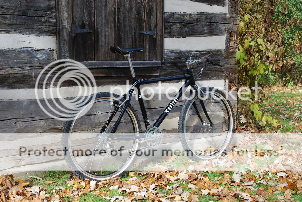

A few shots from the first ride. So far so good. This is my first Suntour bike and I must say ... I like the XC Pro thumbies better than any shimanos :) Much better feel IMO.
chicken":vnvg76p2 said:
That is the nuts. Such a cool build. Chapeau
Thanks :)
stuckinthenineties":vnvg76p2 said:
nice pics 8)
One of the older buildings still standing down near Sunnybrook stables. Crazy nice weather in Toronto this week. Gotta enjoy the trail before the white stuff.
