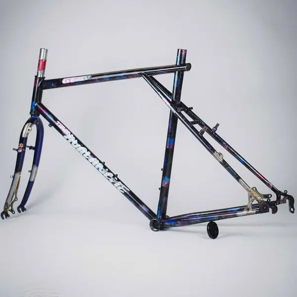

The next step was cleaning up and restoring the paint work.
Rubbing down, treating rust and reapplying clear coat worked really well (IMO) on my 1990 Team Avalanche, so I decided to do exactly the same thing.
As many of you will know, this is a laborious and time-consuming process, but totally worth it to get a result that makes that 30 year old paint work really shine again. It also makes removing the old, damaged, decals easier too.
My approached is 800, then 1200 grit wet and dry. Jenolite to treat the rust, and then a really good clean to remove the Jenolite and clear cut residue.
View attachment 781482View attachment 781483View attachment 781484
New decals came from a chap in Hungary and were applied...
Interestingly, the original decals were in some different places on this bike, (For example tubing decal on the down tube rather than seat tube) so I replaced them in the same way. Don't know why, just, did :)
I use SprayMax 2K Clear Coat. It's nasty stuff apparently, so I spray outdoors and use a proper filtered facemark and googles... this means I have to wait for a day when they temperature and humidity is just right.... In the UK, this is a summer activity only :-D and, in early September, I am running out of time... thankfully, last Saturday was spot on...
View attachment 781485View attachment 781487View attachment 781488
Clear Coat went on quite well... now I have to leave it for at least a week in the shed to cure....

Hi @Martin 4130 🇩🇪
Always cool to see another Midnight Aurora!!
To answer your questions:
Have you managed to get the old decals fully off or overlayered them also?
Sandet and/or peeled them off?
I complete removed the old decals, including the glue residue and applied the new ones to the prepared frame. After the old clear coat was sanded back I used a hairdryer and (very carefully!) a razor blade to remove them. Tried lots of tools, but found the old fashioned razor blade in a holder works best. I then used 'Goo Gone' to remove the remainder of the old decal glue.
Have you successfully sandet the whole frame without damaging the midnight arora layer!?
Yes, sanded the whole frame. It takes a while. I used wet and dry paper and used it very wet. started gently with 800 grit then 1200 and 1500 (I may have done 800>1500 - I don't remember) When you sand with lots of water the clear coat makes it cloudy as it comes off. You have to be careful not to damage the original paint. So it is wet>sand>rinse>check. I've done a few like this now and have avoided damaging the original paint on all of them .It sounds hard, but it is not if you do it gently.
Did u use the made in USA decal? 😅
Seems like it belongs to the right side toptube near seattube
-this decal is missing on most frames 🤷‍♀️
Here are some photos:
The original Logo on the left-hand chain stay - near the bottom bracket - this is on the unrestored bike.
The restored decal in the same place:
(This photo was an early iteration of the restoration - I've made a few more changes since this was taken)
I put the new decals in the same place as the original ones were on the bike)
I hope this helps ! Message me if you have any more questions and I'll help, if I can!
