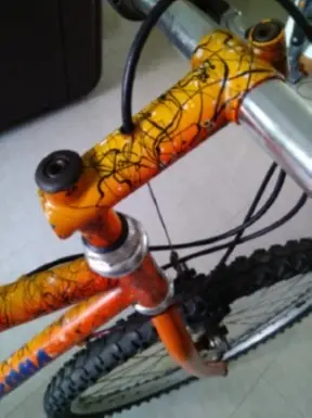

Hi guys. Recently I bought a GT Karakoram, 1990s frame and stem. I noticed the stem is (quill ) is different from the ones I saw you guys having. My brake cable goes thru the quill from the top, whereas the ones here goes in from the front ( with a tube kinda attachment ). Different year of mfg, different quill design? Help to identify appreciated.
Yours will be a 16" frame, smaller frame = shorter stem, guess there wasnt enough room to get all of an internal noodle in.

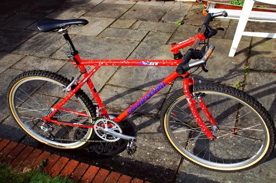

Update, long overdue ... finally happy with it
New wheels - NOS XT M730/732 hubs with NOS Ritchey Vantage Expert Rims, built up by local bike shop.
Syncros seatpost in the correct size (26.4mm)
NOS front & rear derailleurs - the old ones looked shiny but didn't work very well
NOS 46t Shimano SG chainring and new HG70 chain with quick link
Replacement top tube decals from Gil M (thanks!)
Just in time for winter :D
