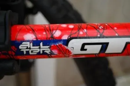

It is a 20" Inferno Red frame which looks in good shape, apart from some gear cable rub below the bottom headset race and some minor paint and decal damage, which I'm going to sort out with Humbrol enamels and a detail brush. Gil doesn't stock these early GT decals and he would need the bike to do them, which is fair enough as he does excellent work (more about that later).

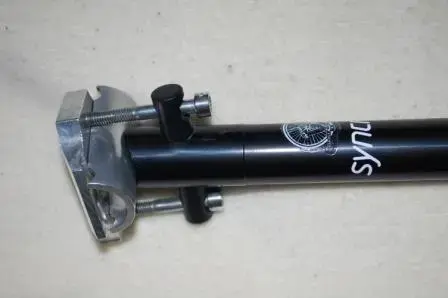

The non - original seatpost will be replaced with a first generation Syncros one I have that needs re-anodising and new decals (which I have thanks to Gil!) Saddle will be an original 1992 Flite Ti.

will be watching with interest what you do to your syncros seat post. All of mine are faded and looking very poor and I've always wondered if they could be re-anodized. hope you can detail this

The Syncros seatpost is somewhere in Royal Mail's big black hole of a delivery system on its way to be stripped, polished and re-anodised - if it ever arrives.... :facepalm: So much for track and trace eh?

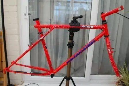

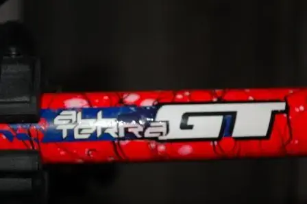

Not a lot of progress due to no spare time and various parts disappearing in the Royal Mail black hole, thankfully all turned up eventually :roll: .
However, the new headset and bottom bracket are fitted, decals have been repaired, damaged paintwork touched in and I now have all the parts for the build. I've got to cut the paint back with Autoglym polish before I start assembly. (The old brake cables and outer casings are still there as guides for fitting the new ones.)
Lots of cleaning, lubing and polishing still to do.

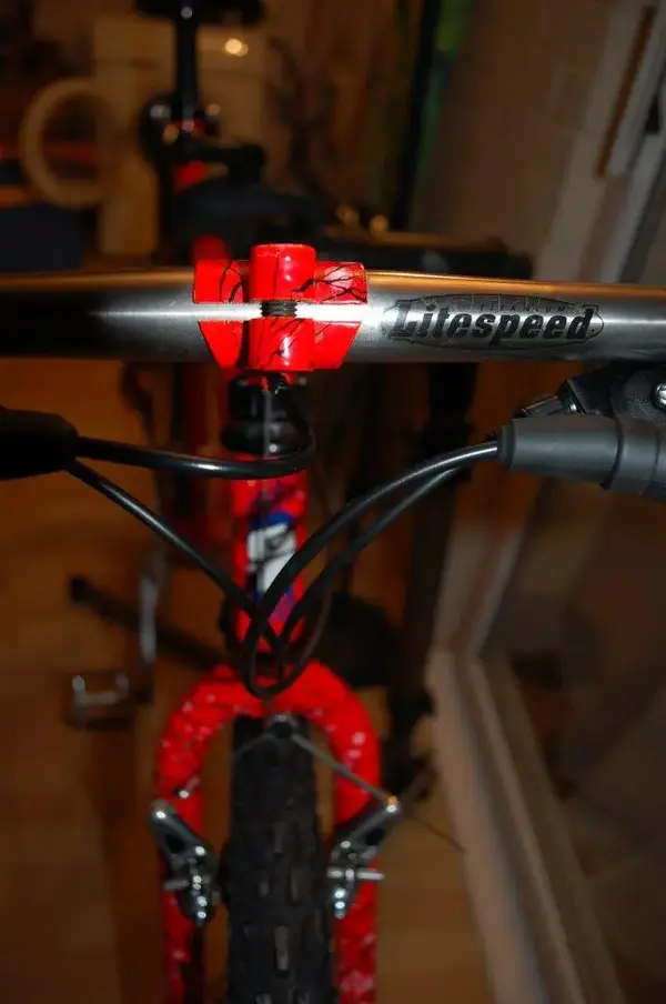

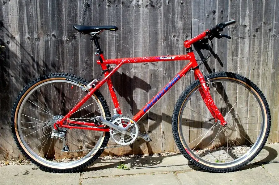

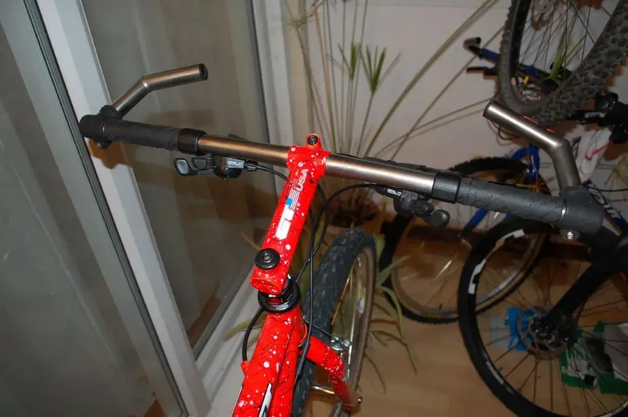

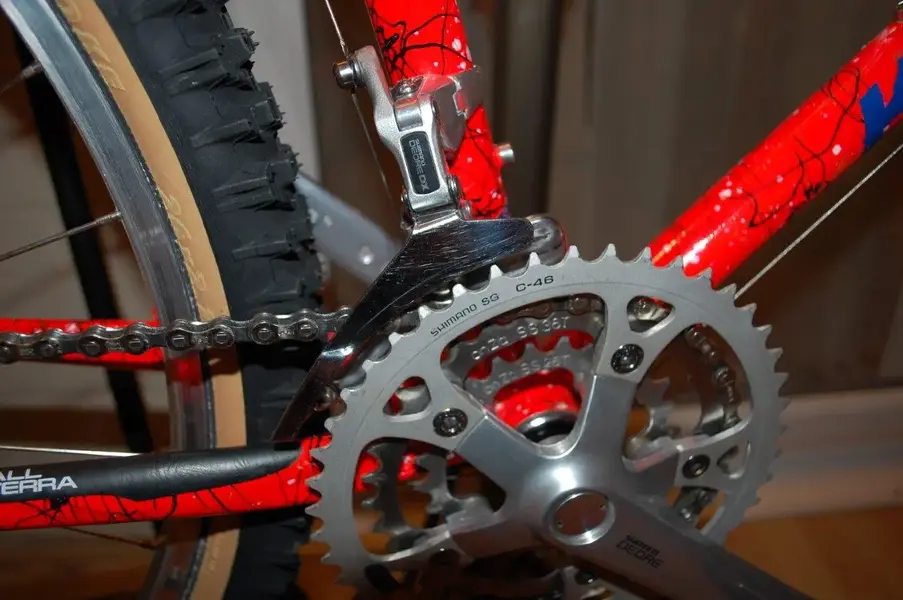

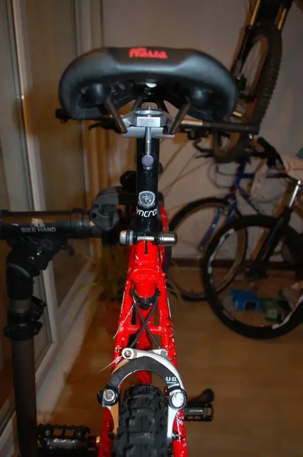

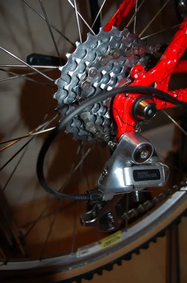

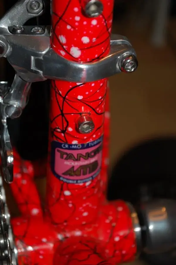

Finally finished..here's my take on a '91 Karakoram Inferno with a bunch of period upgrades along the lines of the Elite model of that year. It's a really great ride, a little twitchy because of the narrow bars but excellent fun and that's what it is all about :D
A big thanks to Mombat for inspiration and guidance with picking period appropriate parts, Gil M for the Syncros decals and a whole bunch of Retrobikers around the world for lightening my wallet :D
Frame: 1991 GT Karakoram Inferno - Triple Triangle, Tange Cro-Moly, size : 20”
Fork: GT Triple Trak Cro-Moly
Headset: 1 1/8” threaded Shimano LX M550, GT alloy locking lockring
Stem: GT Cro-Moly
Handlebar: Litespeed Titanium 600mm wide, 25.4mm diameter
Grips: Onza Porcipaws
Barends: Onza Titanium with Onza RCR200 rubber hoods & bolts.
Brakes: Front – Shimano DX BR650 low profile cantilevers,
Rear:- Shimano DX BR MT63 U Brake with Power Plate and Shark Tooth anti-jam.
Brake Pads: Stock Shimano DX
Brake Cables: Shimano stainless steel
Cantilever cable hangers: Shimano
Brake Levers: Shimano MO92 Servo Wave (2 fingers)
Shifters: Shimano STI MO92 Rapidfire Plus
Front Derailleur: Shimano DX FD650 (26.8 mm, bottom pull)
Rear Derailleur: Shimano DX RD650 long cage
Derailleur Cables: Shimano stainless steel
Cassette: Shimano HG70 (13 – 30)
Chain: Shimano HG91 with KMC quick link
Cranks: Shimano MT60, 175mm
Crank Bolts: Shimano DX
Chainrings: 46t – Shimano SG, 36t Onza Buzz Saw stainless steel, 26t Onza Buzz Saw stainless steel
Chainring bolts: Stronglight stainless steel
Bottom Bracket: Shimano UN55 cartridge (122.5 x 73)
Pedals: Shimano: DX PD MT60
Hub Skewers: Shimano XT M730/M732 quick release
Rims: Ritchey Vantage Competition
Hubs: Shimano XT M730/M732 36 hole
Nipples: ?
Spokes: 14 gauge stainless steel
Tyres: Rear - Panaracer Smoke Classic 2.1”, Front – Panaracer Dart Classic 2.1”
Tubes: Air B Butyl (Presta)
Saddle: Selle Italia Flite 1990 (titanium rails)
Seatpost: Syncros Propost 25.0mm with USE 26.4mm alloy shim
Seatpost Binder: Shimano XT M730
Other stuff: Ringle H2O bottle cage, Jagwires Tube Tops
Weight: 26.5 lbs
