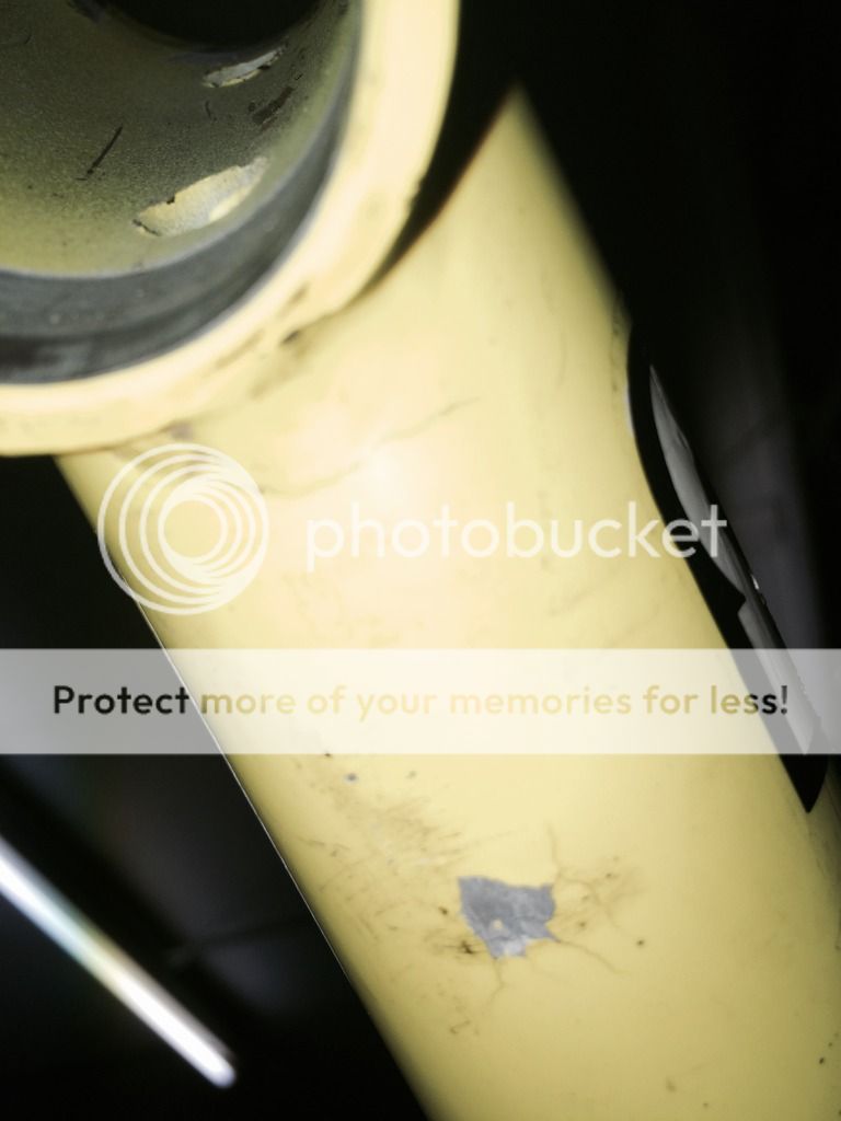

Firstly, the bad news is that Garry at Argos Racing Cycles noticed a crack in the down tube, just below the weld at the head tube (where they all go). I was absolutely gutted, shocked and disappointed at the discovery.
The not-so-bad news: Garry knows a guy can weld it so ensure some preservation of my beloved old frame, so my rebuild project is still alive!
I guess there's two ways of looking at this awful news, but both with a positive spin. 1. If I hadn't taken it to Argos the crack may never have been found and I could've seriously damaged the frame on its first outing if I'd chosen either not to strip and repaint, or had someone else do it. 2. The fact it's being welded to repair it means I have to be extra careful, thus giving me a bonafide reason to not use it much once rebuilt! :lol:
Guess my initial preliminary inspection wasn't up to much, eh?! :oops: But I feel totally confident the frame's in the best of hands with the experts at Argos in Bristol. Should be ready mid-October, so a few extra weeks of parts hunting have been afforded to me! :D
The crack (the thin dark line nearest the headtube):

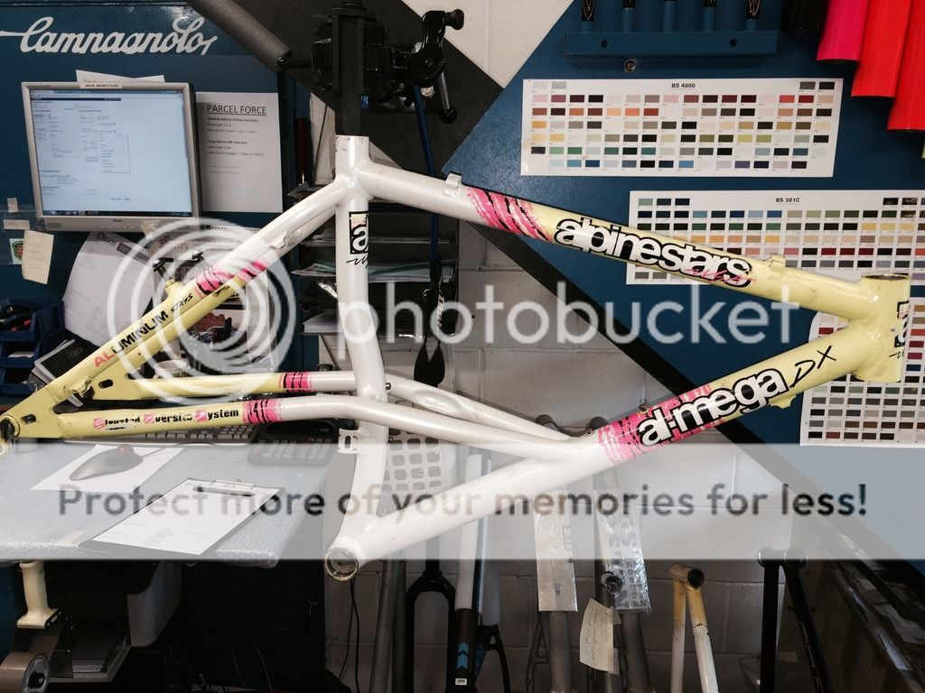

At Argos, last time I'll see it in this state!
Don't want to dent your enthusiasm, but if I were you I'd forget about riding it...........
I had the yearning for an Al Mega so bought a complete bike off Ebay about 2 years back.
Arrived, and it was cracked on head tube & seat tube & stem was cracked, I disputed the sellers description & won a refund.
On thinking about it, I decided not to send it back, but keep it as I figured I could get another frame and swap the bits over, the bits being hard to find.
Got a near mint one off a seller on this forum, really chuffed with it, and there were definitely no cracks, any flaw in the paint on these things is the giveaway.
After a few months of the frame sitting in my dining room I got all enthusiastic about putting it together.
Devastated (understatement) to find it had developed a crack half way around the seat tube thro' one of the tapped insertions for the bottle cage.
Got it welded & fannied about with white undercoat & white pearlescent & lacquer to get it back to something presentable without filling and smoothing out the weld.
Left it another month or so in the dining room before regaining some flagging enthusiasm for the thing.
Unbelievably, it had cracked again about 3'' below the new weld...............
So.......... have got 2 useless frames, project has been ongoing for too long, and still have never ridden one............
Don't risk it, I'll be going for a steel one........... if I ever get any enthusiasm back.
