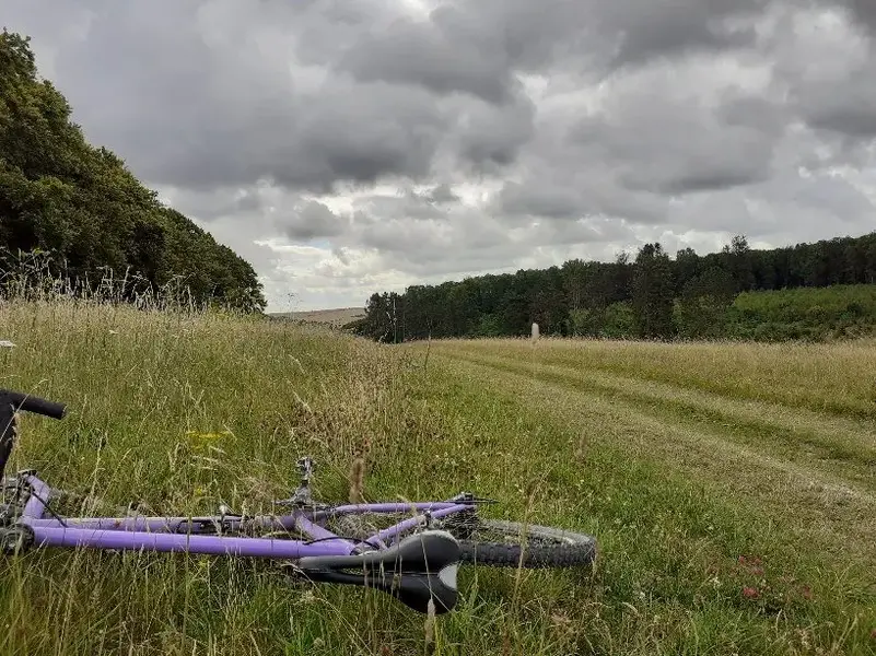

Did 14 miles off road this morning on Oxfordshire's Strada Bianchi, The Ridgeway.

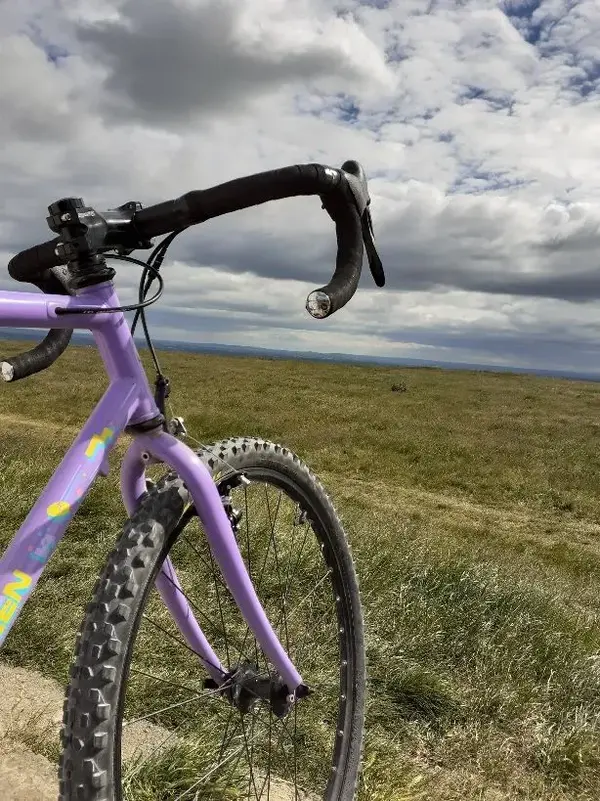

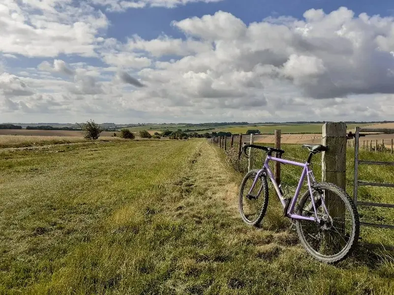

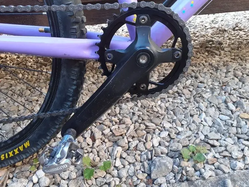

A few more pictures from this morning. The n/w ring kept hold of the chain, had a couple of ghost shifts so a tweak maybe needed there but otherwise it was great.

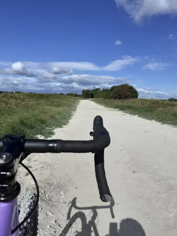

I took this out this morning and had a good ride on the downs and Ridgeway. The 70mm stem is an improvement, much better for the neck and shoulders!
This is making me think a bit. I am riding this in preference to my '05 Giant Nrs. There are things I like about both but the simplicity of a rigid steel frame is the draw with this,it suits the chalk downland riding I have on the doorstep well. There are some shortcomings...the front brake is no more than ok and the rear brake is terrible, the frame is maybe a bit long and lofty by about a inch in either direction and shimergo 9 speed is a bit hit and miss. I can live with the size, I can sort a 10 speed gearset out for it but will have to experiment a bit with brakes!
