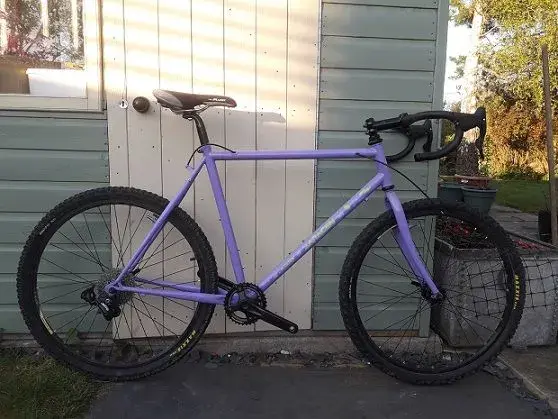

Re: 1990 Saracen Eiger Competition
Slight change of plan....found a Raceface 36t ring from a 2x set so going to try this as 1x9 and see what it's like.
Now with shifters and cranks......
The reach to the hoods is too long but pretty sure a 90mm stem woild be about right. Quite looking forward to a ride when it's finished!
The colour scheme is beautiful, nice colour with all black components does it for me.
Just was about to write about the reach - shorter stem should help, if i doesn't, then modern drop bars will. There are lots of compact ones with shorter reach and more anatomic shape, when I did drop bar conversion, this was what saved it. Didn't expect such a difference, but the bike just suddenly moved from "meh" to my favourite.
Liking this... looks good and is getting a makeover to make it fit a niche in your stable? Great idea...
Thanks both.
The bars are better than they look in the picture and are marked 85mm reach, not as nice as the 70mm reach Specialized ones I have on another bike though, so shorter reach 'bars are a thought to bear in mind when trying get it comfortable! I can borrow a 90mm stem of my NRS to try when it is nearer finished so I will start there and see.

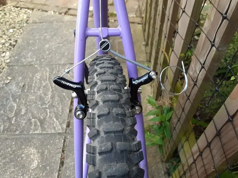

Today I reacquainted myself with cantilever brakes for the first time since about 1998! Fitting a new piece of outer cable through the top tube went better than I expected. The rear is done tho not set up perfectly, looks good tho.
