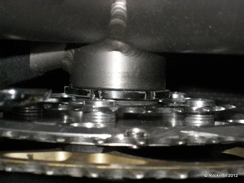

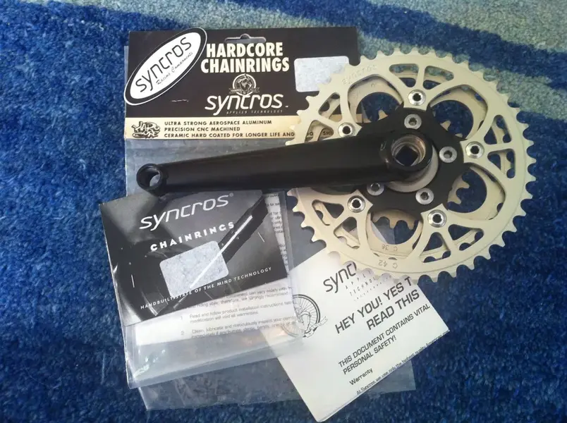

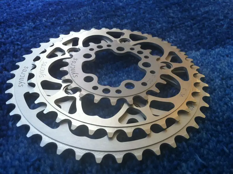

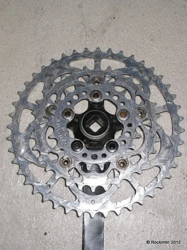

OK, trying to get this together. New decals for cranks and stem are in the post from the UK. I received some very nice NOS Syncros chainrings so decided to put them together.
Looking good..... at least on my living room floor, but then I went to put them on the bike and I'm running into a bit a problem with the inner chainring colliding with the BB lock ring.

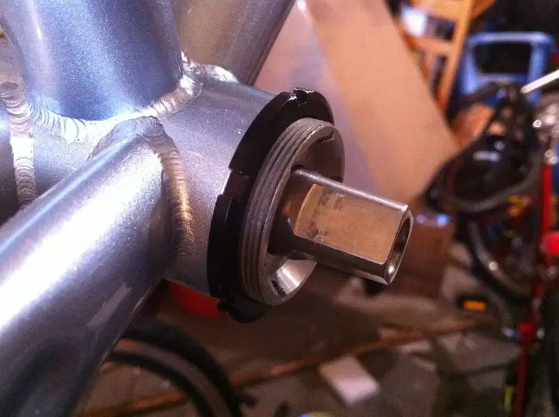

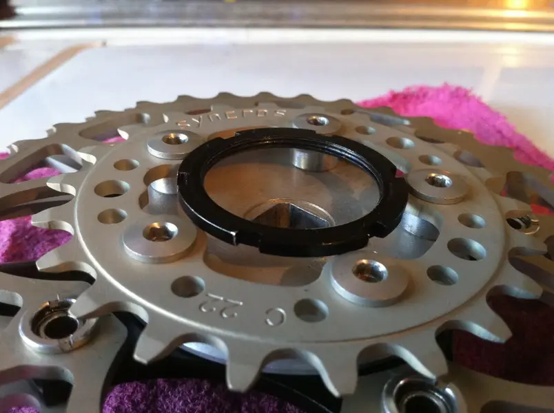

Here you can see the lock ring that is a wee bit larger than the inner chainring.
So I guess I could try to find a lower profile lock ring?. I like the length of the spindle (which I should really go measure) the cranks are well spaced, close to the chain stays, and the middle changing is about 44mm from the center line of the seat tube.

:shock: Sweet!!! Where'd you get those NOS rings! Jealous! :twisted:
You sure you have the right length bb spindle??? You should be using one that's 117mm.
Rings from evilBay.
I just measured the BB spindle at 113mm. I think you're right and I need a 117mm. Hmmmmm back to the hunt.
I'm using a Syncros 117mm (maybe 118mm???) with my Revo on the RM Ti and clearance is good. I can't even recall how I managed to score the BB in the first place. Might even be Ti but I can't remember. :?
Regarding rings, I say outer two logo's out. My set of compacts I recently picked up along with black forged cranks has to be that way since they're ramped. Only the inner HAS to be facing in, as there's a cut out around the holes for the bolts to fit within.
These Syncros forged are gonna go on my future incoming RM project which I hope to getting soon! :D
