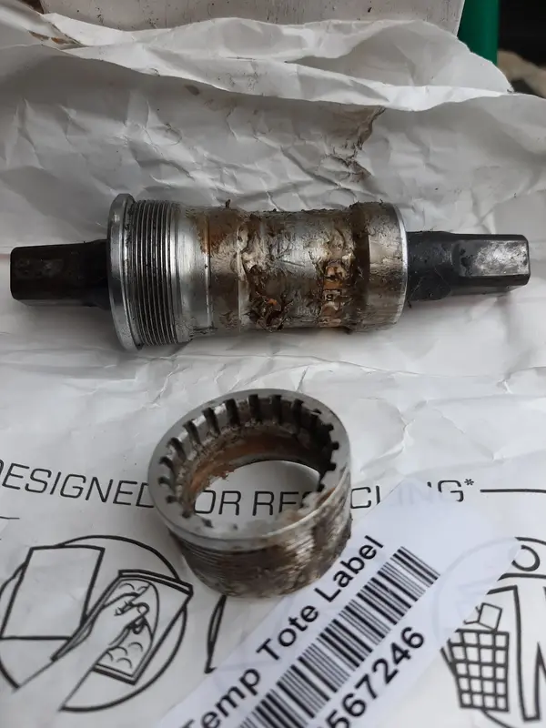

Well I've had the BB removed:
LBS did it for free! Top lads!
Here's what they handed me in a bag:
Looks ruff? Cleaned up lovely!

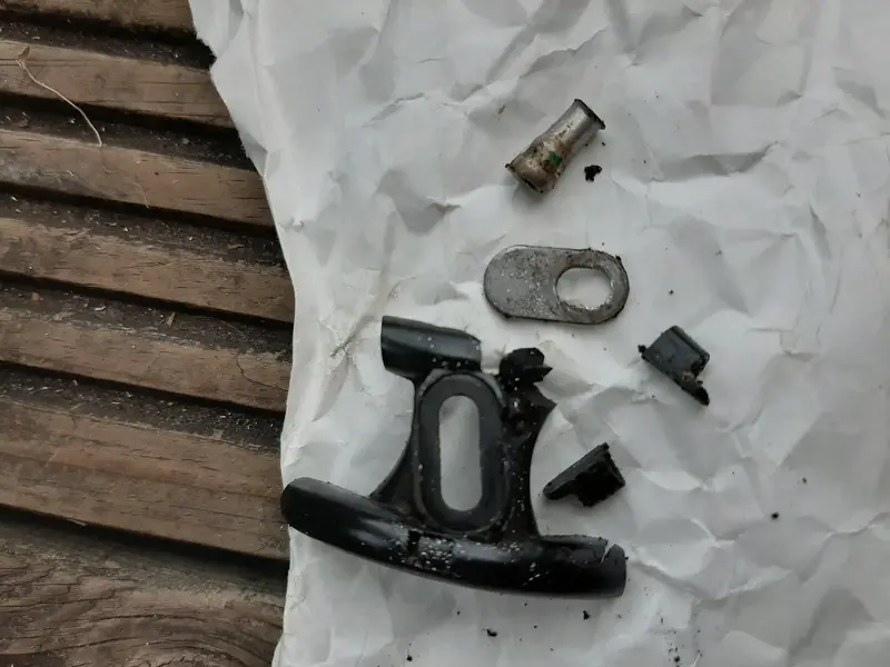

The cable guide rivet chewed up the label on the BB body, if you look closely at the pic above you can see the circular impression of the end of the rivet:
Going to need a new cable guide:

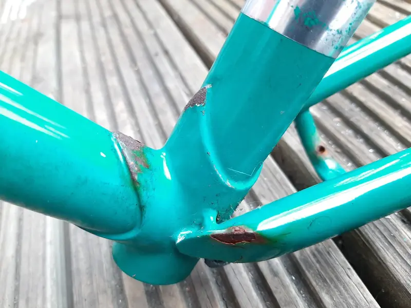

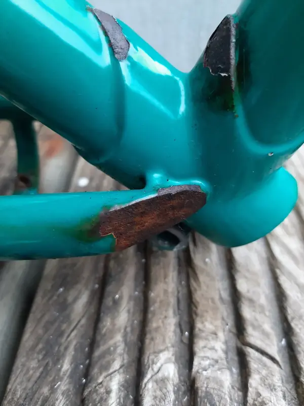

Noted the rust on the frame:
I noticed the original paint seems fairly soft, the cable guide had bitten into it under the pressure of a rivet.

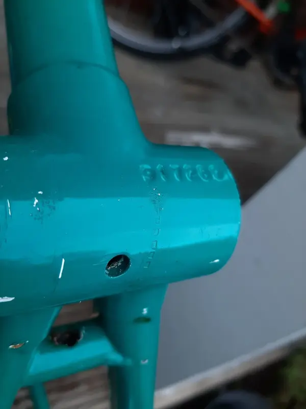

Is anyone able to get any information out of the frame number 917289?

That bottom bracket shell area is quite minty. That bottom bracket that has been removed looks in top nick and is totally worth screwing right back in and the original square taper crank cleaned and re-used. If the chainrings are worn out with hooked/damaged teeth etc they can be replaced easily. They look like 110mm/74mm BCD cranks and there are many chainring options, in those sizes, from super cheap to super expensive available new,or used.
number 917289?
Morning Dave, I’ve been collecting Falcon CB numbers for a while now and tbh there’s not much to say. Everything that Falcon made during this period (Falcon, Holdsworth, Claud & I think Dawes) got lumped together. Not all got a stamp. Most got a printed & laminated foil sticker. Later on in the 90’s more frames appeared with stamped numbers, but these were always on the models that had been manufactured by others and shipped in like the aluminium frames from the Far East.
Your frame is a design that started being produced in Brigg from the latter half of 1988 to 1996 with only a few minor tweaks along the way. The colour and graphic combo dates it specifically from a production window of Nov 1988 - November 1989. It was then switched to white with new style graphics ready for Christmas 1989.

No noises or graunching from the BB , feels slow to turn by hand but I guess that's the missing leverage from the cranks?

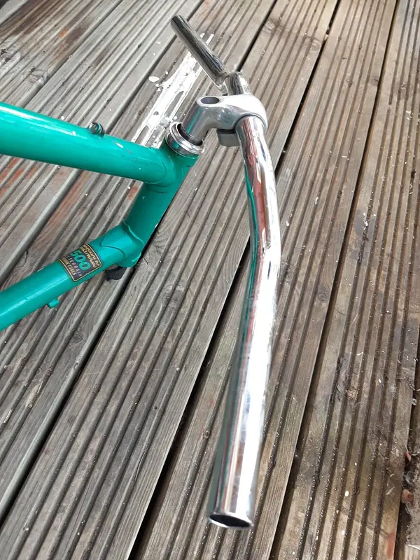

Well a set of drops is going to be bit more of a ball ache than regular mtb or touring bars is what I meant.

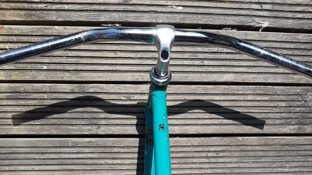

A flipped set of Pashley bars for example:
Shifters, stems, brake levers etc.
Less straightforward with more parts to be bought and ultimately fiddling around to get a shifter, cassette, brake, wheel combo that works.
Or plug n play a "regular" bar?
Cheers
Dave

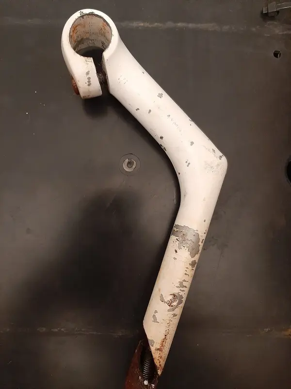

Yep chromed steel, from a 2010 Pashley Courier.
24.5 inches wide with 1.5 inch rise and sweep, just flipped over. That courier stem is too short and the original Claud specced Kalloy AL222 is too long.
Cheers
Dave

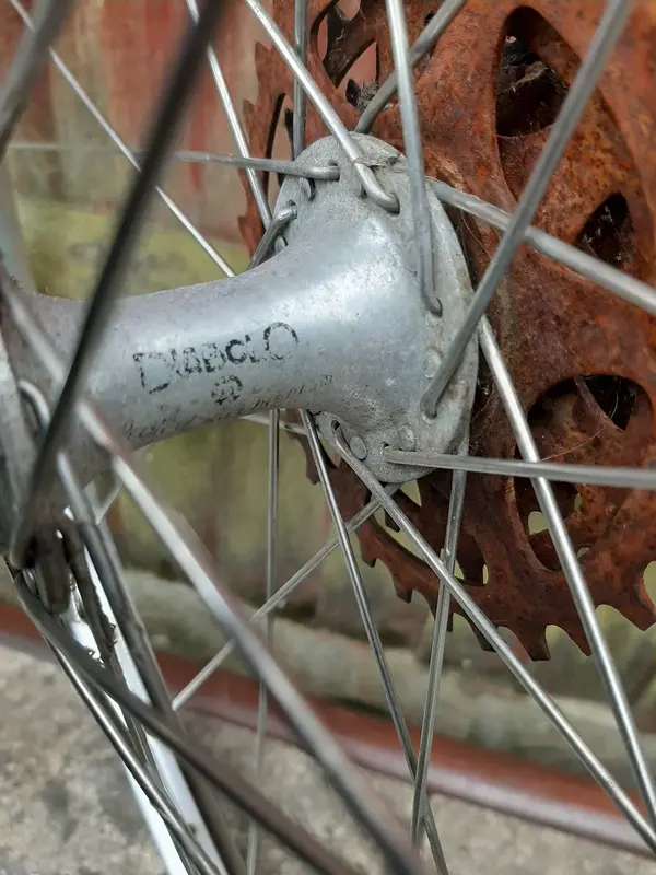

Righto chaps. Time for some wheel/spacing/gearing/cassette questions.

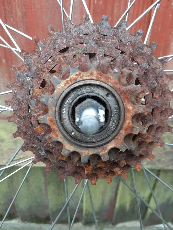

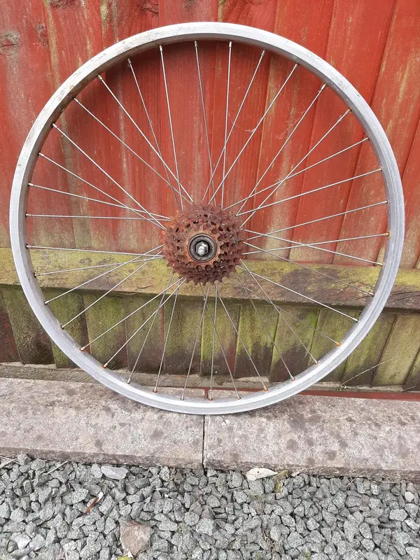

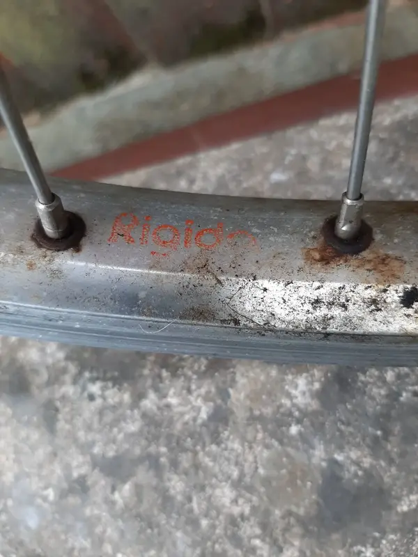

I have the Rigida Rally 30s which have been on this bike for about 20 years. The rear is 130mm spacing and wears a 6 speed Shimano freehub. The bike has been left out in all weathers so the wheels look like this:

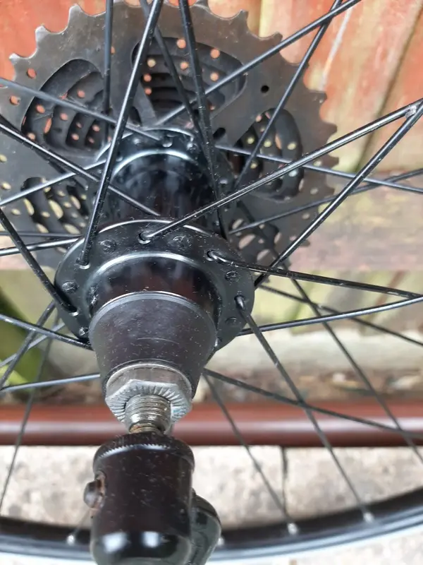

I've been through the shed and robbed these off my sons' abandoned 2015 Giant Escape 2:
These are basic Giant GX02s but have only had couple of hundred miles use. Running an 8 speed cassette, I think.
The Giants are 19mm and the Rigidas are 23mm
The Giants are 135mm OLD whereas the frame and Rigidas are 130mm.
The pair of Rigidas' weigh: 4.848kg, the Giants' less at 4.188 kg a saving of 660 g.The Giants' being narrower, I should also get a rounder profile out of the same width tyres.

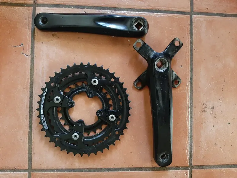

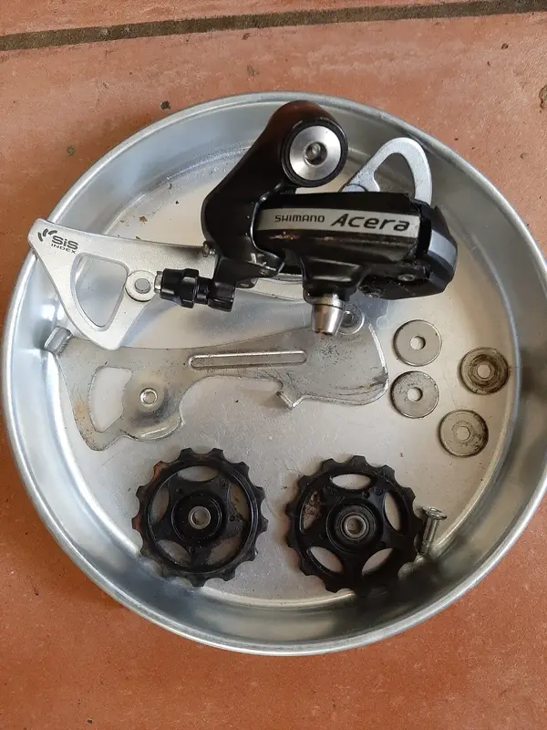

2: Finding suitable chainset (nick the 8 speed derailleur, cranks and chainwheels off the Giant Escape? Its Acera/Suntour XCE)
3. Can I upgrade to more gears in order to get lower gearing? New rings and cassette? Shifters and chain I need to obtain regardless so 9/10 speed if doable wont add extra cost there. Or should I stay with 8 spd and add those components at a higher quality?
