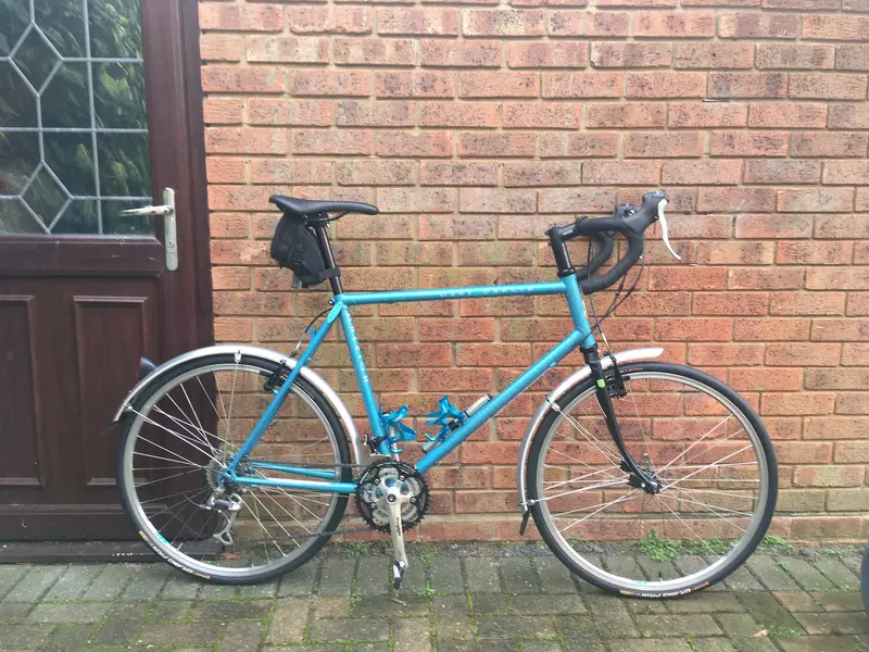

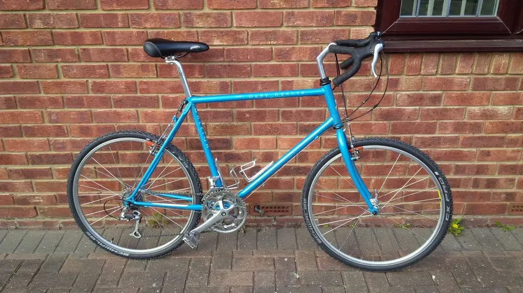

Regarding trying to lose some weight from young Claud, this was my first attempt at a similar build pretty much using parts I had to hand.
It was about 30lb as far as I remember. Just a word of caution regarding weight, to be very selective over the parts you use. The bike is now built up as a wet weather road bike and with mudguards, seat pack, pump, bottle cages now comes in at feather light 27lb.... It's not easy to make light bikes from these types of frames. I'll post a picture in it's current guise so you can see just how many parts needed to be changed.

Interesting take on the weight issue. Noted and will do my best to weigh parts as I go along.
I notice both sets of forks in your blue bike photos bracket the shape of mine. Your blue forks look 'MTB' and your black forks look 'ROAD' Guess mine are 'ATB' lol.

Hi Dave, regarding the forks, yes the original forks are ATB as were most at the time. However, I found that they were exceptionally heavy and also found that because I wanted to run road sti brake / gear shifters, old style stem and bar combos were making the reach too long (old style drops tend to have a very round profile when viewed side on, modern road bars are generally shorter reach). Initially I retained the forks and used a quill to ahead adapter, then I switched completely to ahead style as, rather luckily, the head tube was made for 1 1/8th headset.
The black forks come from sjs cycles and are really nice, made from Reynolds 853 and weigh in at 882g. They were not cheap, though they were not full price either as they came from the discounted section due to non perfect paint finish, though I actually couldn't find anything wrong with the finish.
Don't think I paid what the current price is. They are fine for off road tracks but sjs don't recommend fully laden touring or mountain bike downhill racing...
