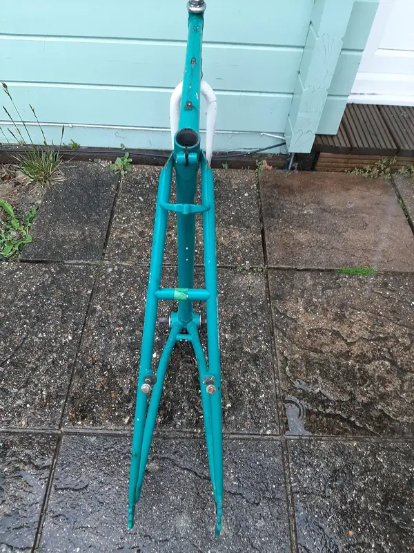

Hi guys,

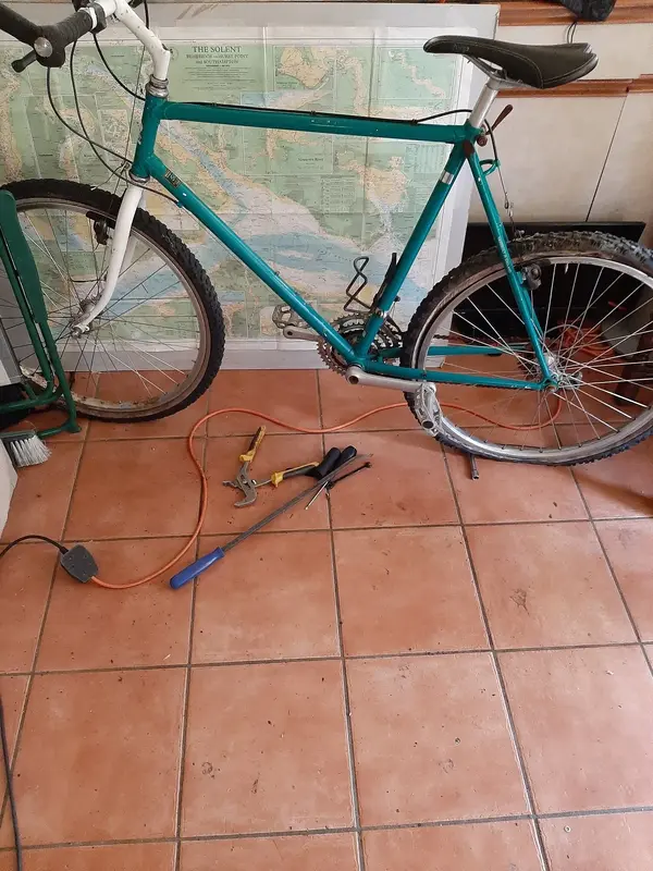

I managed to get The Pagan into the shed for an hour this afternoon...

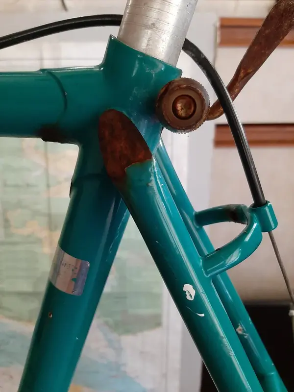

Noticed some nasty rust that has blown the paint off....

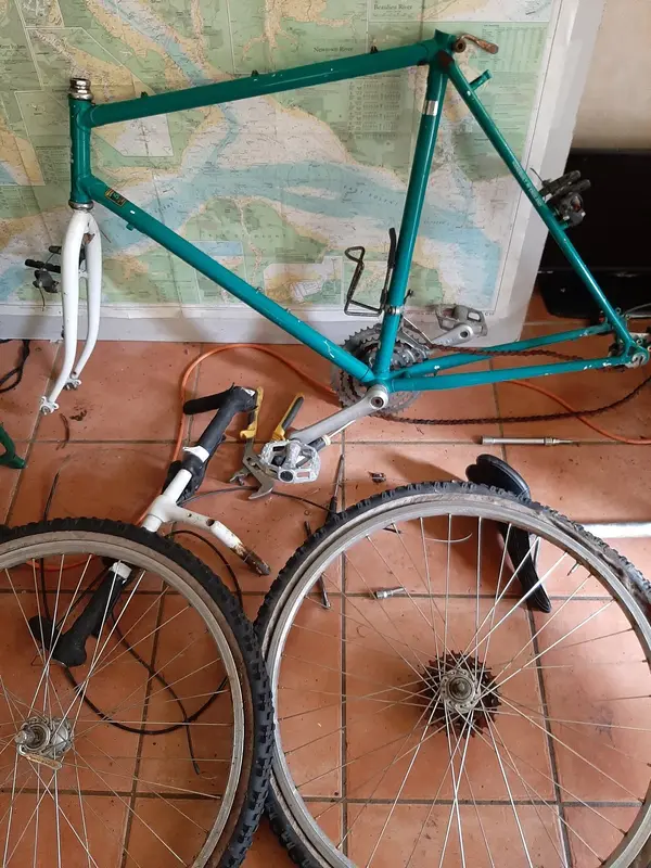

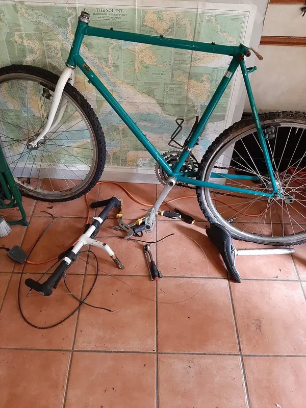

Then started stripping her down....

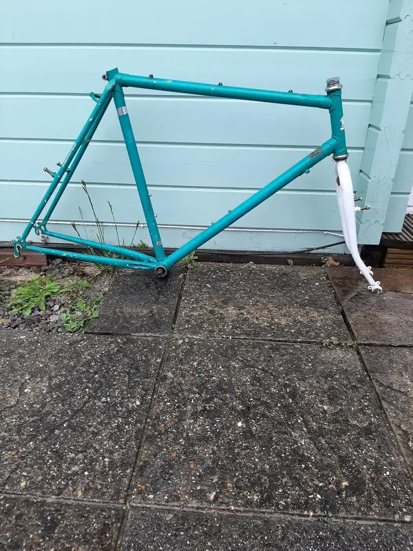

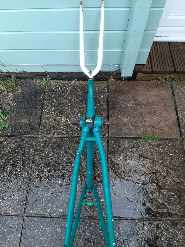

I dont think I have the tools to remove the headset and bottom bracket so I stopped there and examined the frame and forks....
Got to get some more tools now I suppose?
