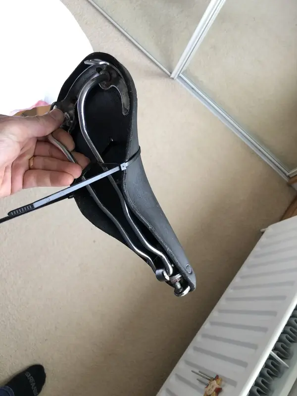

Gave the Brooks this came with a couple of dabs of proofide top and bottom, then used a couple of cable ties to try and get the shape back:

Not sure if this will end up going back, I have another option which I had a go at re-covering this afternoon:

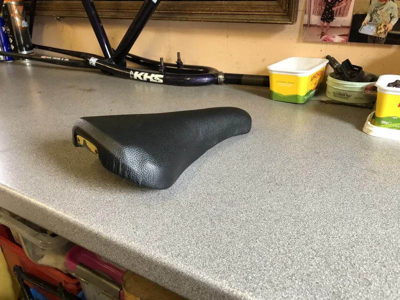

I’m getting better at saddle refurbs, should probably get some slightly thinner vinyl. What I’m using is off-cuts from a leather sofa which I took apart in order to get it to the tip in my car(!)..

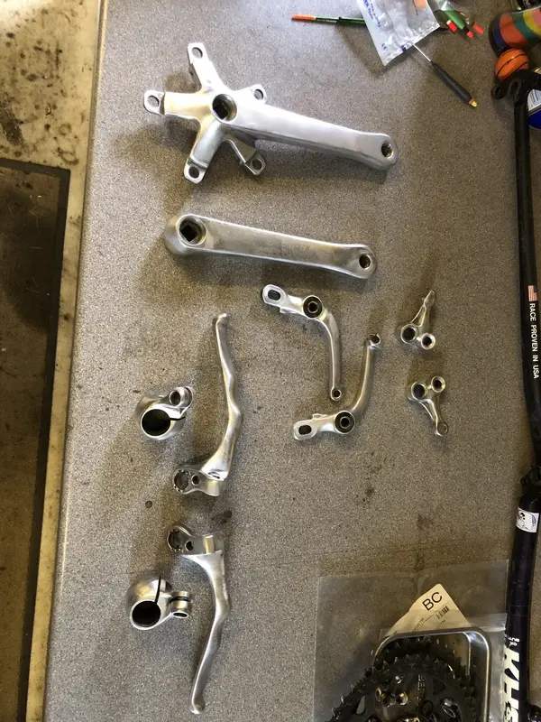

Next step was to clean off the old paint from the components and get them ready for paint:
I managed to get a single pair of dia compe 983’s off eBay too (top of pic) to replace the Deore II ones it came with.
Got all these bits in primer, hopefully top coat tomorrow:
I want to give the paint as long as possible to cure before I re-assemble the bike so the sooner they’re painted the better.

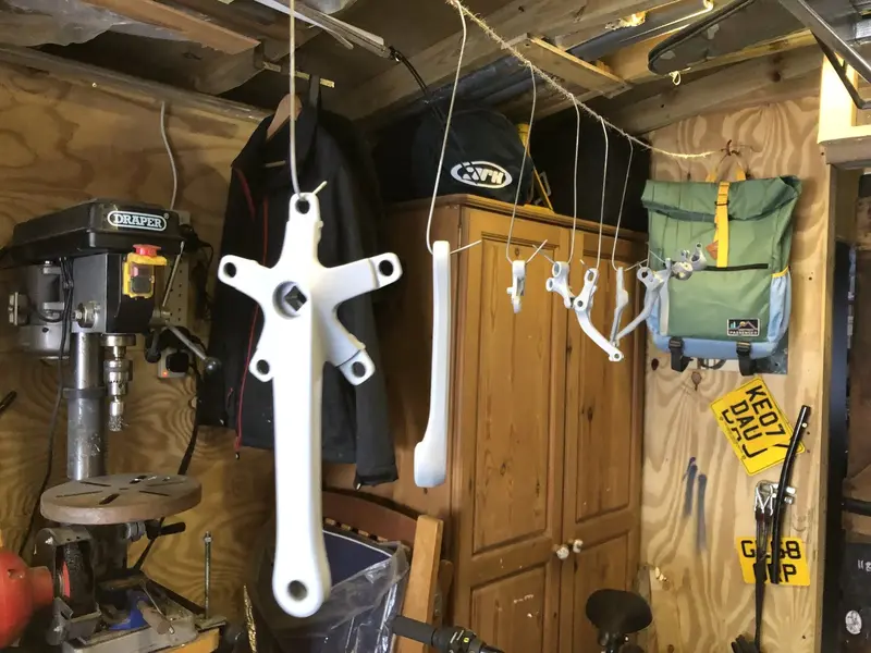

Components are drying off nicely, two coats of paint and two coats of lacquer.
B304FE01-3752-4667-8F93-2A9D82FFE345.webp D13D5893-6434-4C4C-BE4F-B9E8A46719D8.webp
I went for Peugeot Graphite Grey, which seemed a close match on the can but it’s come out a bit dark. Ho hum, think it’ll be alright once it’s back together - heck of a lot better than it was.
