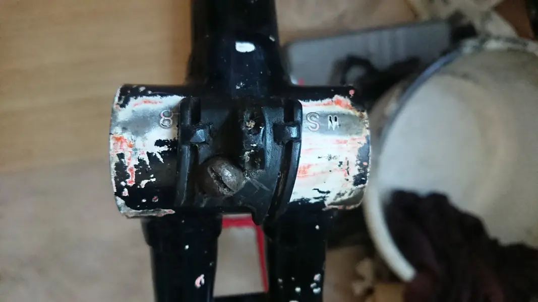

MADB, I know this is a really old thread but I wonder if you could help me out please. One of these Avantis came into our community workshop and we're refurbishing it, but I'm struggling with the correct cable routing, with regards to the rear brake. Currently there's a two-channel plastic cable guide under the BB shell, presumably for the gear cables. So, where's the central cable for the rear brake meant to go? Was it originally a 3-channel that's been replaced before the bike came to us or am I missing something?
This member hasn't been active here for a good while but I would say a triple guide under the bb shell would be exactly what you need
I've just checked my heavily customised, but similar 1988 Raleigh frame and it has a triple guide that looks like this:
Apologies for the poor lighting, but it has the two mech guides and central u-brake guide.
Thank you both! I fished out a triple cable guide and tapped an M6 thread into the hole in the shell to be able to hold it in place. This bike rides like a dream!

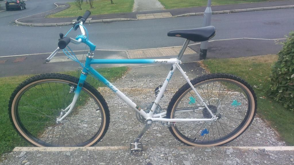

In preparation for its arrival tomorrow I thought I might start a new threat.
I'm hoping that I can keep this in its original condition but we will have to see, it looks a bit ruff in the only picture I have but it definitely worth saving even if I have to get it repainted and new decals. I will get better pictures of it this weekend.
and the sale add i bought if from just so you can see what it looked like when I picked it up.
