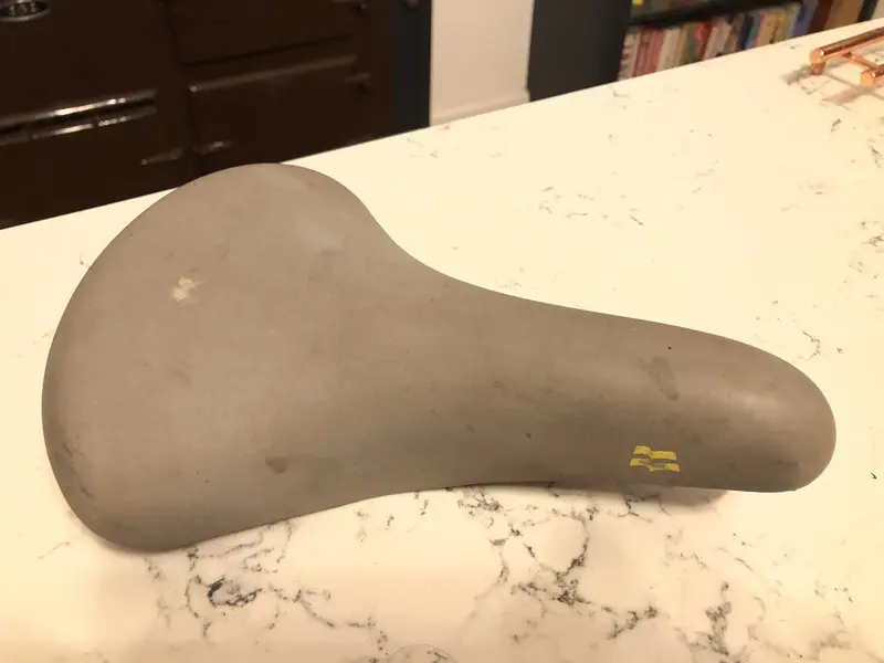

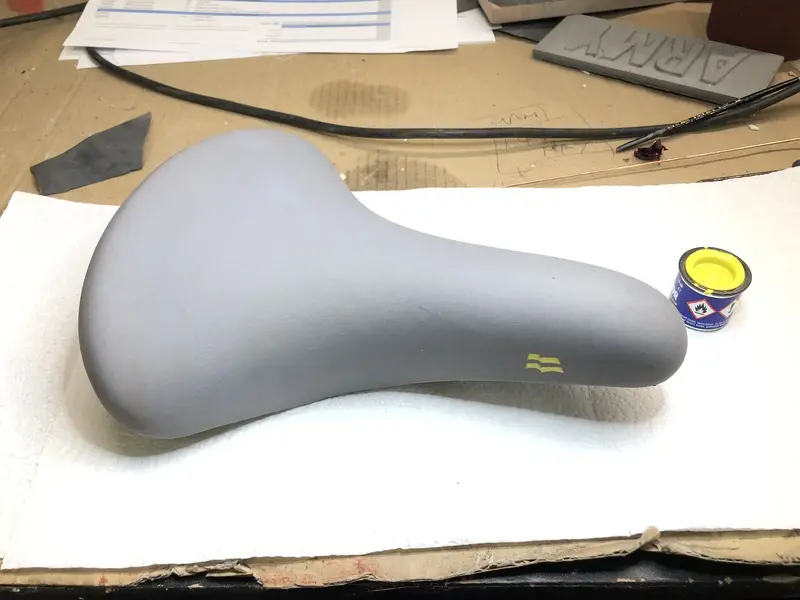

Mrs Peachy wants a go, but has asked for a “ladies” saddle.. I’d picked up a grey suede Specialized flag cheap on eBay. Usually quality, never been cleaned, just screaming out for some Peachy TLC... 02B11FC3-D237-4385-8434-178FAEDBDAE8.webp FEC70A6E-E27B-4DD2-89C2-C7DEF57ED060.webp 3538156C-6213-4BCE-87EE-460BA89C27F5.webp
Pristine . Consistency is a measure of tastiness .
Commenting on your work seems kind of redundant . Hats off .
