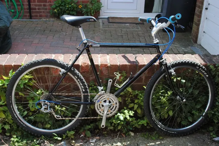

Separated at birth?
Pad material and angles helps with the brakes BTW.
yeah man, been having a fiddle with the 'mechanical advantage' variables and getting much better results now... your bike was the one that kick-started my project, 'tis indeed awesome :wink:
