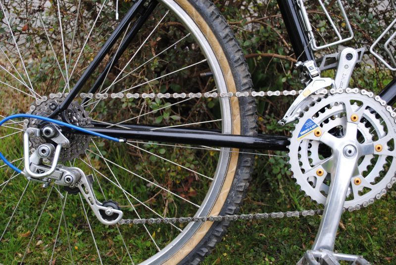

Hamster very kindly supplied a set of chainring spacers, which allows elpedro666's 36 tooth ring (that he battered around Cannock chase with me a couple of weeks back) to be fitted to the polished M452 cranks along with the other, 46 and 36 tooth, SG rings. I say polished, but there are some chaps' efforts on here that put mine to shame, so might have to have another go. The gold Middleburn chainring bolts look very nice though...
LGF has supplied a M452 front mech to match the rear I got off him in spring - both are in superb condition, just needed a quick wipe and polish. Ok, they are 5 years 'too modern' for the frame, but I think the black face plates (is that what they're called?) will suit the frame perfectly - and I want the comparative ease and performance of 7 speed HG...
