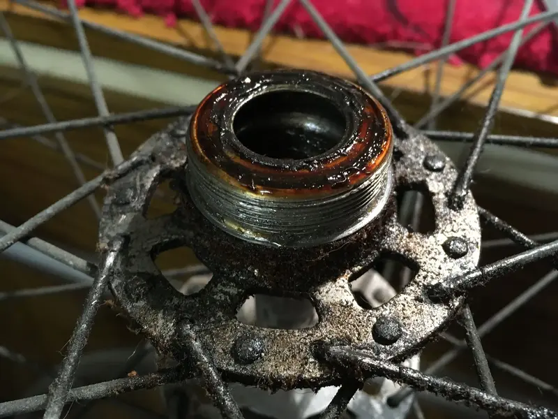

OK... the SIS vs friction question is beginning to look moot. So far in attempting to remove the freewheel I've only succeeded in wrecking a brand new freewheel tool. To make matters worse I had to pull the axle to get it to fit. Without removing the freewheel servicing the hub is going to be a bit fiddly...
I suppose the good news is that the freewheel itself appears unscathed by the experience.
Maybe here and now it's an LBS job... I've got a good tool and a vice in storage but "locked down" 200 odd miles away...
Or could just clean up as best as possible and keep the existing freewheel/shifters.
Hmm... :?

legrandefromage":19om577x said:
some of those tools are nasty cheap, I had one snap completely in two
This is a Super-B, made in Taiwan. Should be OK quality and looks well made but clearly it's made of softer metal than the freewheel itself. Might try to get a refund. I've bought Super-B stuff before and to tell the truth it's always been a bit so-so. Probably give the brand a swerve from now on.
Well, it took less than a year to get the freewheel off... pleased I ponied up for a Park FR2.

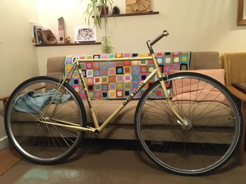

Messing about with wheels and tyres. Ignore the rear one for now (and the stem).
Plan A was to keep the original 27" wheels (with Schwalbe marathons) but I'm thinking about more modern 700c wheels (with a cassette hub) and gravel tyres. Would save some weight. There's plenty of clearance for the 38mm tyres (and still room for mudguards) and I reckon I can make the centre pull brakes work too.
I like both, but I think I have a favourite.
