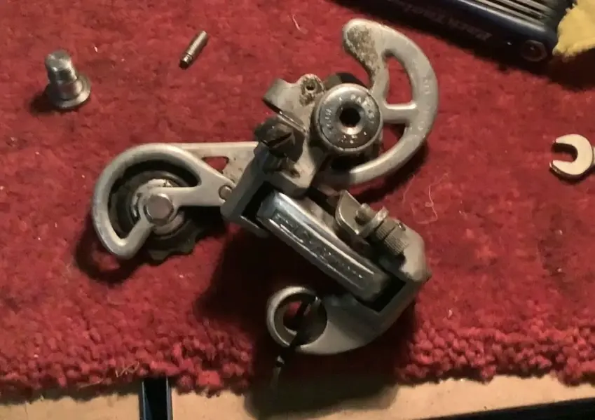

Thanks Peachy, yeah they work ok don't they? Actually I've got a few options here already - just thought it might be fun to make a "special" long cage 105 out of the scrap pile...
Started looking up date codes following cleaning... the Suntour mechs are dated 85 and 86.
Frame code has been misread previously too... it's actually 060988 which (correct me if I'm wrong) makes it 1984.
Seems odd that the mechs would have been replaced that early on in the bike's lifetime... especially to something fairly similar to standard equipment.
I wonder if this received the "upgraded" mechs along with triple chainset from the dealer? Didn't these usually come with a double?

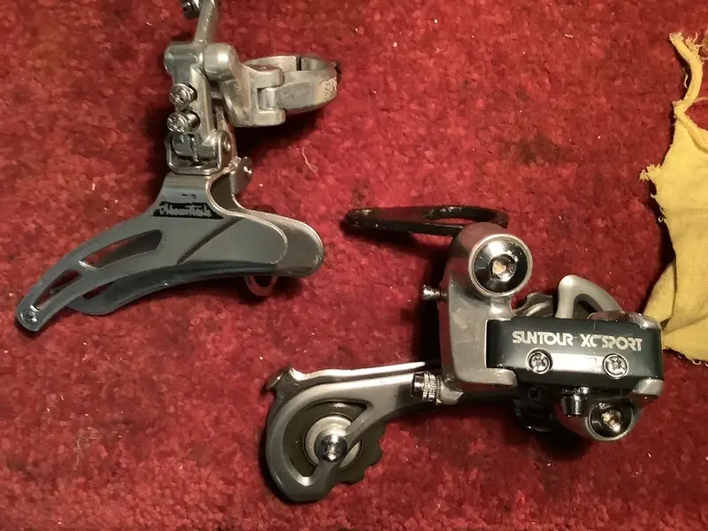

Once I start cleaning I get a bit obsessed. Takes ages too.
Also photographed are a slightly earlier 1984 mountech front mech which I bought for the Falcon in my sig. And a blurry 1979 V-GT purchased for the same purpose which I have bravely dismantled and left to soak.
I can't decide which mechs to use. Will probably leave it with the ones it came with...
Very good news is the pedals were incredibly easy to remove. I left them til last (wheels off) which is sometimes a silly thing to do. It's proving to be a well-oiled machine.

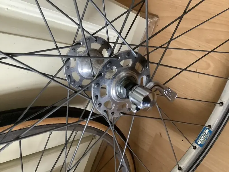

Front hub serviced, new balls and grease. The usual to-ing and fro-ing trying to get the bearings perfect... and settling on a compromise!
Replaced knackered rim tape, tyre and tube. Just the rear to do now...

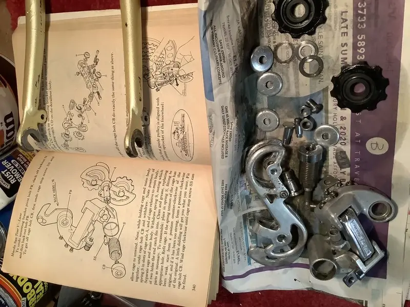

Got to put that mech back together before I lose half of it. Probably should have read the guide in Richard's Bicycle Book ("note position of spring") before I started taking it apart. No mention of the 3 washers either...

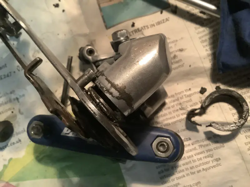

Had some fun messing about with old broken mechs. Managed to cobble together a hybrid using the 105, DX and STX mechs above. Initially I was quite excited as it looks nice and is fairly light, and i managed to put a complete mech together out of 3 incomplete ones... Unfortunately I can't see it working as there's quite a bit of play in the joint.
The photos below hopefully illustrate this. Not sure whether it's because the bits I used are knackered or because of a compatibility issue but for now I'm going to shelve this idea. You may notice that the little plastic seal is missing - the DX one was damaged and I couldn't work out a way to salvage the good one on the 105 cage - I did wonder whether this was causing the problem.
