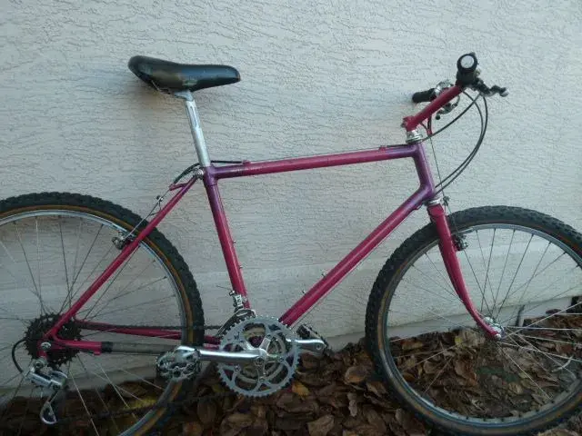

This is serial #024. The 24th frame built by Paul Brodie. Build date is October 1984.
Paul built this during the time he was working at Rocky Mountain. This custom frame
was built for a friend and was never meant for Rocky sales.
Between numbers #001 and #023 there are two additional custom frames made
by Paul for individuals outside Rocky Mountain. Even though Brodie Bikes did not exist yet,
these frames can be considered Brodie's. That makes this the 3rd Brodie frame made.
In addition, unless someone knows the whereabouts of any of the other 23 frames this is
the earliest example of Paul's work know to exist. Whether it be a Brodie or a Rocky Mountain.
Paul says those frame are out there. They were sold thru local bike stores.
Guess I'll have to keep looking.

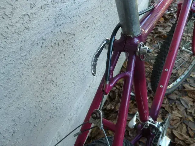

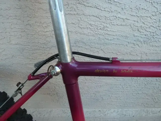

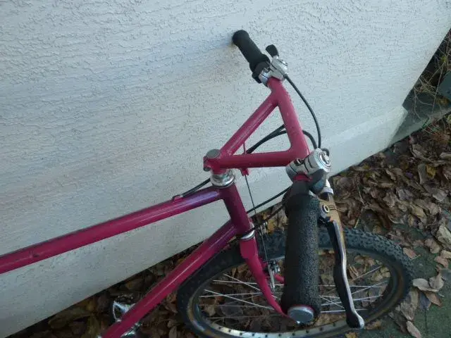

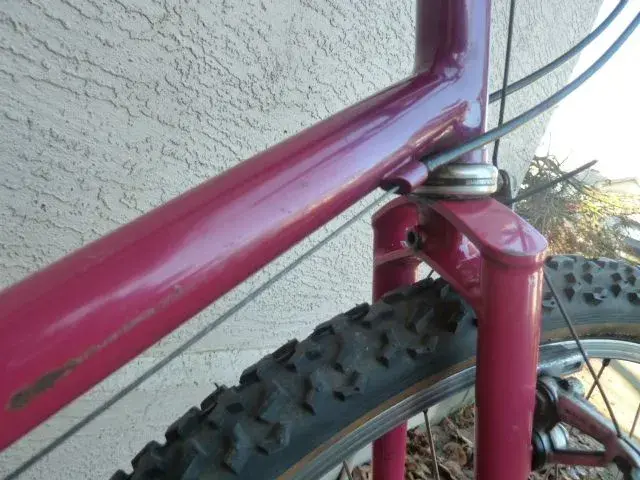

This fillet brazed frame bears some of the characteristics Paul was doing
on the first Rocky Mountain Avalanche and Tantalus frames made. Such as a sloping
top tube and overly long head tube to be found on the Avalanche. In addition it has a few one off custom touches.
The coolest being the one and only bi-plane fork Paul ever made. He admits to copying Ritchey.

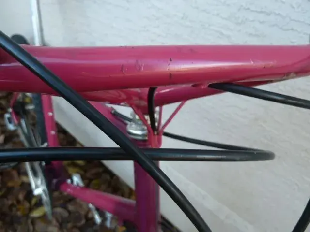

Machined aluminum plugs in the handlebar and stem. Others are the funky front and rear brake cable hangers.
A similar version of the rear hanger was used on the early Tantalus and Avalanche frames. Later documented
in Rocky literature as `Hand-Crafted BRODIE Rear Cable Hanger.'
