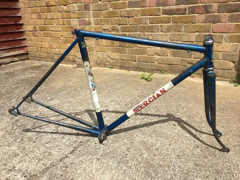

I began by giving any areas of rust a gentle brush with a small wire brush to remove any loose flakes and try and expose the metal/paint underneath. Once that was done I then went over the whole frame, including the remaining paint work, with a very fine wire wool to remove all the years of dirt and oxidisation. Once that had been achieved I gave the frame a polish with a clean cloth.
Surprisingly the frame didn’t come out too badly, with quite a lot of the original blue paint visible….

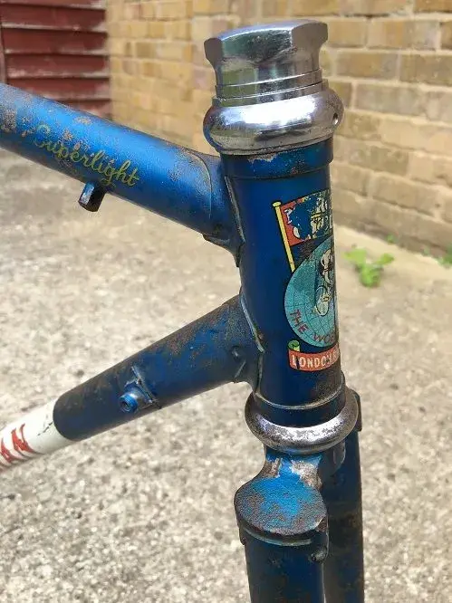

The original T.D.C. ‘Italia’ Headset was very badly rusted, so I fitted a replacement that a friend donated. Although not NOS by any means, it was still a great improvement on the original….

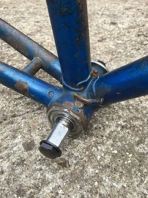

I then removed the original Stronglight Bottom Bracket, gave it a full clean and re-grease and then refitted it….
