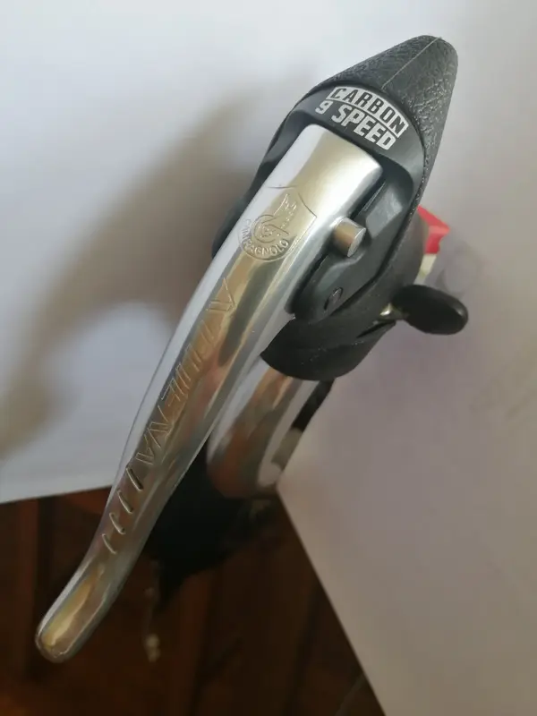

So the shifters that will be used for this project will be these 1999 Campagnolo Athena 9-speed ergo levers.
Sorry for the poor quality of the pictures but quite extraordinarily I forgot to take a simple picture of the levers prior to fitting them on the handlebar...
And that might have been caused by my mind being fully absorbed and focused on the modifications I had to perform on these levers prior to fitting them.

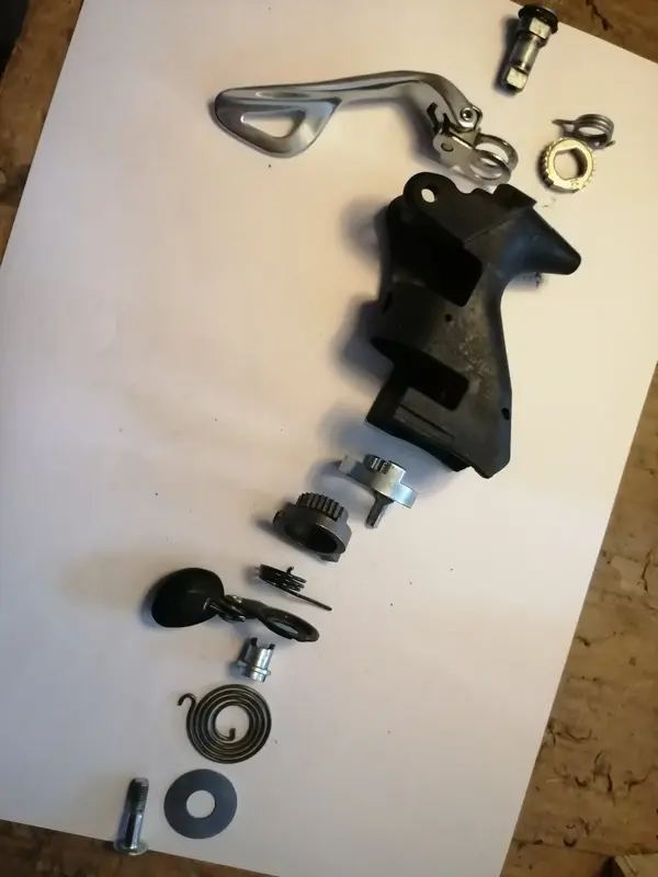

Well that was until the 9-speed Athena ergo lever got modified into a 10-speed ergo lever.
The internet is full of resources on how to carry out such upgrade from 9-speed (or even 8-speed) to 10-speed. It's not complex and with a bit of patience and curiosity anyone can do it.
Basically most parts are identical on all ergo levers from 1993 to 2008 and even more so with the BB System ergo levers from 1996. You will just need to replace a few parts of your original ergo levers with those collected from a 2000-2008 10-speed ergo levers.
There are a few variations actually based on your original ergo lever specs - with or without central ball bearings (BB System), with or without a third coil spring, etc.. But the key principles remain the same.
If you are interested in upgrading your 8 or 9-speed ergo levers to a 10-speed set-up, and would like to give it a go I would advise you first have a look at the following thread:
https://forums.thepaceline.net/showthread.php?t=250411
The parts that need to be replaced are all listed with their reference numbers.
You could also download and print the Campagnolo spare part catalogues from the relevant year for your 8-speed or 9-speed ergo levers as well as the 2008 catalogue for the parts to be collected. That will provide visual clarity on the internal mechanics and especially the parts that need replacing.
Campagnolo spare part catalogues are available on Campagnolo official website:
https://www.campagnolo.com/NL/en/Support/download
You could also have a look at the 2008 ergo disassembly tutorial:
But basically here is how it looks once everything is disassembled with the new 10-speed parts prior to reassembling.

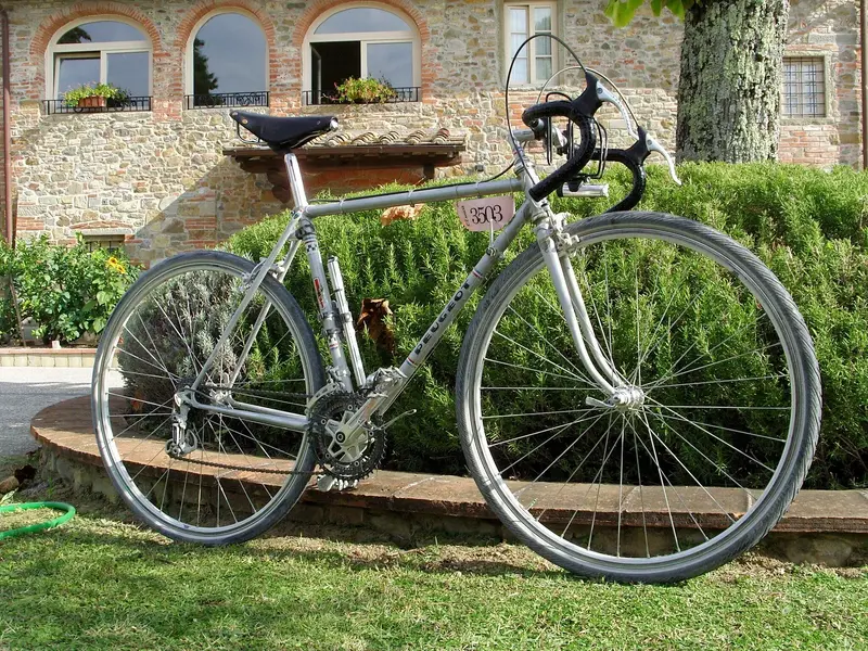

Actually this is my second vintage Peugeot gravel bike. I built my first one almost a decade ago for Eroica 2014. As the rules require strict pre-1987 setup it was fitted with standard downtube gear shifters... Although all the componentry was from Campy 😁
Here it is...

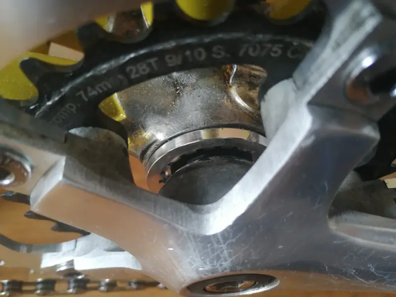

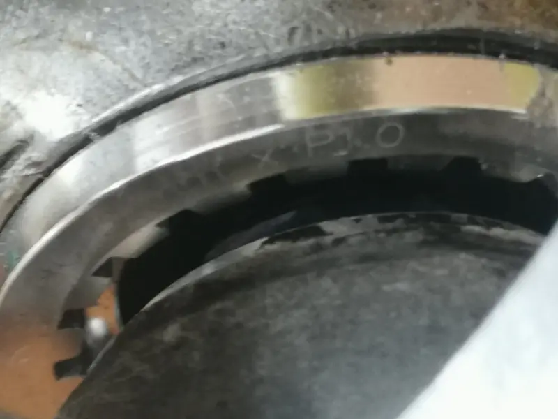

That's how I reversed to a more conventional setup with perfectly round 38/28t chainrings... whilst still keeping the 110/74 crankset and 107mm spindle.
Below are a few pictures showing how tight is the gap between the crankset and the bottom bracket cup... Mainly due to a very short spindle.
With a closer look on the crank basis one can see that the edge has been milled to avoid the crank rubbing against the cup.
