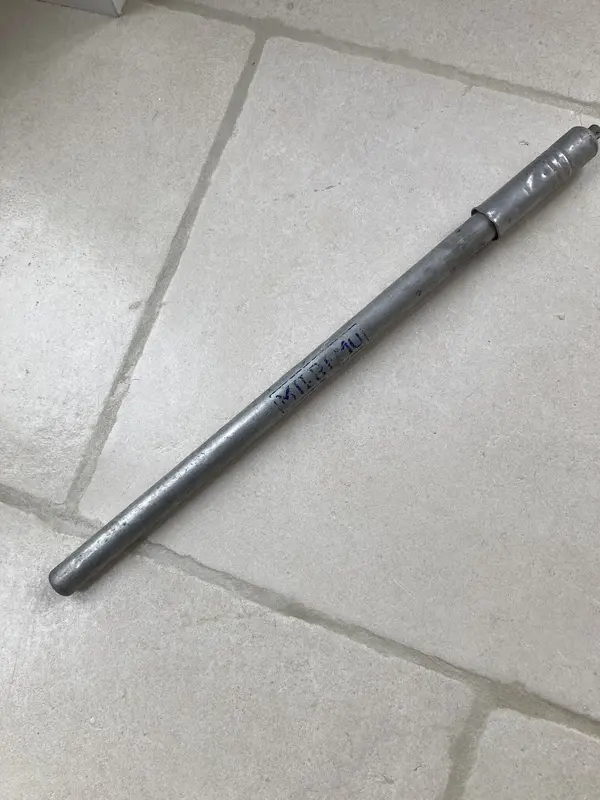

Meanwhile, snagged this. Battered but lovely Milremo pump. Needs new washers but that should be simple enough ha ha

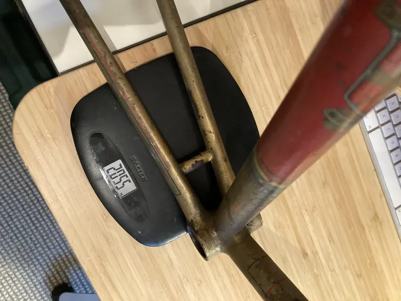

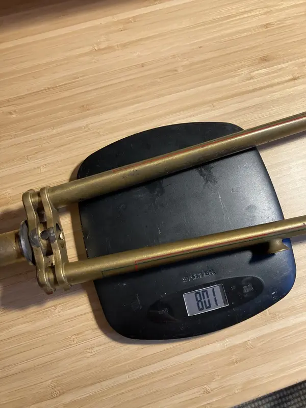

Took the chance to do a weigh in.
Frame, even with the post, is lighter than some of my mid-90’s Columbus bikes ha ha

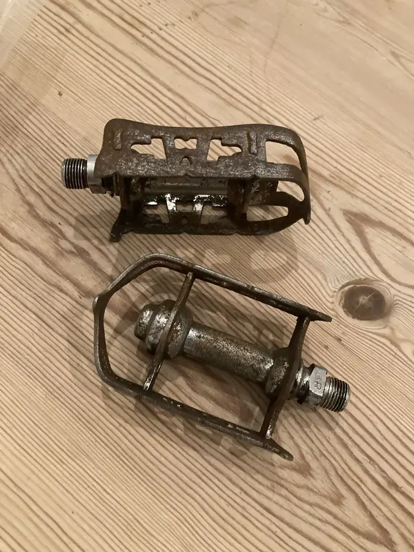

Milremo bargain pedals for people too poor for Allez!

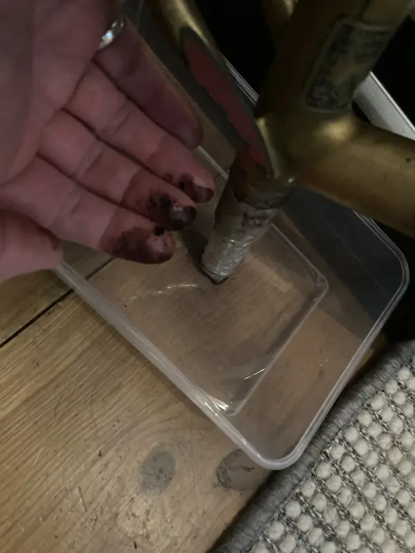

And the seat pin has been soaking in vinegar which the seat tube I filled up with and sealed since Sunday… and something is starting to work lol
Fuuuuuuuuuuuuucckkkkkk
Bumped into the frame.
The seal failed, cue a high pressure spray of vinegar, plus-gas and rust all up one wall and the ceiling and me.
Indoors.
Not a garage indoors.
Indoors the house.
This weekend I will now be mostly redecorating.
And the feckety fecking seat pin is still stuck. Fml.
