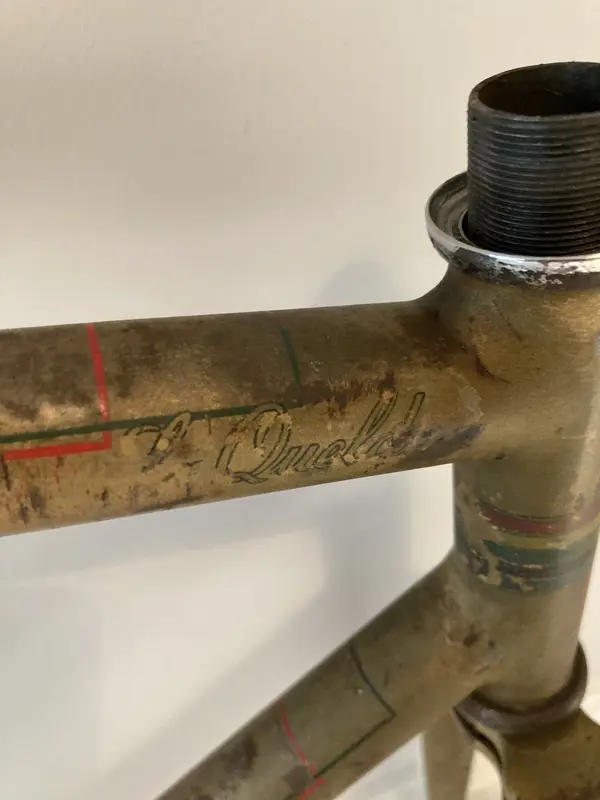

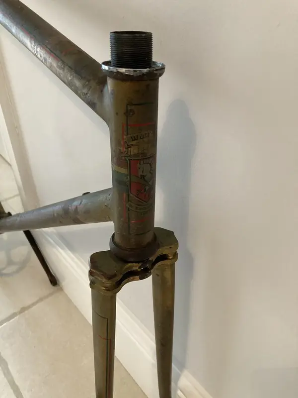

1948 Holdsworth La Quelda, Bill Hurlow stamped, completely original :)
fiveSixteenths
Well, was pipped to the eBay post on this but the buyer very kindly gave me first refusal if he decided he was going to pass it on.
Que two months later and now it has a new owner. Which I think makes me just the third.
Last owner began stripping it down to clean and very, very gently polish as the frame and fork paintwork - while showing its 73 years - is incredibly amazing. Box lining is lovely. So nothing to touch there, leaving that exactly as it is.

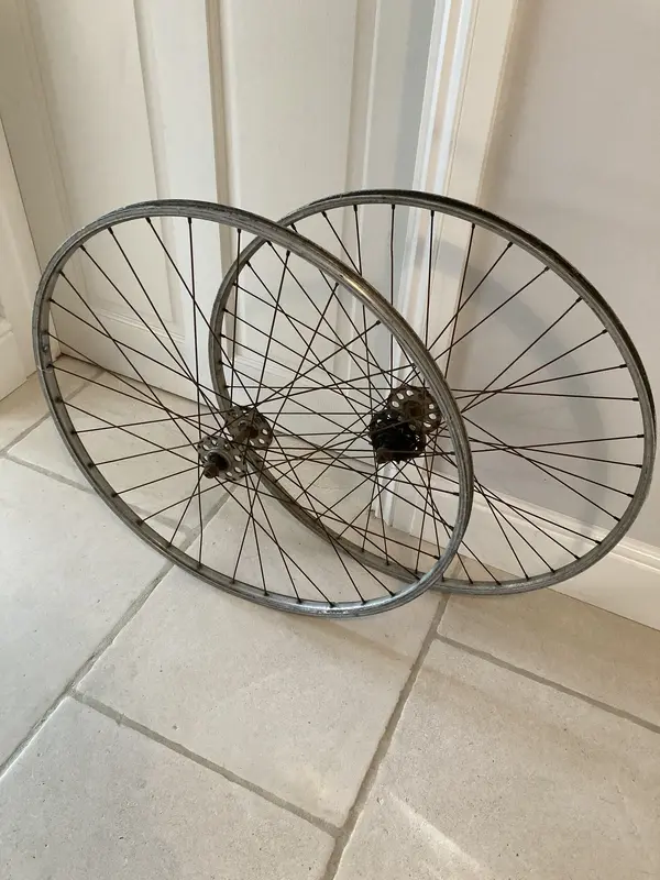

The wheel set is likely shot but will have a better look if it can be rescued. Maybe a new spokes rebuild. High-flange hubs, can’t see any stamps on the rims yet.

Wow, looks amazingly original. Looks perfect for an oily rag build with all (or at least most) of its original parts. I agree with you that the wheels should have some new spokes. I used modern-gauge double-butted stainless spokes on my 50s Normandy/Fiamme wheelset and they don’t look out of place and have been really reliable. Just check you can get a modern 2mm spoke through the holes in the hub before you buy them though; you don’t really want to sit there enlarging all the holes…
fiveSixteenths
Thanks both! and for the tips also on spokes. Think a quick trip down to see Ricki at Pankhurst might be an idea also to see what he has lurking in the shop.

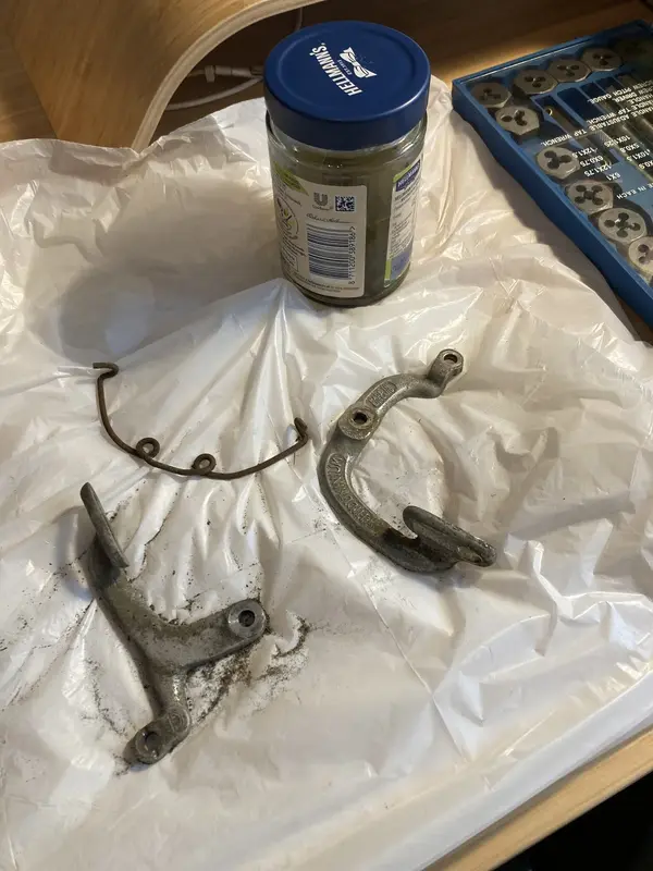

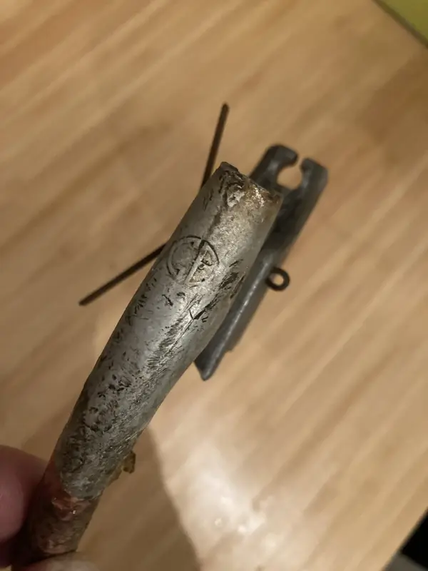

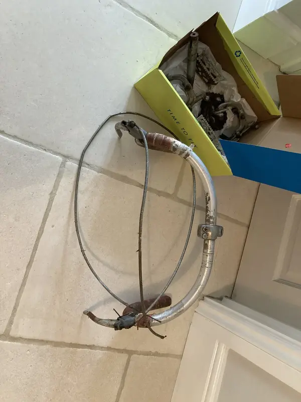

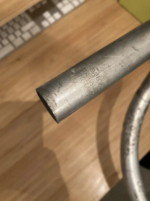

Ha ha, couldn’t resist having a go at it!
Bar tape had turned into a kind of plaster of Paris under the velox type stuff but underneath looks like the Bailey Stratelite bars were chromed.
Managed to get the levers off - one with a cotter-pin bodge-repair so might need a replacement!
Then the stem (which unfortunately is cracked)… virtually welded onto a shim. Lots of gentle persuasion and we’re clear.
Bars are quite marked so am thinking black cloth covering.
That’ll do for now!
