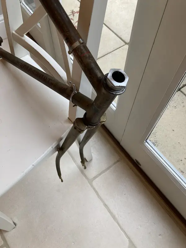

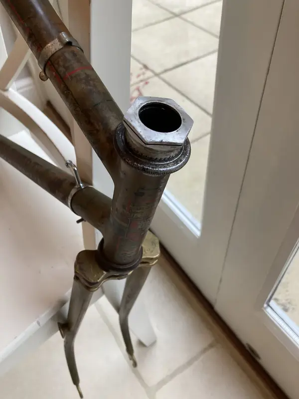

Refitted the Lytaloy headset just now.
Cleaned the cups (am not going to do anything with them, the chrome on the outsides is pretty shot but the patina is too good to touch), amazing condition inside and hardly any brineling under the old grease.
The last owner had saved all the bearings (what a super-star) so quick clean up of those, new grease, and everything is good.

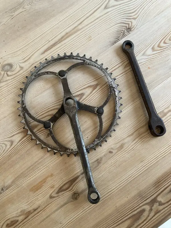

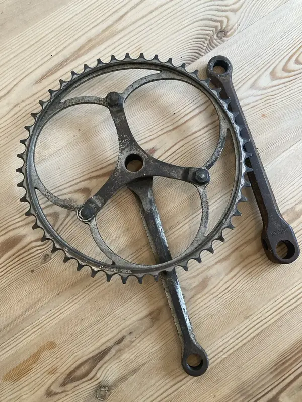

Pins are about and are salvageable, Durax chainset cleaned up and teeth look good (am I right? Hardly appear to be worn to me?) and the gunk preserved some of the plating quite well.
Next job, TDC bb to come out.

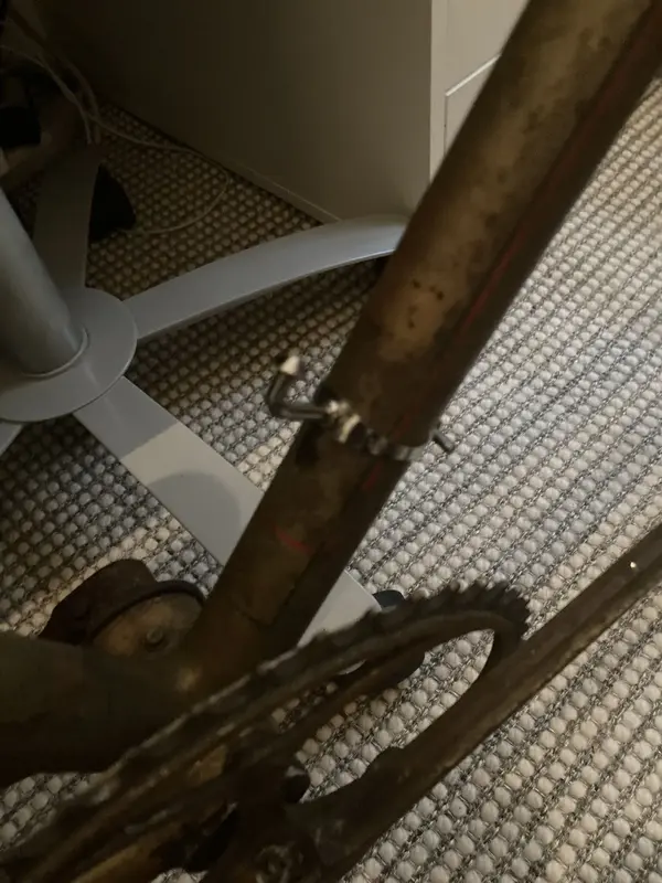

BB came out without any effort, remarkable. Cleaned up its in amazing condition also.
Slight ‘snag’ is the plan to use the bb end to flood the seat tube with plus gas to try and free the post… and the reason for the bb quality is a kind of shim inside the bb casting action as a shield of sorts. Never seen this before. Not sure if should / try and remove it? Will have a look later to see if there’s a join (so if it’s ‘sprung’ in.)
Hmm.
