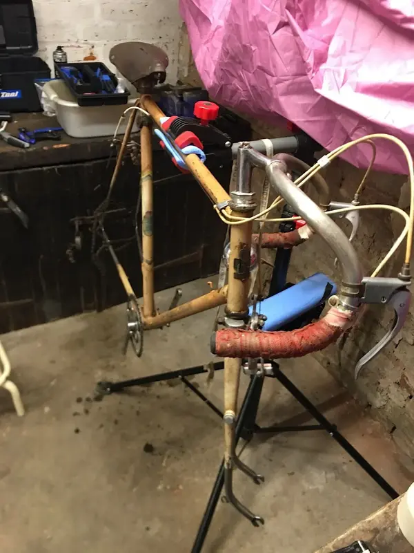

Well.....I'm all for preserving history...but. this will be the only original Claud that really fits my 34" inside leg. So, I'm going to want to ride it. A lot of the running gear is not original although near period, so I won’t be too precious about that.
If it is what I think it is I do have some very very fine period kit sitting waiting in wrapped in oil rags for something just like this.
So, I think it’s going to have to be nothing less than a very top end full restoration.
Re-chromed, then this one will definitely be re-sprayed by the only sprayer I can trust to do exactly what I want (me)
I will also look at making the decals as water slides not vinyl.
Kit list will include
1949 Clement Albione 27” rims
1950 Cinelli #1 stem
Probably a Simplex rear derailleur, with 4 speed freewheel
A set of British Hubs Airlite
Birmalux seat post
Brooks Swallow saddle
Chatter lea cranks & pedals
You get the idea…… 8)

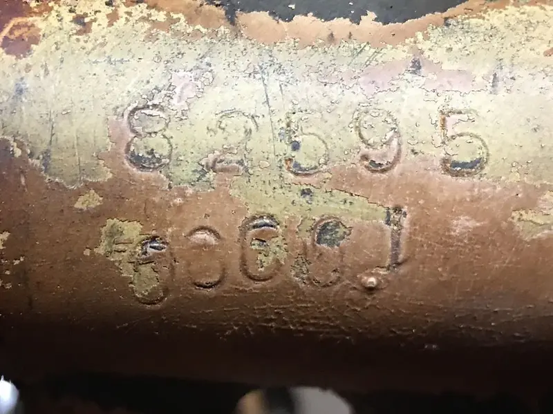

Well it’s arrived! :D
And I’m happy to confirm the two things I wanted to check with my own eyes;
1. The frame number, which of course had been read incorrectly, it’s actually 82595. Which makes more sense as 595 fits better with a February build count than 395.
2. The B.B. is a British ISO and not a pre-war Chater Lea job (which might have pointed towards 1938 rather than ‘48
Also the flat metal Olympic head badge (very much circa 1948) seem to have its original rivets....
More detailed strip down and catalogue at the weekend. :D
