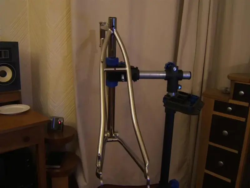

Keyhole stays, top tube cable routings, never had canti bosses. That's definitely a late 90's frame in my view.

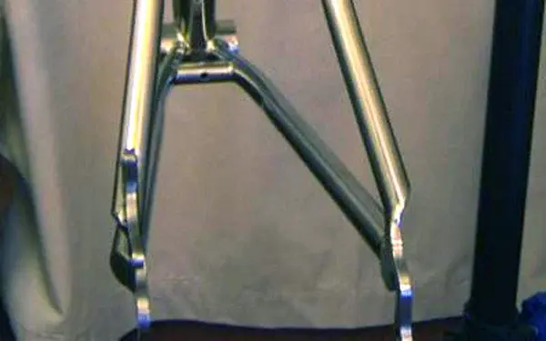

that pic of the stays is a bit mis-leading :? in reality they are very straight much like a road bike and only kick out in the last 4" or so

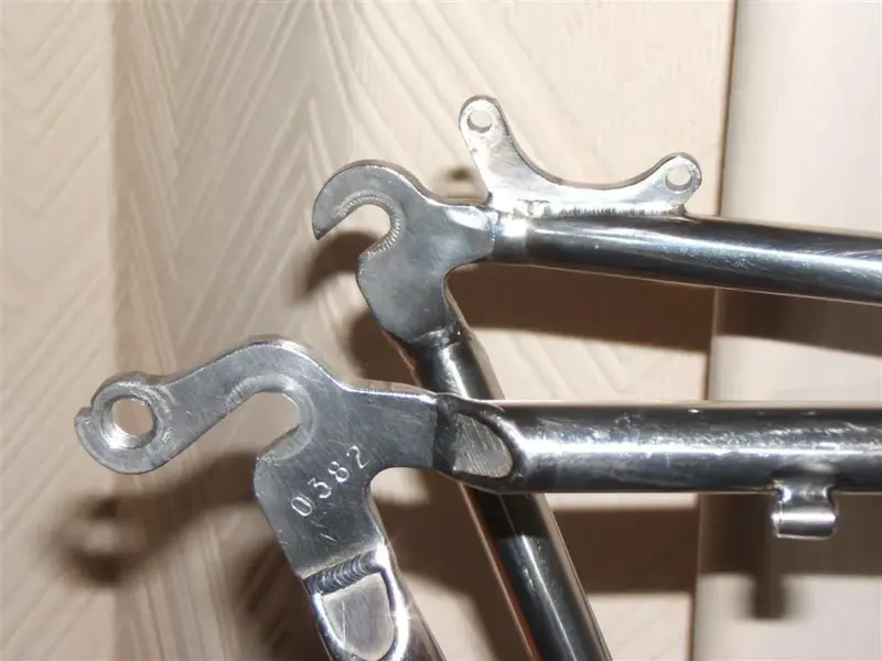

It may be my eyes or the camera angle (but I don't think so) but that LH dropout looks all bent to buggery - the inside of the dropout and the inside of the caliper mount should be in the same plane (and at right angles to the wheel spindle) and that doesn't look as if they are (the dropout itself looks bent inwards).
I've taken that on board Andy and phoned the mechanic[bikes left with him]
He'll look at it over the weekend and use the hope tool to see whats amiss
I have complete confidence in this mechanic,he does all the couriers bikes and some of the local road clubs.
I do wish the fellow that sold it had been a bit more upfront about these issues.But being gumtree theres not a lot i can do. :?
The welding on this really is excellent ,overall its a nice looking frame,possible with some road heritage so i will go to just about any length to make it operational.
The actual brake mount looks bent in that pic too. What happens if you put a straight edge across the two brake mount holes and the dropout?
TBH i didnt notice anything amiss with the dropouts,but i suppose if it were bent inwards it would indeed look like that.
Its also possible that the frame was meant for 135mm spacing and the original owner forced it in for a 130mm hub :?
Anyway,all these points i've taken on board and when im better and can visit the shop [probably monday] then we can see how were going to rectify it
