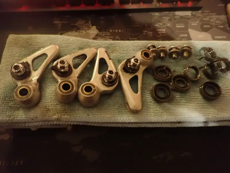

In the mean time I've deep cleaned the XT canti's
Before...
After...
Before...

After drying them out I fitted the cantis and assembled the straddle wires in readiness for the final assembly, going with Ritchey cold weather pads, red wouldn't be my first choice but it seems to work well with the bottle cage bolts and little flashes of red in some of the decals, will swap for blacks in the spring mind you. Wouldn't mind some black cantilevers either 😉
