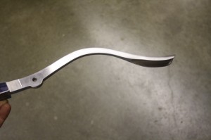

Paul Brodie - Building the Whippet Part III - Brake Lever
Following on from his previous articles Paul Brodie kindly sent us a further article detailing the rebuild of the 1888 Whippet at Flashback Fabrications. Enjoy :D Hi. Paul Brodie here. NAHBS is coming up FAST, and I still have a LOT to do on the Whippet! I have never made so many parts for just one bike. In this tour of my shop, I'll show you how the brake lever was created by copying the original in the photo below. In all, it took about 2 days > I wanted to carve it from solid, with no welding. I should have used a 1X3" steel flatbar, but only had 1X2" on my shelf. So, I cut a notch > This is my big torch, with a "rose-bud" tip... it generates a lot of heat > The bar is supported in the arbor press and heated > It gets...
