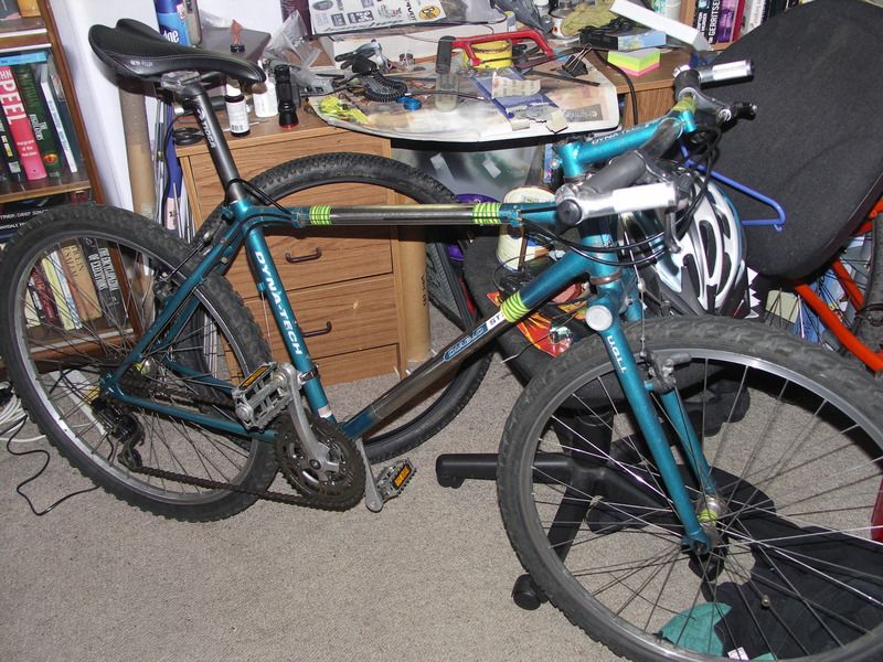

1994 Dynatech Diablo STX. DONE (More or less..)FINAL PICS
doctorstewie
It's blue and silver...ish and it's got tubes of Titanium.
Best of all, it's got an UGLI.
It's a bit knackered, and my restoration skills aren't the best but I am going to see what I can do with it before Iconoclassic.
Good bits:
Almost catalogue spec, everything is there apart from tyres, seatpost and saddle. And the rear wheel.
It's got nice stubby bar ends that look in keeping with the bike.
it's Ti.
Did I mention the fork?
It doesn't weigh much ( apart from the rear wheel. I dunno about former soviet strategic ti, this just feels like it fell off the back of a Russian tractor)
Bad bits:
The electrical tape is covering the bits where the laquer/big stickers have been peeled away. This will need sorting. I have a cunning plan.
The handlebar is steel, and rusty. Also under electrical tape.
The paint is peeling off the stem. Again, hidden by tape.
Dent in the seat tube ( nothing I can do about it and it doesn't look serious. )
Joke rear mech.
Rear wheel made of collapsed matter in the heart of a soviet military installation.
Some genius has tried to paint the rear cantis using a rattlecan and no masking. :facepalm:
All in all it looks like I am moaning, but really I am not. There's nothing there I can't do SOMETHING about and it's going to be my towpath / gentle ride with guests bike.
The frame is fine with no cracks or debonding, same with the fork and most of the original stuff is there, anything that isn't can be replaced with what I have in stock or very cheaply.
So yes, looking forward to getting this one sorted and ridden :-)

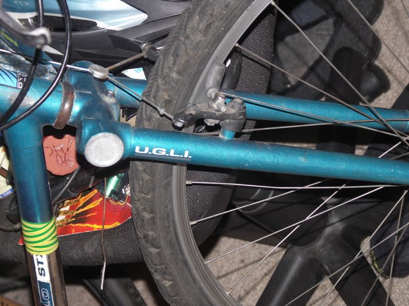

The tape...

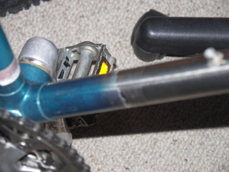

And what's under it:
and:
That fork: the end cap is a bit oxidised - any suggestions?

Here's the rest of the plan:
Clean and polish everything on it.
Strip the fadey bit, airbrush a new one then cover the top and down tubes with Helicopter Tape.
New Decals.
New stem, preferably a matching one.
New bars ( something cheap, light and straight: these are chrome plated steel and all rusty )
New rear mech: I have a 94 LX one that will do nicely.
Wheels from Rampage ( a nice and cheap Bonty set )
Pedals: I have a nice set of Wellgos with clips and straps, or possibly a pair of SPDs...
A period Crudcatcher and maybe, just maybe a Race Guard.
The chainset, front mech, shifters, levers and canti's are all fine, or will be after a bit of a clean.
The Tioga seatpost really suits it, and the Madison saddle is comfy if a little modern.
I'll probably stick some Splashbacks or the tyres that Little Skink put on his - whitewall semi slicks on it, it doesn't need full knobblies and I would like it to be nice and light.
So, here I go with a scalpel on the Ti tubes..wish me luck, I'm going in.

I had a quick experimental peel tonight and it looks like I am just going to have to sand it: so I had a very gentle go with some 1200 grade wet and dry and I think it's going to take some time :-) I'll be going over it with the finest abrasive I can find - perhaps even micromesh. I'll have to bone up on polishing ti.
