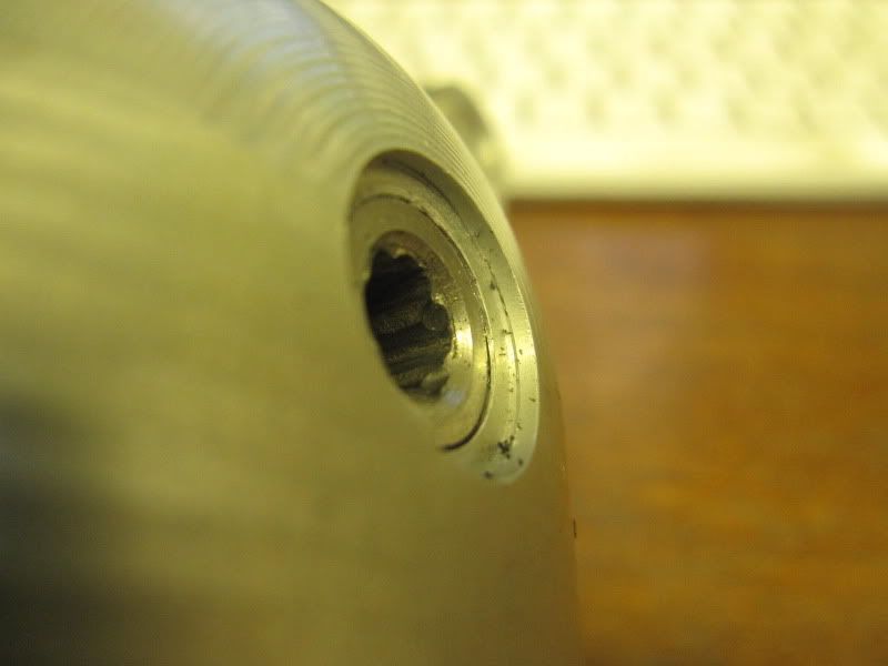

To get the cranks/bolt bit right, set the bolt in the BB spindle so that the thread is just hidden:
Then offer the crank up to the end of the bolt and screw in clockwise. The outside face of the bolt should line up with the shallow counterbore on the crank:
As for torque...I have no idea, but it certainly doesn't need to be as tight as a standard bolt. That would be pretty hard anyway as the thread is very coarse in comparison. I just use the longer end of a standard 6mm AK by hand, never had one come loose.

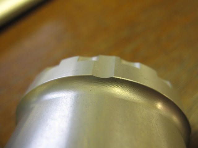

Watch out on the chainring side when fitting, as the inner ring ring bolts need to clear through the machined reliefs on the cup:
