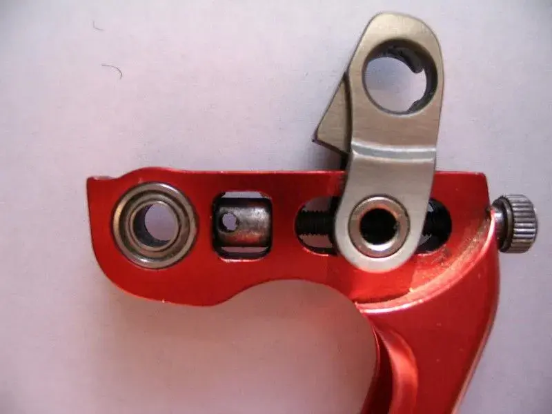

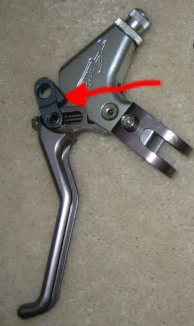

researched these a while ago… later models have "v-chip" for v-brakes. you could also get the upgrade part directly from Avid at the time to modify existing units.
never found a set, and i only got a set without. ended up using Problem Solver travel-agents to get my set to work with V's on the Cirrus.
here are a couple of pics of the part in question i collected at the time while researching. ;) not really sure how that little added piece of metal increased the pull. i've read that it didn't improve the feel a whole lot.

8) Thanks RockiMtn ,that confirms my thoughts that the levers are indeed canti.. ;)
