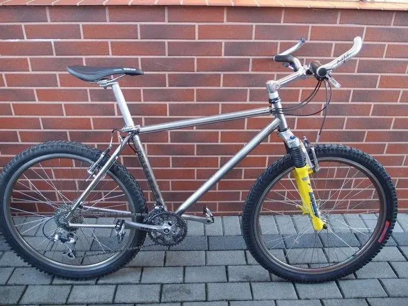

One had appeared a while back on Polish e-bay, frame number F4I 00636 but it was described as having loose or unsafe tubes….
Then back in January 2019 ‘Stompy’ an ex-pat, posted this from Croatia; Claud Butler titanium(?) info/identification
A Titanius with BB stamp F4I 00632

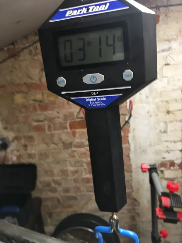

It weighs in at a respectable 3lb 14oz…. in comparison a ’97 Cape Wrath in Cro-Mo weighs 5lb 5oz
