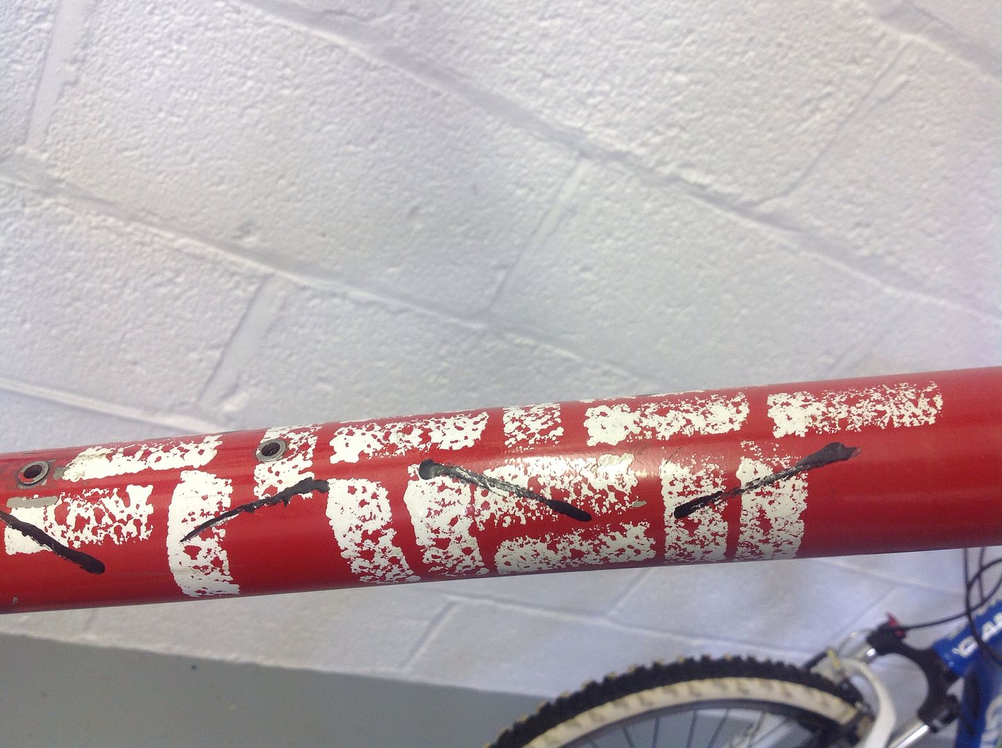

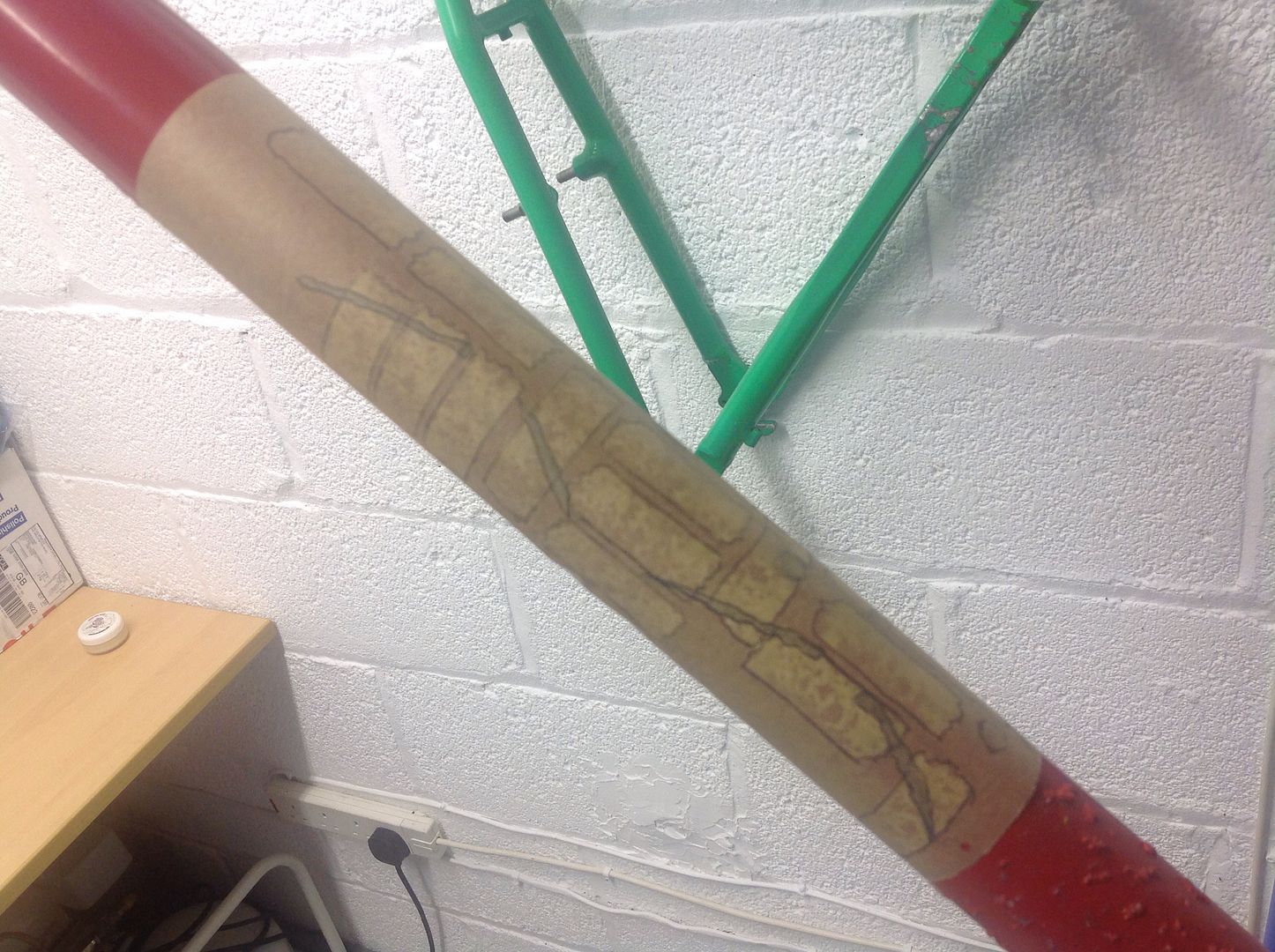

This time it will undergo a full repaint, Custom Paints red paint has been ordered, will photograph and trace the original custom painted decals before sanding the frame back to replicate.

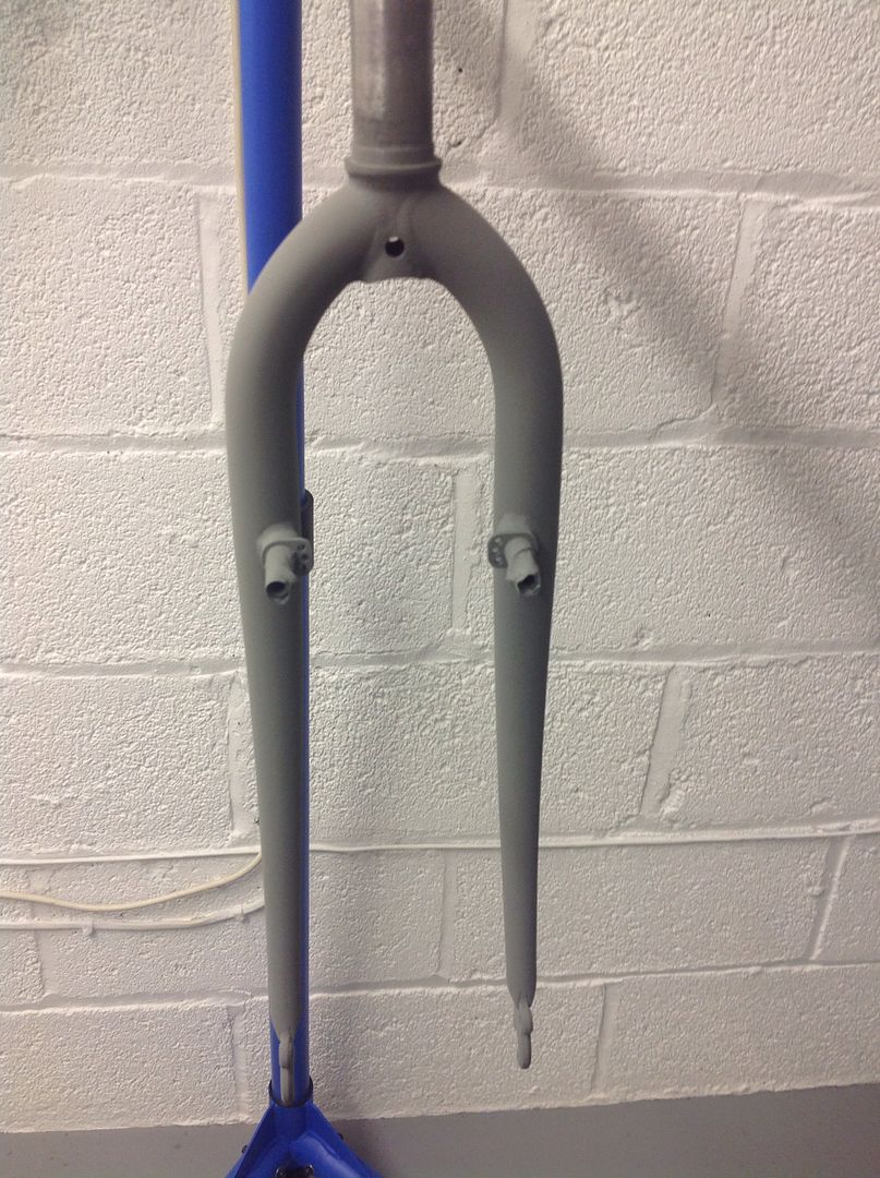

Forks sanded back and primed today 8)

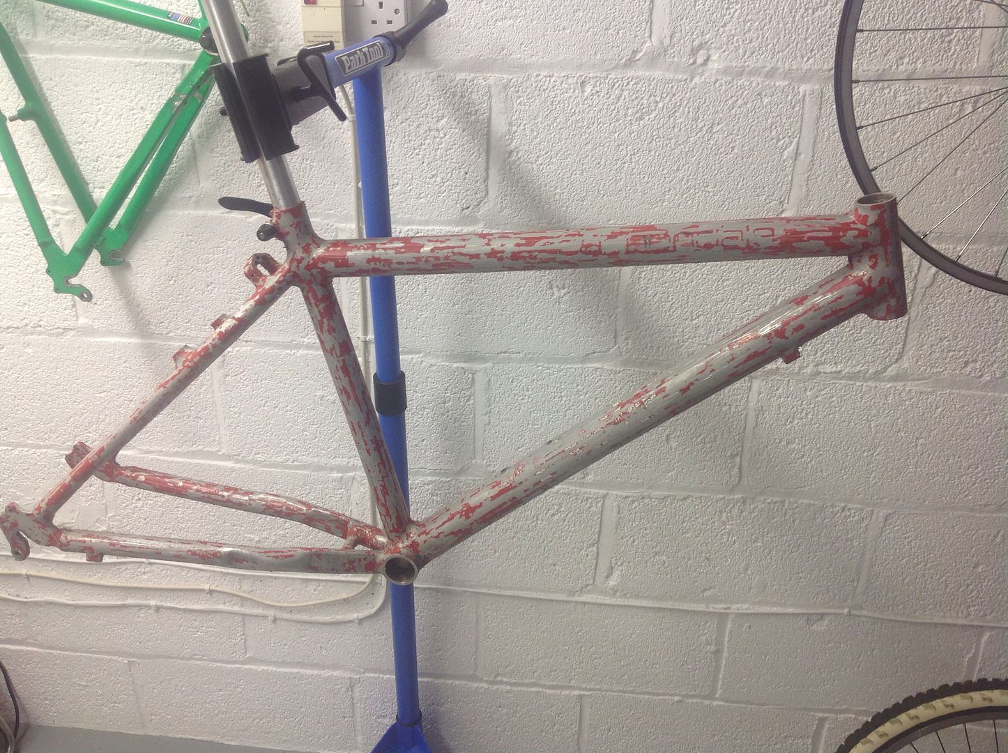

Hand painted graphics traced and a fat couple of coats of paint stripper have gone on the frame earlier, tough paint on this ol' girl, will have to finish off next year now.

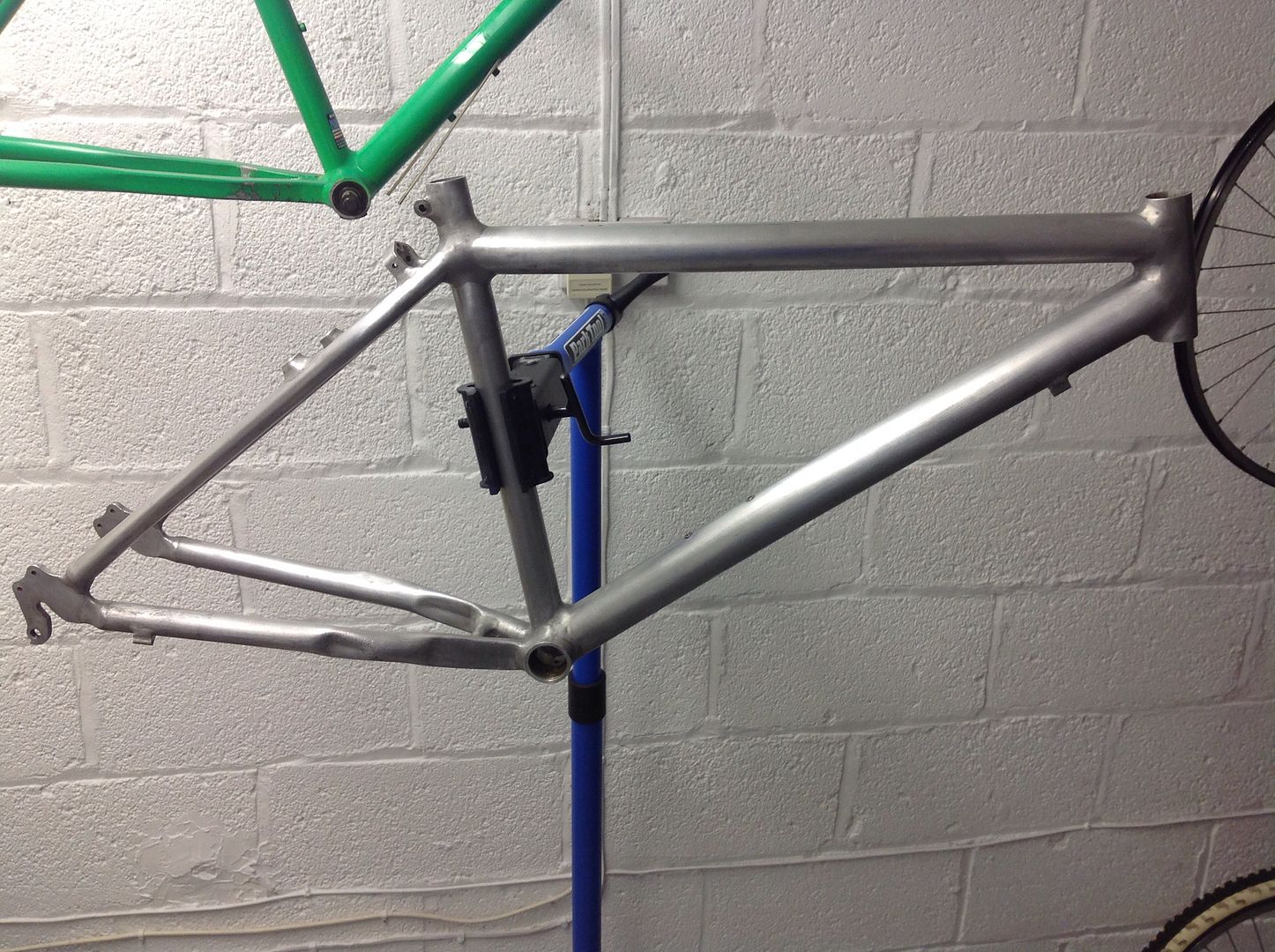

She's naked.... :wink:

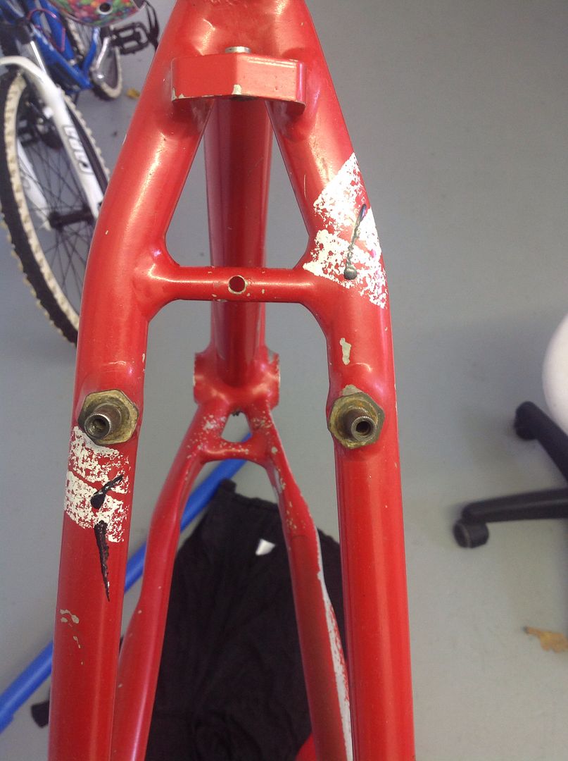

All looks in great condition, apart from a few scars from chain slap and suck and a light top tube cable rub which I will use aluminium filler to correct before priming. Will also drill out and replace all bottle cage rivnuts as one is spinning.

Not an easy work you begin :
You can find the 1988 Decals and the good matching red in vintagecannondale.com. But the white and black graphic design were made by the painter'shand and are not decals, if I remember.
You should use a roller painting for white and some black brushstroke.
I will follow your thread

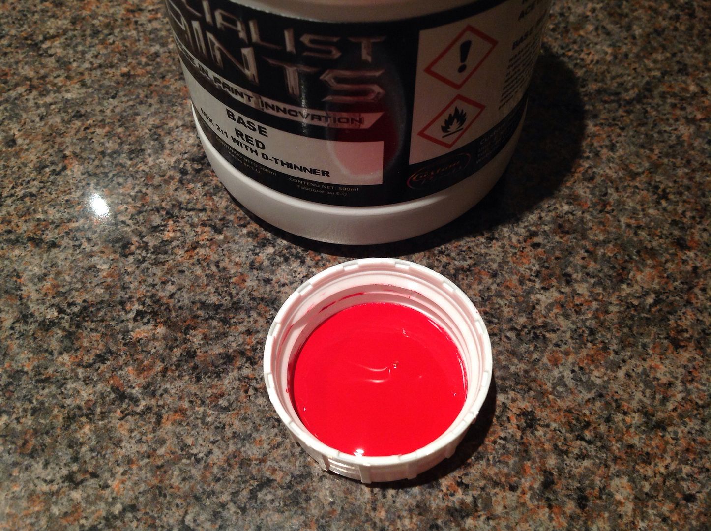

Paint arrived today crappy iPad camera doesn't do it justice but it is really vibrant, especially compared to the dull paint that came off.
24pouces, no fear decals came with the frame and custom paint has been traced and sponging will be practiced before application.
