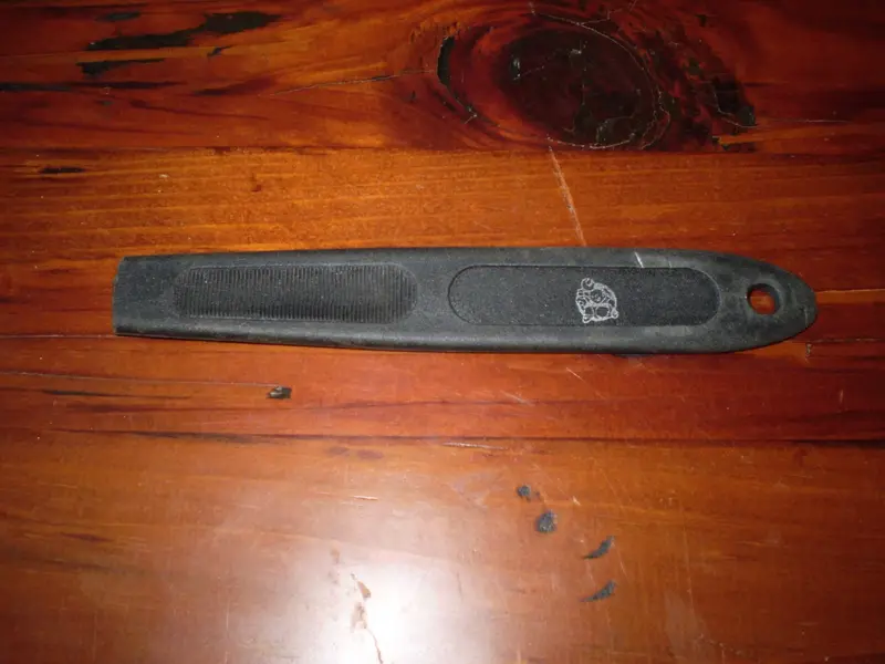

:lol: Bought some of these years ago to help fit a tubeless tyre, they were then labeled as 'Unbreakable levers'. They really hurt when they snap!! :twisted: after that i learnt to put the tyres on by hand, and have never used a lever since.
As for the fit, does the first side of the tyre go on?
