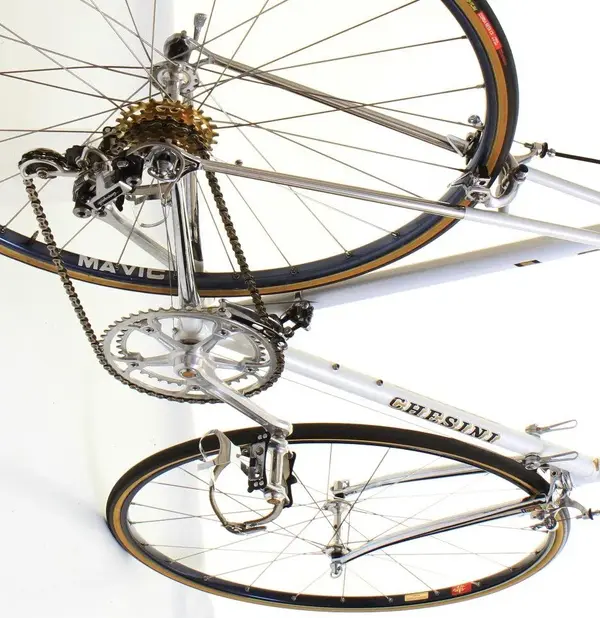

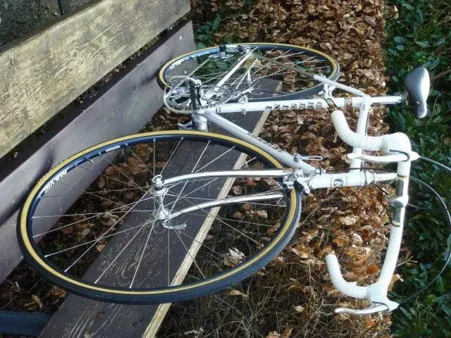

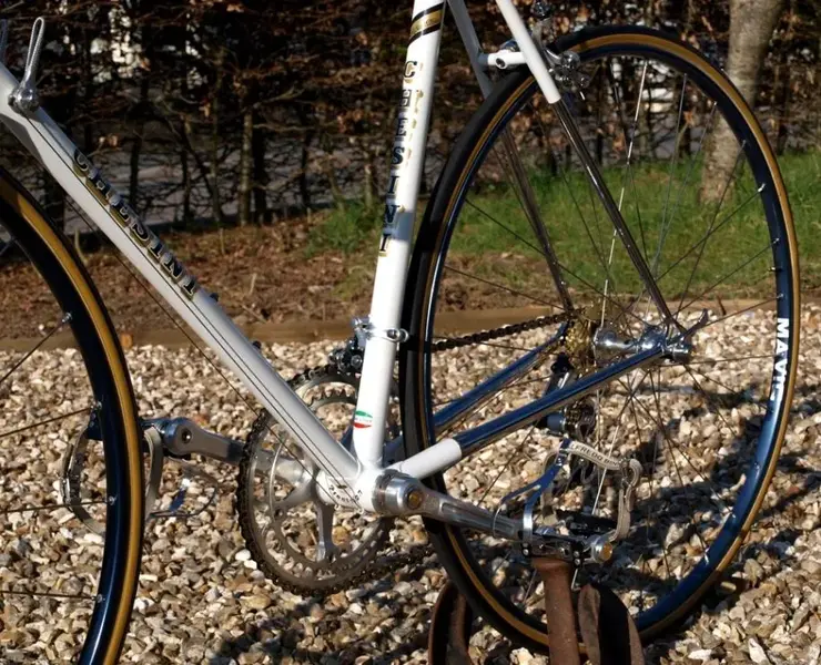

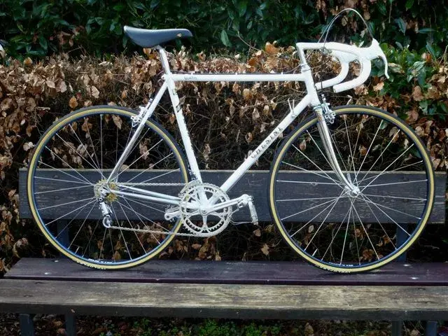

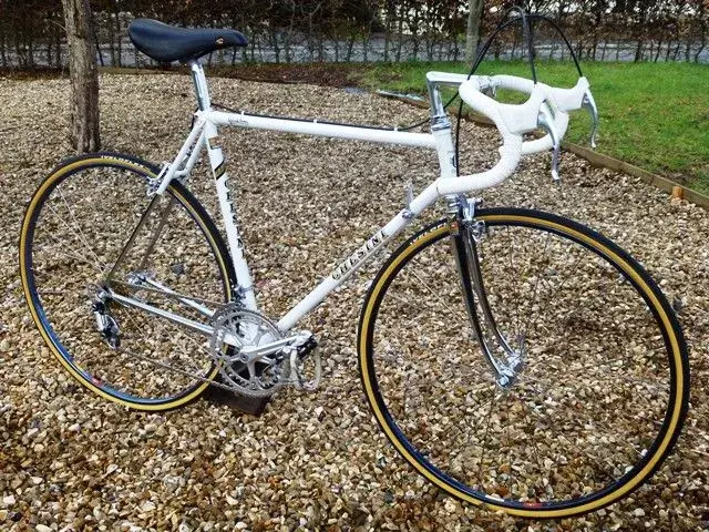

The Chesini Precision build is under way and I have chosen some of my favourite bits for this build. I am very pleased with the results, most of the parts are NOS or in excellent condition
I did make a previous post enquiry about the frame, viewtopic.php?f=12&t=338442&start=0 .

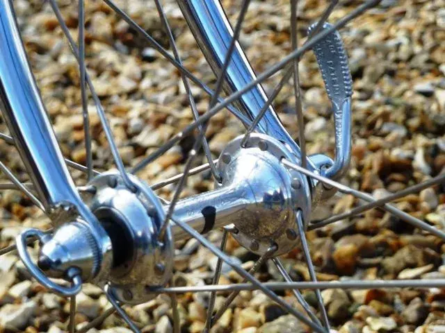

The wheels are Record hubs with Mavic SSC rims, the front has been laced with some early Sapim aero spokes and the rear uses DT Swiss BD spokes. The Veloflex Roubaix tubs have been chosen as I believe they will make a sweet ride.

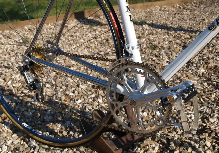

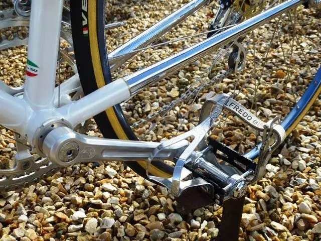

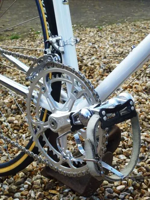

The chain set is fitted to an Omas Bottom Bracket that allows for optimising the chain line. Some super record track pedals, with a pair of re-plated 50th anniversary clips and white Binda toe straps.

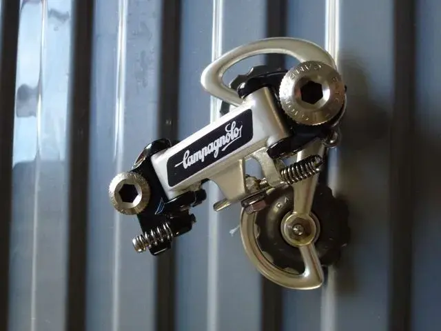

Gears are a Super record; the rear is an early version and may well be replaced with the next generation version. The levers have been drilled out and at present a Connex chain works with 6 speed Dura Ace block.

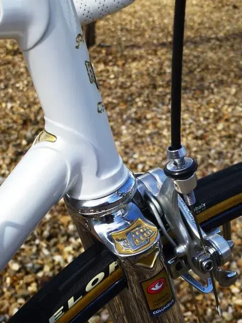

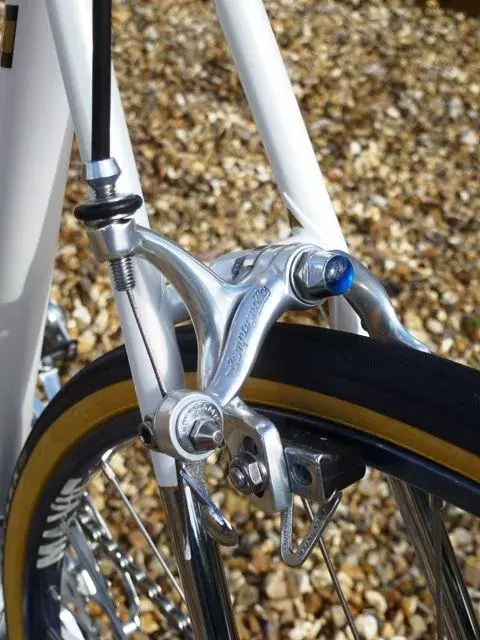

Colbato brakes chosen as I like them!
I found an old Cinelli Volare SLX that needed recovering, the underside was sound and after carefully removing the top cover without damaging the foam, a new top fitted after stretching the leather. She sits on a super record seat post.

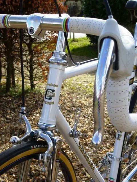

3TTT Superleggro bars and stem complete the cockpit.
