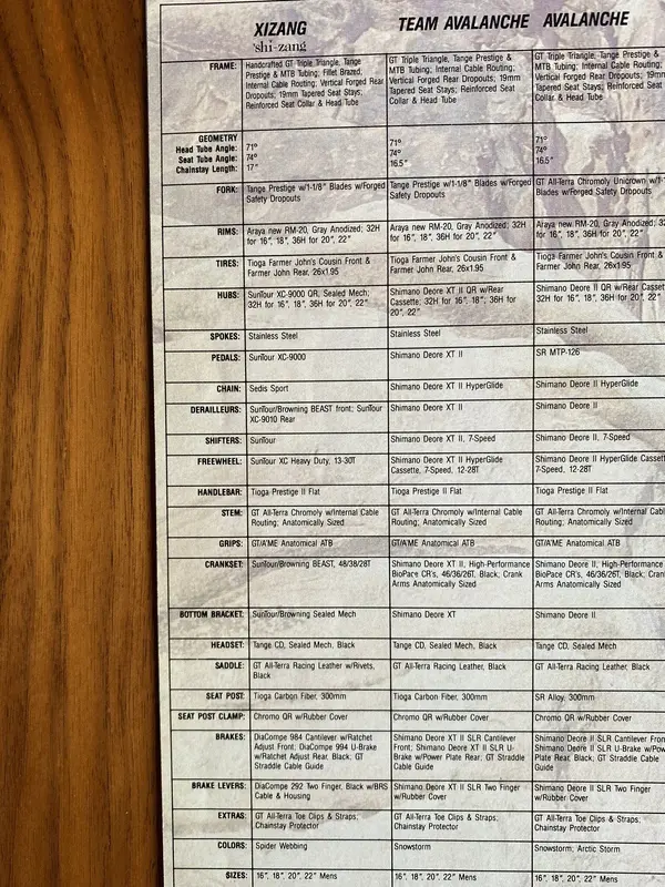

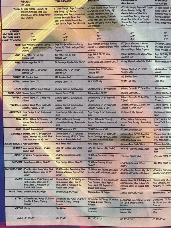

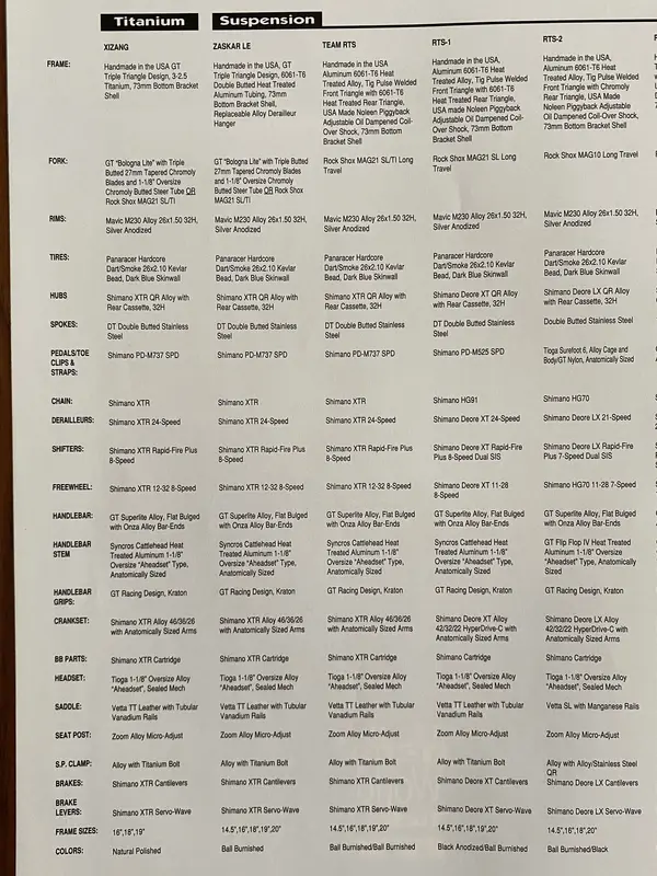

You had 3 options
Buy a frame and build with new parts (or parts you swapped off an old bike your had or raced at the time, so a frame upgrade if you like with your old kit)
Or buy a off the peg Zaskar with Xt on or a Zaskar Le that was full Xtr group, m900/m950 etc depending on the model year
The Xizang was offered as a frame set only except for
1989 when it was steel, suntour/browning/beast electric shifting accushift gearing.
1990 first year titanium framed, full Xt m750
1994 with m900 XTR and rockshox Mag 21 SLTI fork
1999 painted titanium frame, also Xtr group not sure of spec as I don’t have the catalogue
See photos below of 89-90-94 bikes in catalogue’s
