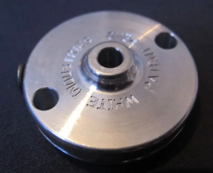

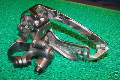

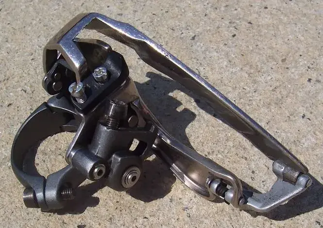

I believe the "spooler" needs a top-swing M950 or M952 front mech. I think I've got the instructions somewhere - I'll have a hunt around - but there are pictures of the installation here:
viewtopic.php?f=7&t=159226&start=10
Thanks, I had some correspondence with Adriano a couple of months ago about the cable housing but not about the mech.
The reason I believe you can use either is that I'm assuming the two pivot pins look very similar when the spring & cover plates have been removed(?); just a guess.

Sorry, I misread your question. Yes, the spooler works with either top-pull or bottom-pull. The two units are identical apart from the swing arm, which mounts to the same pins.

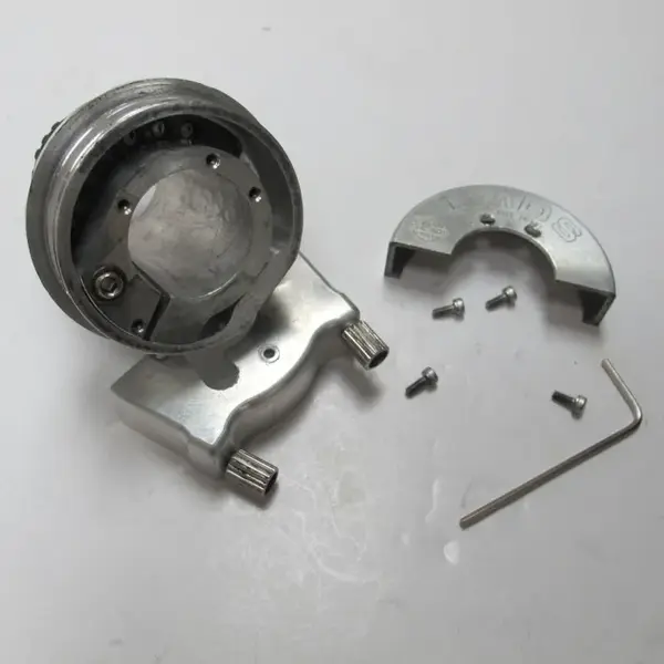

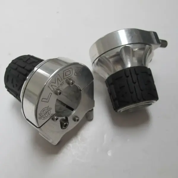

Im intrigued by those shifters :?
Can I have some more pics please :D
I've only ever had the hubs and the cranks.

I've not broken down the front shifter but you should get the idea from the rear. The (very long) cable leaves the shifter, goes around the spooler or tiny roller at the back of the rear mech and then back to the shifter. Not sure yet if it makes any difference where you start within the shifter i.e. the inner or outer cable channel; I guess we'll find out when I finally put it onto something.
