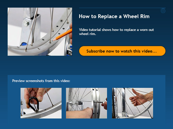

If the hubs are OK, how about just replacing the rims?
...I've never built my own wheels before so I'd have to pay a shop here to do it = tres expensive :shock:
I've never built a wheel either, but I'm not bad at truing them, so I've always wanted to give it a go.
Also, if you find a new set of rims with a similar ERD (Effective Rim Diameter), or get the same make and model rim as the old one, so you can re-use the old spokes, it simplifies it further. You can tape, or zip tie the new rim to the old one, then losen all the spokes, then move the spokes over to the new rim one at a time, that way you don't have to worry about the lacing pattern etc., it will be identical to the old wheel. Then, remove the old rim, tension the spokes and true the wheel with the new rim.
If you make a complete horlicks of the truing, you could take it to a shop to have it tensioned and trued, it will likely be cheaper than having them do the whole operation.
