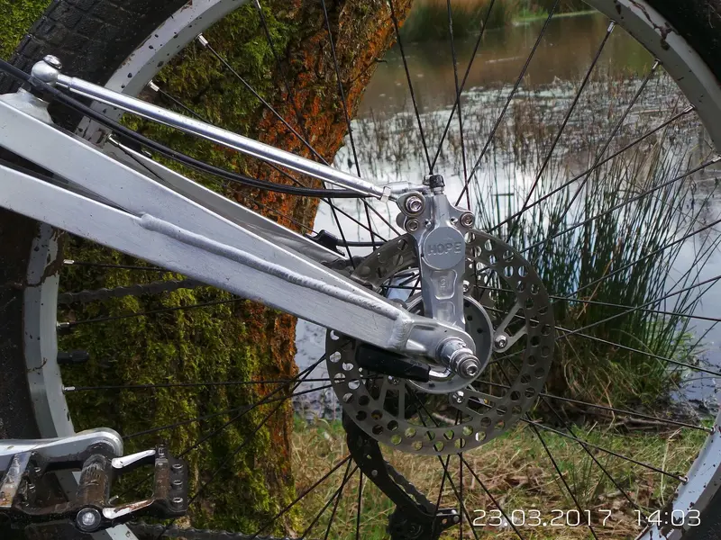

Ti glide isn't the only option for the Hope rear disc adapter. You can use the short rear axle & end cap in the XC, the same end cap will also fit a bulb but you will either need to find a rare short axle for it or shorten the original axle to suit. There's even Short axles & end caps (rare) available for the Hope Big un.
Oooh !!!
Thank you very much for that information, that's very handy to know. I have a lathe so I could easily turndown an axle to match the Hope dropout.
I don't know if it's relevant but my bolt-on Hope disc conversion isn't the same as that, it doesn't have the torsion bar running up to the canti boss, it has a ally clamp that fastens around the chainstay.
