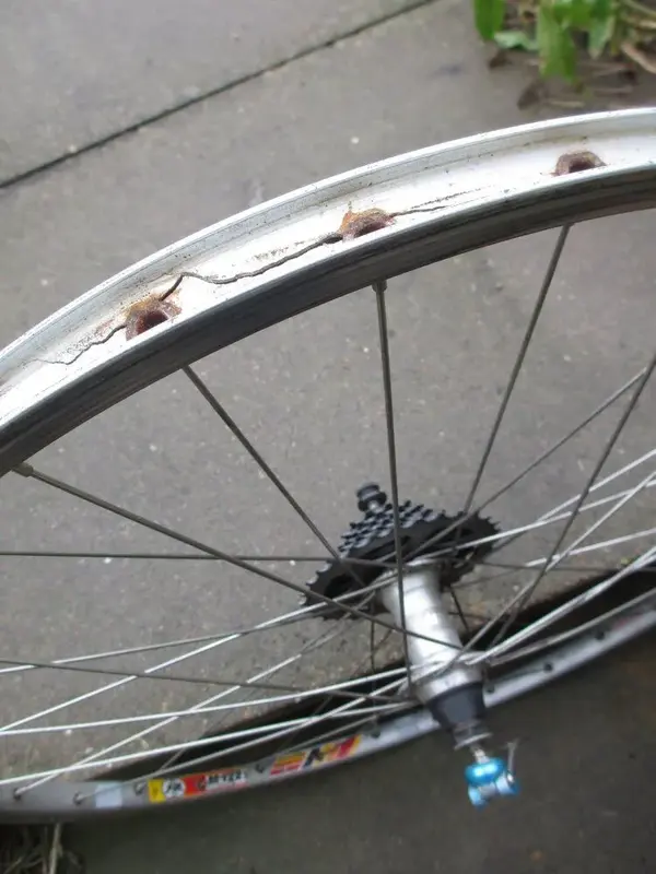

I rarely ever ever get punctures, but fate has just made a timely intervention...
Bought a new tube yesterday to fix a completely flat rear. Got home in the evening and took the wheel apart to give it a good clean and to fit the new tube. Then I noticed what's in the photos.
For a while, when using the rear brakes, there's been a juddering at one point of each rotation. A slight bulging of the rim seemed to be the culprit.

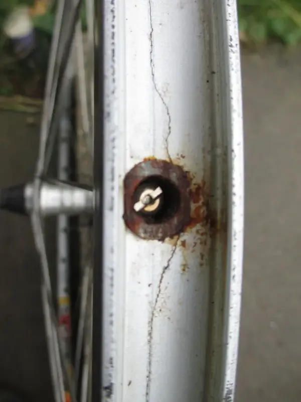

But the real scary monster causing the rim bulge is the giant spreading fissure lurking under the rim tape :shock:
All the 'eyelets' around the nipples are rusting. The main fault line crack in the rim runs at least 5 spokes and from it in each direction, there's a noticeable finer line spreading out around the whole rim.
Basically, the crack has developed and has been spreading as I've been riding – the rim is steadily splitting itself in two. I only discovered this by chance, as I rarely have any flats to repair. Wonder what state the front rim is in, with its now concave rims.
The FIRs have given rock solid service over 23 years – not bad.
It's time to get some new bits and build some wheels :xmas-big-grin:

Wow, that's quite a canyon you have there! :shock:
I know bicycle wheels are extremely strong, due to the way they're made, but what are the chances of this type of crack causing a sudden catastrophic failure, rather than slowly spreading and getting worse, as here? I threw away an old Mavic non-eyeletted rim when a crack appeared between spoke holes. It was nothing compared to this one but I wasn't prepared to risk riding it any further.
I think once a crack has appeared reire the rim what is the point in taking risks that you don't need to take. It is a bit like driving around in a car with a tyre with a bulging sidewall, you probably will be fine but there a an increased chance it will go badly wrong.
bm0p700f":26bx294k said:
I think once a crack has appeared retire the rim what is the point in taking risks that you don't need to take.
Agreed, I'm always wary of older bikes with rim brakes. How much wear has the rim had? Wheels can be expensive but if the hub and spokes are good then fitting a new rim is a far cheaper option and really quite easy.
One hell of a canyon. The more I look into it, the deeper it gets, man. A bit like the 60's B movie "Crack in the World".
Was in Halfords yesterday afternoon getting spare tubes to fix the flat (not yet knowing about the rim crack) and there was someone in with a nice Kona having repairs done. Looked like their back wheel was pretzeled. Overheard that on examination of the wobbly wheel to be repaired, the manager had spotted a crack right through the rim cross section – it was unrideable. The manager quite rightly told the guy this and that it was dangerous to ride the bike – basically he would need a new wheel. The guy was quibbling about the cost of doing this and just wanted it repaired, but quite rightly Halfords refused. The guy then wanted to ride it away. The mechanic took the back V-brakes apart so that he couldn't ride the bike. The guy tried to ride it the shop. I left the store after that because I couldn't bear to watch the inevitable happen.
I digress...
My wheel's rim walls seem thick enough, but they are being pushed out by the canyon opening up around the rim. These rims are going nowhere though. Also, the hubs are in a bad state. The wheels are about 23 yrs old now. They've seen action in the woods/hills/mountains of S & Mid Wales, traversed the high moors around Halifax and Huddersfield, spent half a dozen years in a damp cellar at my parents old place, and for last few years have been hacking back and forth commuting between Enfield and Wimbledon clocking up 165 miles a week. Time for all new wheels. And a good time to learn how to build my own.
