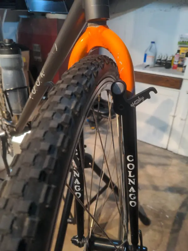

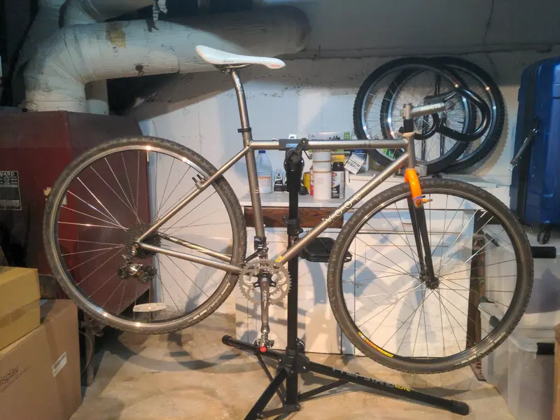

I had a pretty clear idea of what I wanted to do with this and I found much of what I wanted pretty quickly.
I had the Colnago fork chosen before I pulled the trigger on the frame and with that I wanted to throw as much Italian/Euro on this as I can with concessions made here and there of course.
FRM kit with the help of @ibbz. Headset came minus bearings direct from FRM but I found some Cane Creek bearings to fit. Hoping that it comes together to work alright. The cranks are super rad I think, supposed to be very stiff and certainly are very light. Integrated BB came with, all in nice shape.
WTB stop from @synlos ( Ti ferrule not pictured ;D )
135mm rear spacing as mentioned which makes the wheelset a bit challenging. There are hundreds of nice enough and cheap enough 100/130 wheelsets to be had but that means running a spacer which I'm not into at all so build a set it is. I'd been eyeing this old set of faded black 100/135mm 32h CK hubs to use on the green Race Lite which already has a wheelset, but I wanted these hubs to match the rest of what is going on. I was going to swap them in but alas I decided to just run the wheelset I have as is. Still wanting an old CK wheelset I was able to pick the hubs up for a very reasonable amount of money, and they even came with a spare nos freehub (not pictured.) Considering a few different hoops to mate them too. Anyone have a strong feeling to go with silver or black for the rims?
With the single downtube shifter boss on the left the plan is to run a lever there for the front while these Gevenalle levers with the thumby will manage the rear 11 cogs.
the rest of the cockpit is sorted but en route.
I bought a set of really sweet, complete w/ all hardware and hangers, nos CX Spooky cantis for a great price.
They're keeping with the Euro (Netherlands) spec and also, if you've noticed, the almost "anywhere there is text it's white" theme.
In all my research about CX bits from the late 90s to early aughts I came across another set of cantis that also fit the bill. Apparently only made from '08-'09. They're lighter with all Ti hardware/bearings/pivots and I think they look amazing. Made by Ciamillo who's better known for his road calipers. I think they're made in the US (anyone know? he's Georgia based from what I gather) but his name sure sounds Italian and the text is white enough! Also in my research I found Ciamillo is an engineer and built some titanium dolphin fin that you wear when diving and he was planning to use it to be the first person to cross the Atlantic using the fin as a human power submarine...or something.
Something like ~185g for the set with pads...just need to figure out the right pads, they have they're own pad holders (flipped 90 degrees in the photo here to lay flat.) Check the skimpy hangers with a Ti pinch bolt.

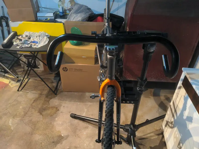

This being my first drop bar bike, I've really no idea what sort of fit is going to work so it's time to throw some stuff at the wall and see what sticks.

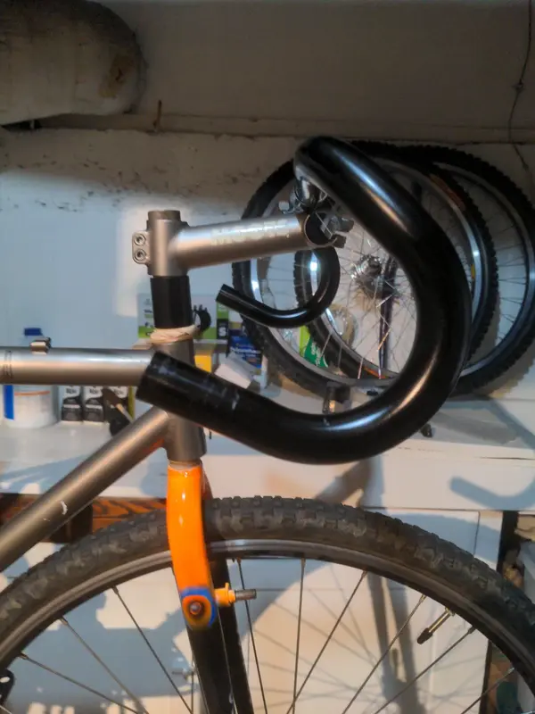

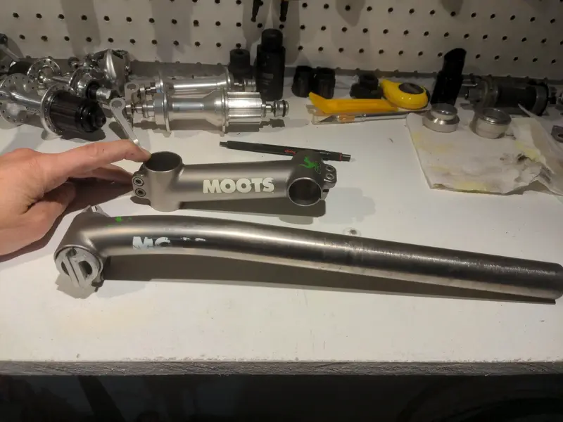

I started hunting stems a while back and came across a sweet old Moots that seemed to fit the bill. 1 1/8" steerer so it would need a shim, but 120mm with some rise sounds about right.
Searching craigslist in vicinity of where the stuff is made is a worthwhile endeavor. The seatpost popped up not long after the Colorado found stem and so they're mates now.
I thought there was an ocean of variety in mtb bars, drop bars is an absolute abyss. The stem with a 25.4mm clamp narrows things considerably but I think I'm ok with that, I don't need the 560mm wide bars that seem to be everywhere on modern "gravel" rigs. Nitto/ Rene Herse has a nice looking set that I almost went for until I found these Nitto/Fairweather (Blue Lug Japan) for a fraction of the price of the Rene's. These are shallow in the drops and short in the reach. I figure better to start a little cramped if anything and stretch out the reach in time if I need to.
My dreams were crushed though, there is no way a drop bar (at least not the one I have) is getting threaded in there. I tried tire levers, a stack of coins, grease, simple green, grunting... no dice. Turns out this stem with 2 clamp bolts is ~4mm wider than a couple other 25.4mm stems I have around hence my woes.
I feel awfully committed at this point with the matching post and the cockpit plan, so I'm now looking to swap this stem for a Moots, road version which has scalloped edges and a single bolt though finding on of those seems a stretch so maybe just go for one with a removeable face plate.
If I hate the drops all's not lost.

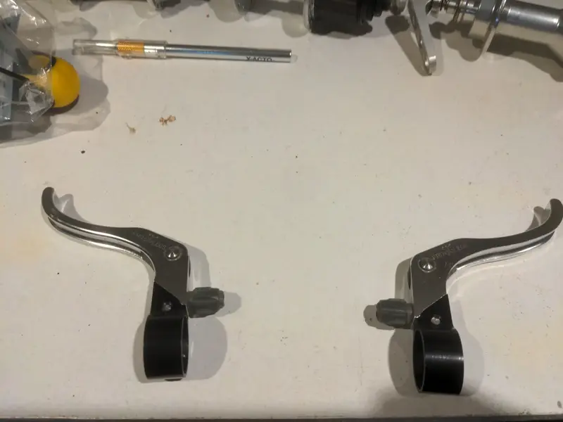

While searching for cantis I found some in-line/cross top levers that I thought would be perfect here, especially with the narrower 420mm bars, having brakes on the flats seems prudent. Old Frogglegs.
