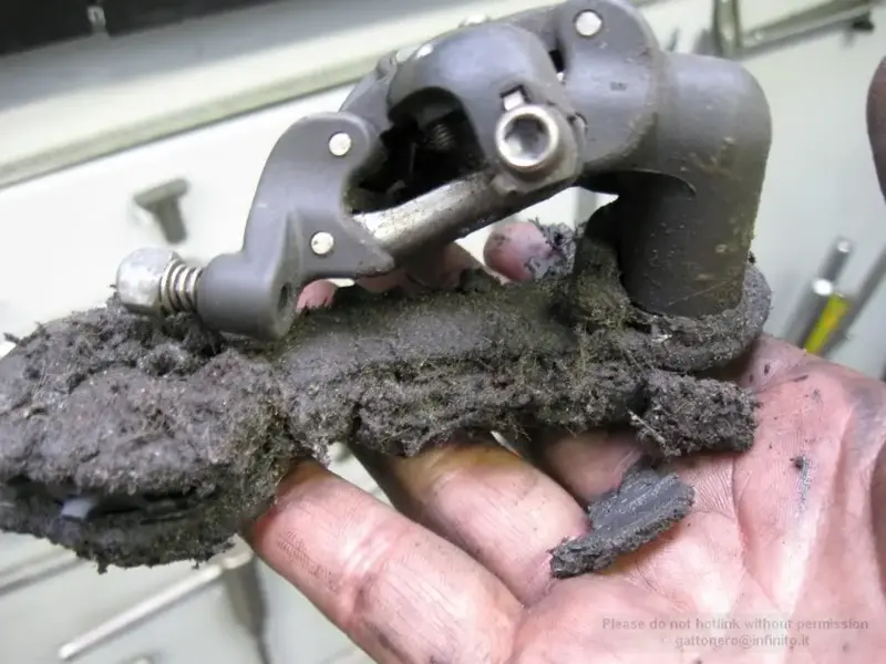

The best degreaser is the one that doesn't need to be bought: just prevent your drivetrain to become a mess in the first place.
It is very much like your bathroom: if you clean it regularly at least once a week, you won't have build-up of limescale and other dirt, so no need for very specific products.
Most people don't understand that too much oil on the chain does actually make it stiffer, hence more friction, so the bike is arguably slower.
Your really don't want a rear derailleur like this.
